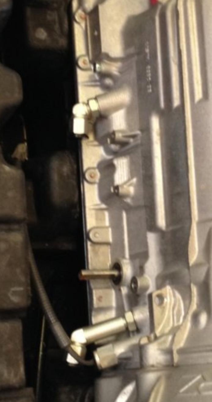

Folks, once again kick myself in the heine for not taking pics.....3 ports on the auto transmission. from YOUTUBE i discern that the 1st port nearest the bellhousing area is for the temp sensor and the other two are the cooler lines?
Is that correct? THNX!

It isn't 100% clear from the pictures I have, but that's what it looks like. The lines remaining in the truck should line up with things, so it will 'correct' you when you get there.

A quick a340f image search popped this up. Matches what is on my trans when I did my new lines.
The hottest point in the transmission is the nearest cooling line to the bell housing and the sensor like [MENTION=405460]2TH4IST[/MENTION] image shows.. There is where one would plumb in aux sensors if needed. 2nd option would be on that front line.

THNX FOLKS! I did not want to assume, and indeed Charlie the old trans lines ( which i need to have redone) do line up with the two more rearward holes,.
THNX 2TH for the pic.
