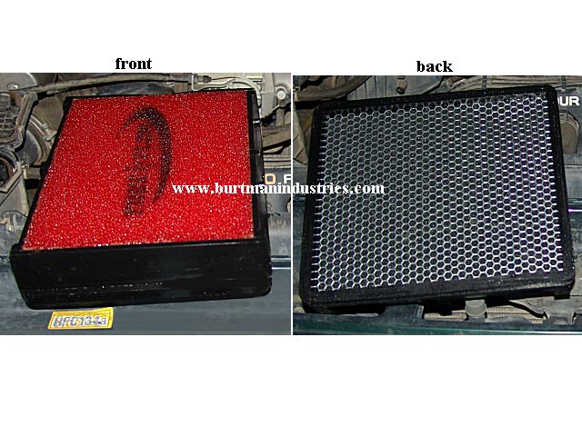

i am going to do something similar to this pictured (not a 4runner airbox lid ,but you get the idea ) inside a deckplate lid, to to keep all my my stock airbox qualities. snivilius i would wipe up as much dirt as you can by hand and try and clean up the tb.also you might want to take your intake manifold off and see how much made it inside your engine by the look of the ports. idk. its up to you how far you think you should go,but i'd imagine your engine is going to be alright. but you wouldn't want to do that very often (clogged injectors ,worn rings ,failed sensors ,ect..)But hey, at least your having fun ! (envious hahaha)check out the filter in the pic on bottom. fits in a 3rd gen that coupled with an deckplate airbox mod and some pre filter material over the opening i imagine would be a winning upgraded intake combo !

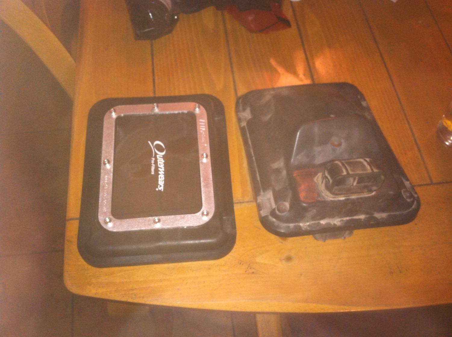

The water was probably your worst enemy .the oil on your K&N filter probably would have stopped the majority of the dirt and dust if it was dry out .but muddy water ,or dried up muddy water is probably what your looking at in the pics .sniv it looks like you push the truck hard in harsh conditions,if thats all thats left behind ,not too bad ! Look what just showed up at the door as we speak ??? my 18x18 piece of outerwear's material so i can finish my deckplate mod !!!
