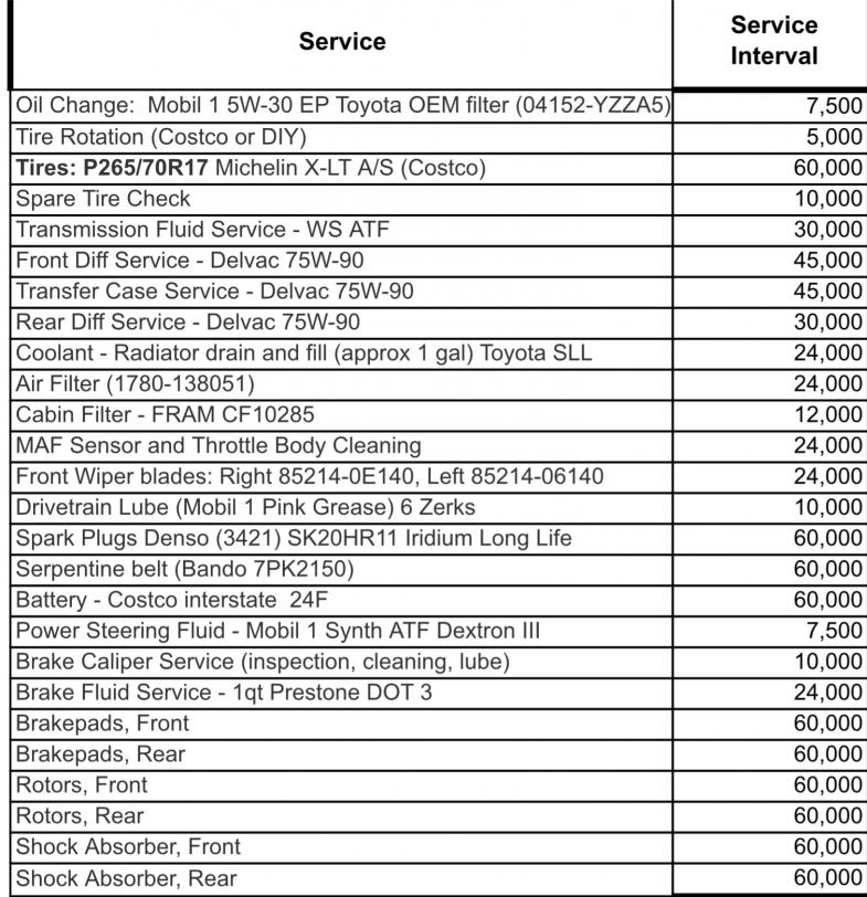

Mine is often changing but this is my current schedule or expected interval, subject to change with new data, experience, etc.
Some of these services are basic “drain and fill” so that’s why they seem much shorter than the official Toyota interval. Also I only drive about 8k a year now.
