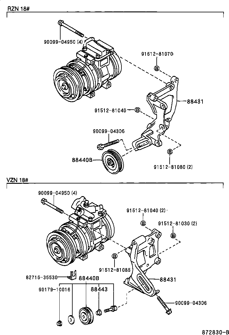

I'm not entirely sure I'll be able to get the bolt out at all. Is it possible to remove and replace the tensioner assembly without removing the compressor? Thanks guys!
Looks like you don't have to take the compressor off to change the bolt??

From the pics posted above it doesn't look like the bracket can be removed without removing the compressor. PITA but it's doable. I had to pull mine to get to the timing belt tensioner bolts. Make sure to have a 14mm ratcheting wrench and a stubby 14mm ratcheting wrench.

The bolt (90099-04306) is stuck in the head of the bolt (part of 88440B pulley asy)..
Take the nut off the front of the pulley to free it up, then the (90099-04306) bolt will have to be taken out, (heat it up) or (try to break the bolt). You would have to buy a new bolt (90099-04306) and pulley asy (88440B).

Thanks for the diagram, confirmed I just need to wait for the penetrating oil to work. I am in the process of completing exactly what Nobb said; just trying to remove the part the bearing sits on.

PS - To be clear, this is NOT the bolt that the pulley sits on, but the bolt that provides tension (see 9009-0436 part in the VZN diagram above).
Answering my own inquiry: I was able to solve this by using a different shorter bolt rather that the standard.
