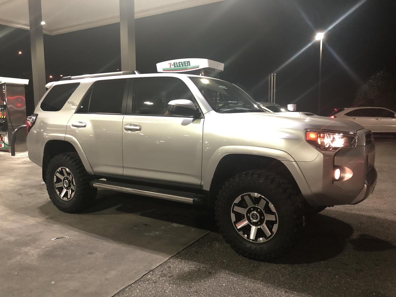

I just had installed a 3” spacer lift with longer shock absorbers in the rear, I fitted 295/70R17 Cooper STT Pro, I will do alignment today. So far no running except backing up at full lock. Detected the need of trimming lower part of bumper to get rid of it. There is no rub @ mudflaps
You will find out soon enough. I have done a ton of trimming and took my flaps off. Maybe/hope yours is different.
