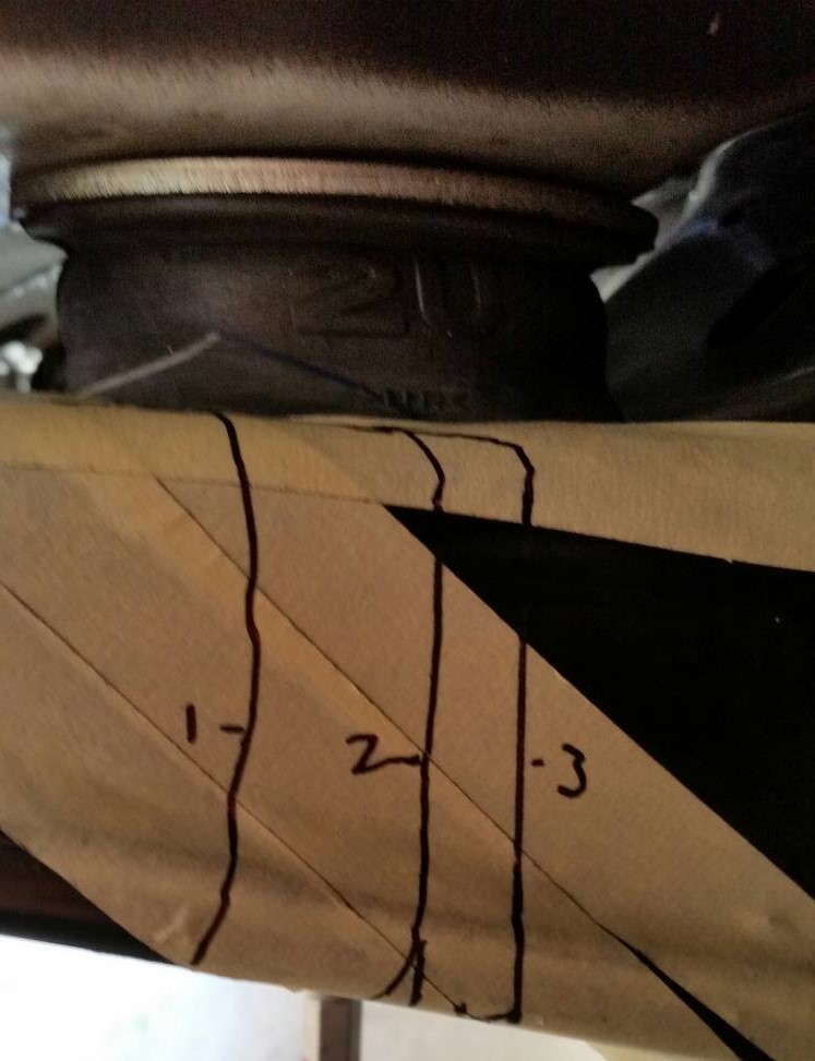

Ok guys. I'm starting to plan my intial trimming and cutting. On the bmc what how far back should I go? 1, 2 or 3? I feel more them comfortable with any of them. But I would like to maintain as much of the original as possible, but I also only want to cut it once. Any suggestions?

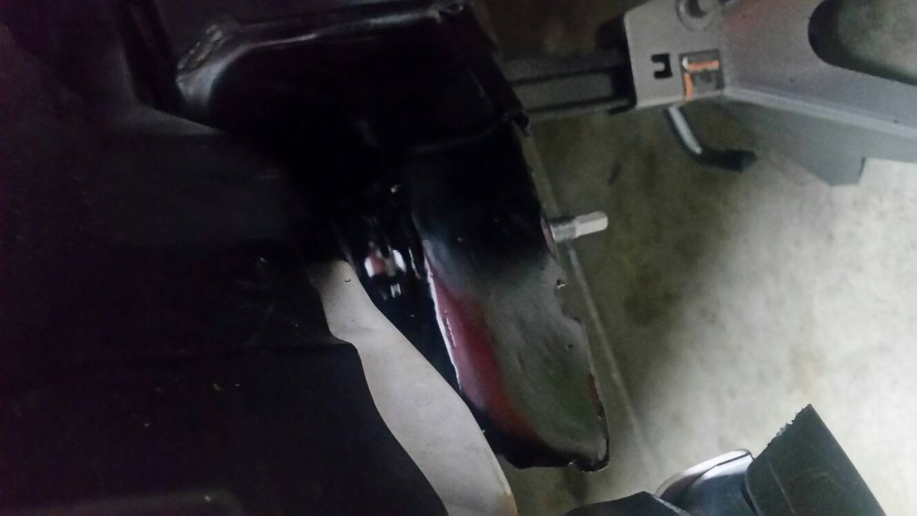

Here's my driver's side rear wheel well for reference. I would recommend cutting things back as far as they'll safely go (pretty much as pictured), and leaving it open so you can get the wash gun in there and clean things out regularly.
Looks like your cut it right around my number 1 line?
Difficult to tell from the angle of your picture.
As long as the side supports (front and rear of the body mount bracket) encompass the majority of body mount bushing(virutally all of it), it will be strong enough.
I had my BMC done by a shop that had done many in the past. I'd recommend that route, but if you're comfortable I guess give it a shot.
You will want to be around #2. Pretty much start at the center-line of the body mount (if you were looking at it from the front of the vehicle). It can then angle back in a couple of different ways to leave most of the material in place. I would never leave it open and not box it back in (but that is just me). I like things to look factory and to be as strong as possible. I took a crappy picture of mine... (sorry it is muddy at the moment).
That's what I originally wanted to do. But the 3rd line came after staring at it for 30 minutes. Thought 1 was I'm effing crazy for cutting a brand new car, thought 2 was well if you going to cut it do it right! Then I took a straight edge from the inner corner of the body mount, to where it was about 1/4" from the rubber. And that's where the line came up to 3.
I really do like the look of the rounded caps. But something tells me leave it as long as possible for some reason. Not sure if really helps in an accident, but just in case I guess.

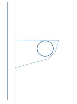

Yea, I left as much as possibe.. Mine is shaped something like this... hard to see from the picture...

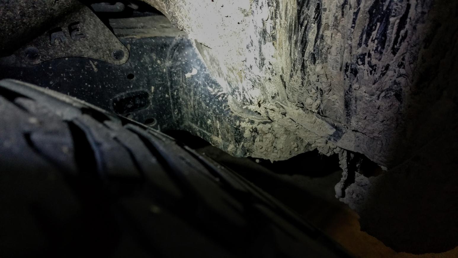

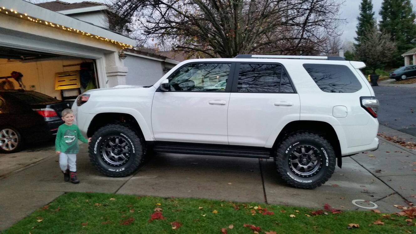

So I got the chop done, lift done and tires mounted.
Still rubbed the rear of the fenders after alignment. So I cut half of the pinch seam down there and the black rocker panel at the bottom of the fender.

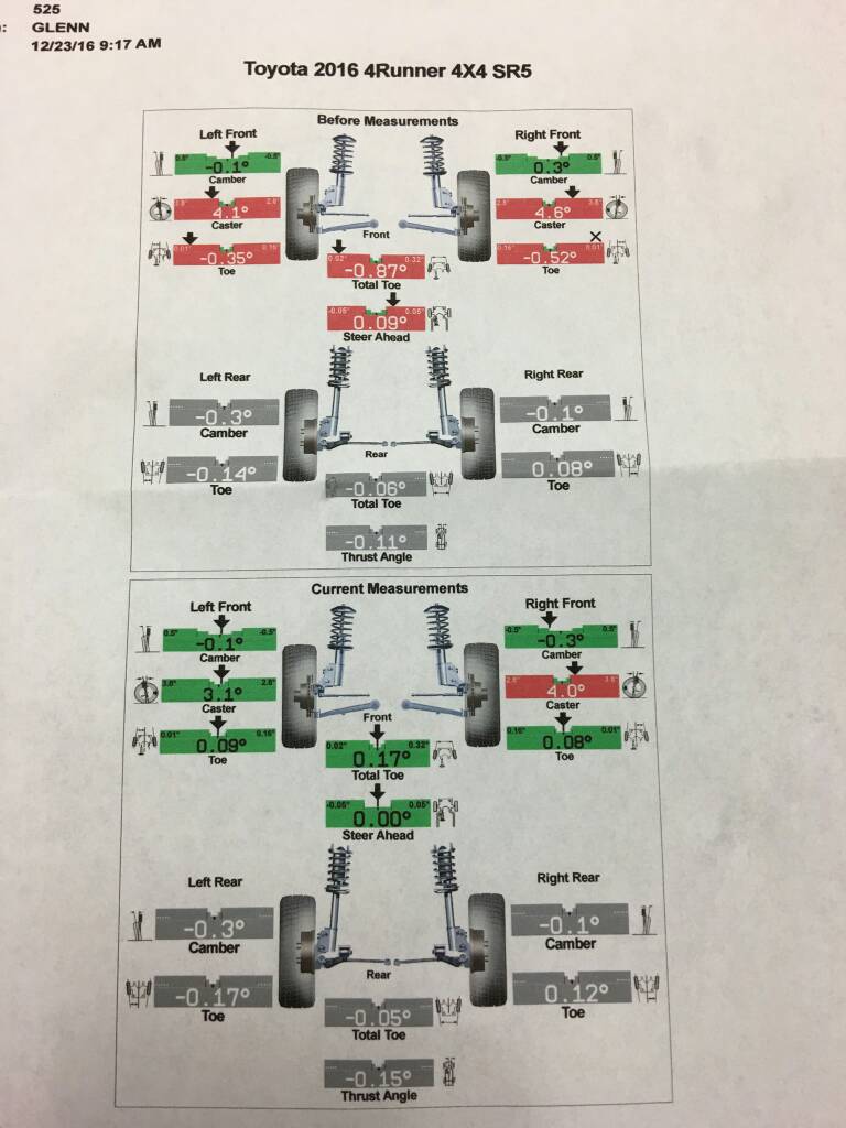

Sent my wife to do the alignment today. And these are the numbers. What do you guys think.
Driver's and Passenger's Caster measurements are quite a bit different. They should be closer than that, at least they always have been on my alignments.
This may be within the tolerance of the shop you had it done at, but I'd keep them within 0.5deg of each other.
Mind you, I've read several threads where people were seeing the better part of a degree of difference between the two sides from the factory, so...
