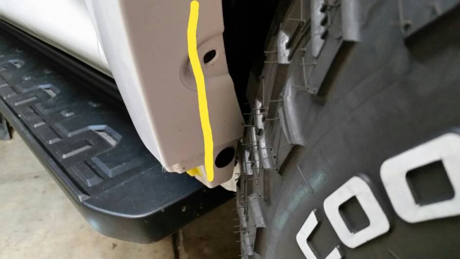

In this pic I plan to just cut along the line. Should I do more? I'm trying to save to bottom piece that blends the rock guard.

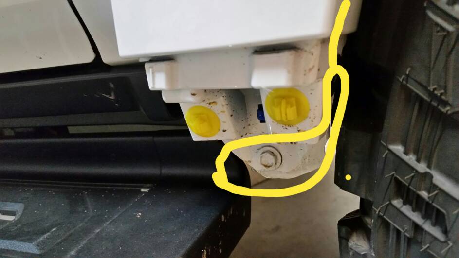

And in this pic I plan to trim along the line and BFH the pinch seam.

I ended up not having go do any of the trimming I have marked with the yellow lines.
