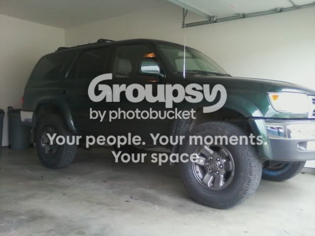

Here is mine. 265/75-16, 3.5" ToyTec Coilovers, 9.25 wrap factory LC coils.

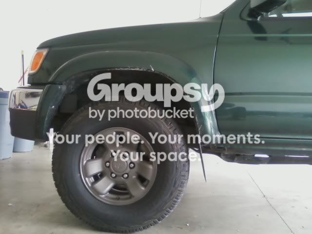

Here is a better picture of how they look up front w/o top out spacers, these are the trd tundra springs with the billsteins.
Do you have a pic of the side profile of the entire truck? Are you running the Bilstein HD (yellow), or the Tundra 5100's up front? If the 5100's, what spring perch is that set at?
Here is a side profile picture. I am running the hd yellows for because the setup came from a totalled tundra with only 18k miles on it. The ride is great.

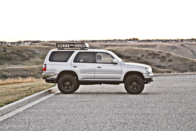

Here's mine:
265/75/16 KM2's
OME 881 front (NO top plate spacer)
OME 890 rear
20110920-IMG_0268-2 by RickaShay24, on Flickr
IMO if your gunna go with an OME setup get the 890's not the 906's. I only say that cause my 890's have sagged down a fair amount and it sits pretty level. I was originally going to get 906's but I know that if I did, the truck would for sure have a reverse rake now, after settling out. Keep in mind I do have a MTR spare tire and a 60-70lb sleeping platform in the truck at all times. No hitch.
Thanks for the tip. If I were to do it again, I would go with the 890's, but since I already have the 906's I just decided to put a 10mm trim packer on both sides. Now it has a tiny bit of forward rake instead of sitting level. My measurements from floor to fender flare are 37" up front (both sides) and 37 3/8" in the rear (both sides). That will work for now, but I just need to figure out a decent shock setup. The OME 60027's were way too stiff and I've heard the 60028's aren't that much better.
