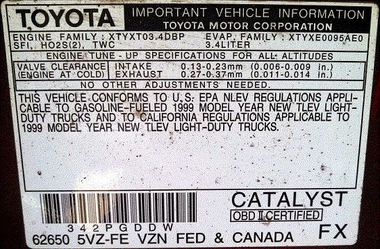

To confirm, look at emissions label--top left corner. If the letters say A/F S, TWC(2), HO2S, it's a Cali:
If it's a Federal/50-state/Non-Cali (pre-2001) it will say: HO2S(2), TWC
Don't read the paragraph in the box, they change every year and are very confusing.
