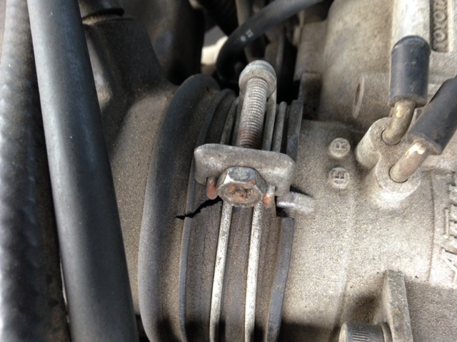

Its a 1999 4runner V6 turbo. The P0171 code, system too lean, pops up. I replaced upstream O2 sensor and MAF sensor but code keeps coming up within 10 minutes. I notice now a crack in the air intake hose (see attachment). Could this be the cause? 4runner air intake hose.JPG

That certainly could be an issue. Go to the junkyard and pull one off to see if that fixes it. Then you can buy a new one if you prefer. Are there cracks or worn parts anywhere else in the intake?
Is all of the turbo plumbing up to snuff?

Its a 1999 4runner V6 turbo. The P0171 code, system too lean, pops up. I replaced upstream O2 sensor and MAF sensor but code keeps coming up within 10 minutes. I notice now a crack in the air intake hose (see attachment). Could this be the cause?View attachment 142836
Sure that could do it!
I had the same issue and bought the Airaid intake. Seems to give a very slight boost, not worth the money for that BUT it cleans up the engine compartment and the rubber boots seem more robust than the OEM.
Check your air filter. Have you installed a K&N recently? Mine blew just enough oil to gunk an already old MAF…but you replaced yours. Something to consider.
Sounds like you know what you're doing but sometimes we forget the obvious like the air filter.

Thank you for all the responses. It's my daughters car who lives 5 plus hours away. She was here over Xmas when I saw the code. Like an idiot I did not look under the hood to install the MAF sensor until the day prior to her departure. I'm going to order the part and find someone to install it down there. The car runs excellent however. I'll report the results. I do not have a K&N filter but I'll get a new filter as well.
