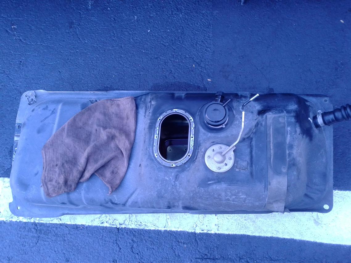

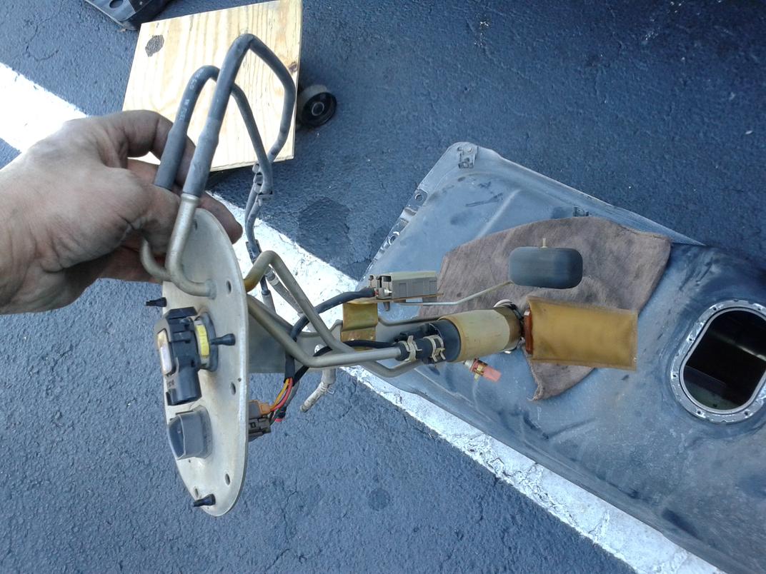

check the carbon tracking on the sending unit as well. remove the cover where the float is and you can see the carbon track.

16 year old truck. you should replace cap anyway. guaranteed it's the valve. do you smell fuel through the wheel well? i dropped mine by myself. i did it when the fuel light came on. when i drained some fuel, it was about 2-3 gallons. i replaced the check valve and grommet, fuel pump gasket and filler neck hose. i forgot about the cutoff valve gasket. might as well do all of it while it's off. come on out to brandon and give me a few bucks and i'll help you with it.
