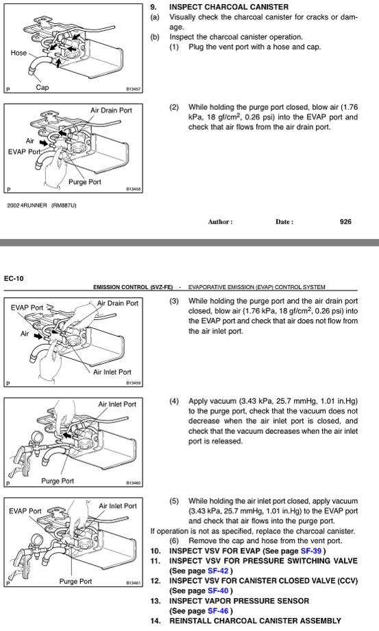

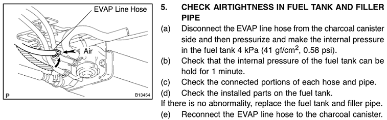

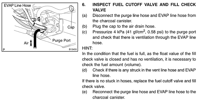

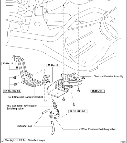

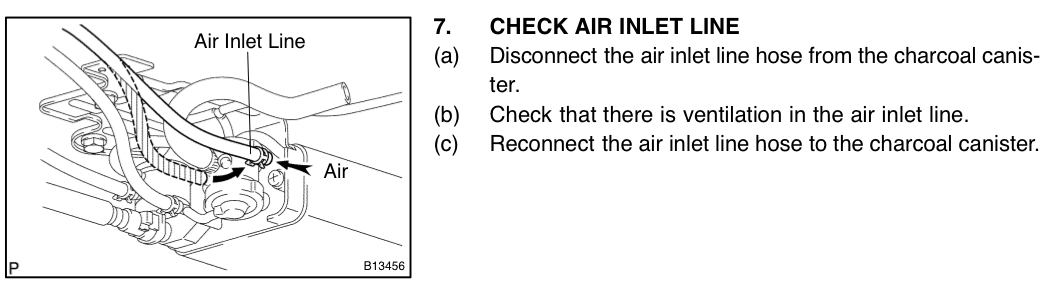

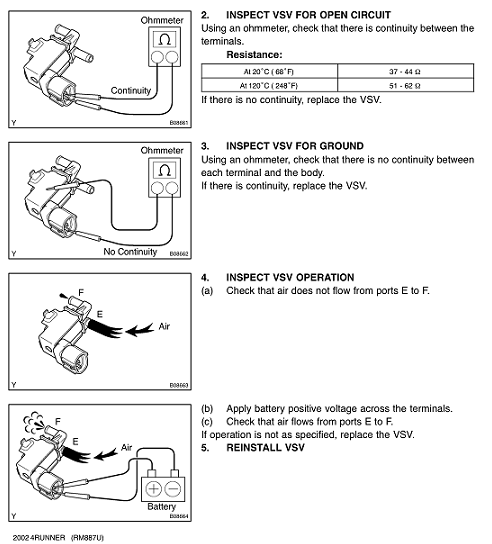

Added some pages from the FSM that I followed for troubleshooting my charcoal canister and fuel tank for evap leaks.
Charcoal canister and VSV for pressure switching valve location for 01-02 4runners)

I used a 9v battery and a multimeter to test the VSV for pressure switching valve
How to pressure & vacuum test charcoal canister. You can use a hand held brake bleeder with pump & vacuum option or air from lungs.
Overfill Check valve testing
Fuel tank & filler neck testing for airtightness
Check for proper ventilation on air inlet line on charcoal canister
