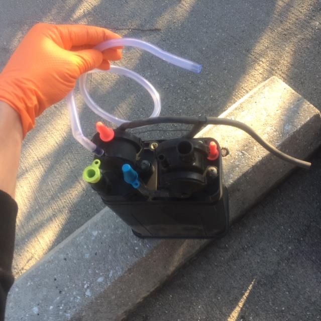

1. My charcoal canister & VSV for pressure switching valve (attached to the canister) passed the fsm pressure and vacuum tests. The charcoal canister is located above the spare tire for 2001-2002 4runners and for 96-00 it is under the hood along the driver side fender.
Tools used for testing:
1. A couple feet of 1/4" hose
2. various sizes of vacuum plugs
3. mityvac brake bleeder (has pressure & vacuum option)
4. air from my lungs
5. 9v battery
6. multimeter

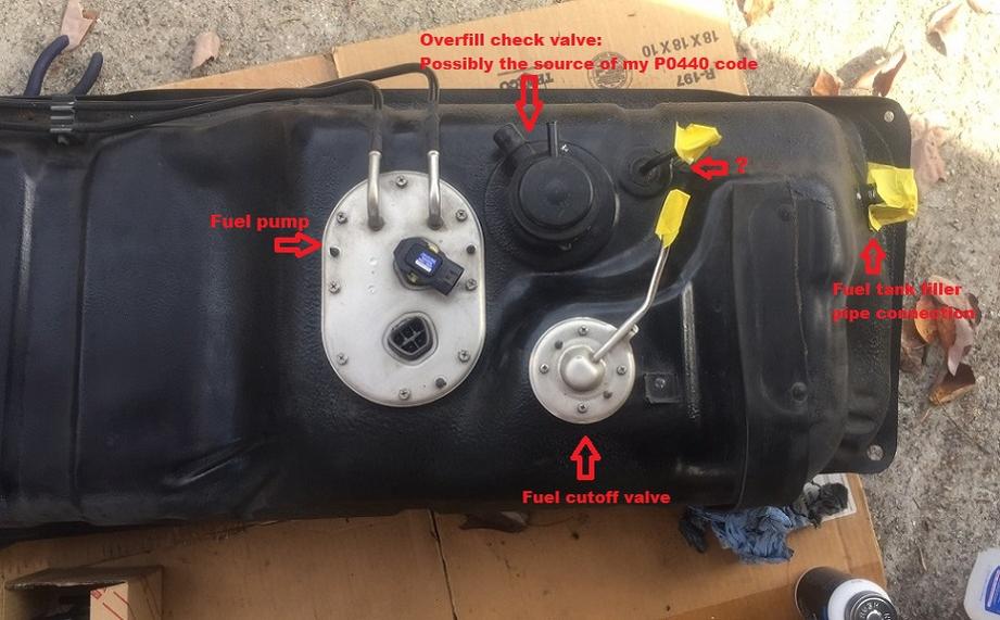

2. I tested my gas tank components next due to the occasional mild gas smell. Since I was having issues with my air compressor I ended up just blowing into the various ports the fsm suggested using a 1/4" tube. I could hear air escaping from overfill check valve on top of my gas tank (only 2001-2002 4runners have the overfill check valve on top of the tank). Since I was going to have to drop my tank to replace the overfill check valve, I figured I'd replace all the other gas tank components including the fuel pump. I replaced the parts Thanksgiving weekend. After replacing the parts, I didn't clear the cel to see if it would turn off on its own. About 350mi later, the cel was still on so I manually cleared it. The cel was off & no pending codes but my scan tool said it was "not ready". A total of 950mi after replacing my overfill check valve, my scan tool indicated that my evap system was "ready" & no pending codes. Passed my emissions test last week! Thanks to the write ups, dropping the gas tank was much easier than I thought. I did get blasted in the chest with gasoline removing one of the fuel lines because I didn't depressurize the fuel system enough. That sucked.
Toyota part numbers for gas tank components:
*Overfill check valve: 77390-35010
*Overfill check valve gasket: 77177-33010
Fuel pump gasket: 77169-60010
Fuel pump: 23221-46010

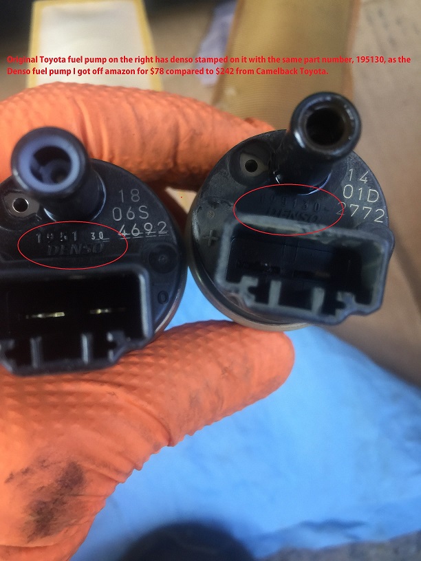

Rubber cushion for fuel pump: 23249-74610
or
Denso 950-0100 (950-0100 is the product number on the package but 195130 is what's actually stamped on the denso fuel pump)
Fuel cutoff valve: 77380-26010
Fuel cutoff valve gasket: 77179-26010
*The overfill check valve only applies to 2001-2002 4runners

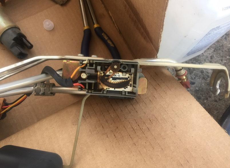

Picture of the dirty fuel pump sender contacts before using a pencil eraser, as suggested in a couple write ups, to clean it up.

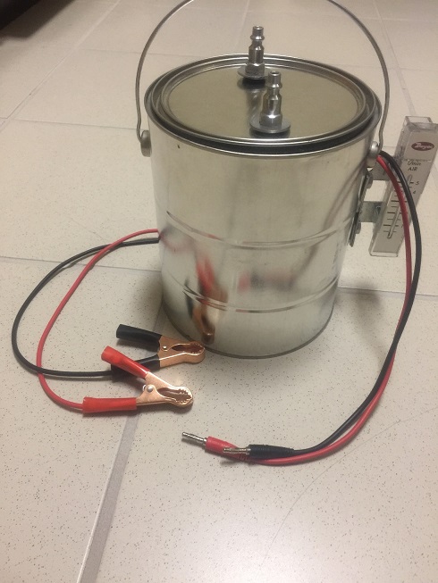

Picture of my homemade smoke machine. There are DIY vids on youtube for anyone interested in making a smoke machine. The smoke machine itself worked fine but when I had it running through my evap system, I never saw any smoke...possibly because I was outside making it harder to see the smoke escape from a very small leak on top of my gas tank.

I used a few different youtube videos as a resource when I made my smoke machine. I initially started very basic using a paint can & incense which worked fine but then made things a little more "high tech" for convenience.
vid 1
vid 2
vid 3
vid 4 If you want to use a flowmeter for leak testing
Very general parts list:
1 gallon paint can
assortment of 1/4 air compressor accessories from harbor freight: couplers, quick connect fittings, etc
1/4" Coupler x 1/8" NPT Male Thread (2) if using the dwyer flowmeter
dwyer flowmeter
3/8 clear tubing ~10'
24 gauge resistance wire that I got from a local vapor/tobacco shop
2 insulator binding posts
mineral oil (to increase smoke production)
propane gas regulator 0-10psi
oil lamp wicks
insulated alligator clips
Air source: having an air compressor is a nice luxury but I was able to make a bicycle tire pump work in a pinch when I had air compressor issues.

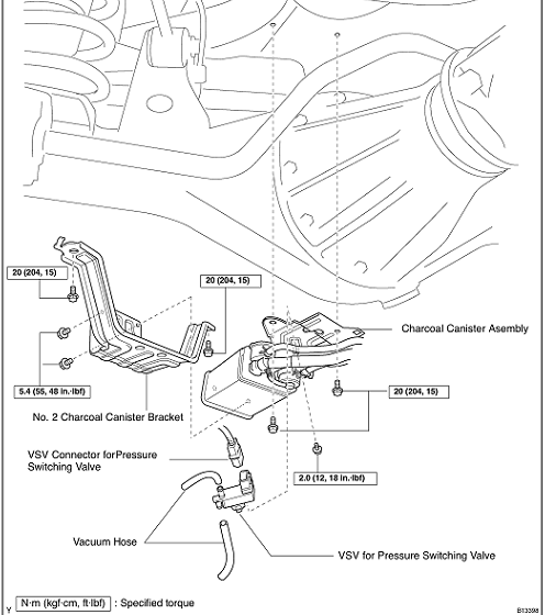

Charcoal canister and VSV for pressure switching valve location for 01-02 4runners)

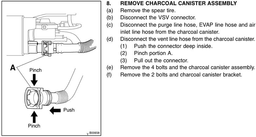

Disconnecting vent line hose from canister (fitting can be difficult to remove)

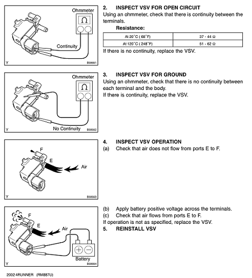

I used a 9v battery and a multimeter to test the VSV for pressure switching valve

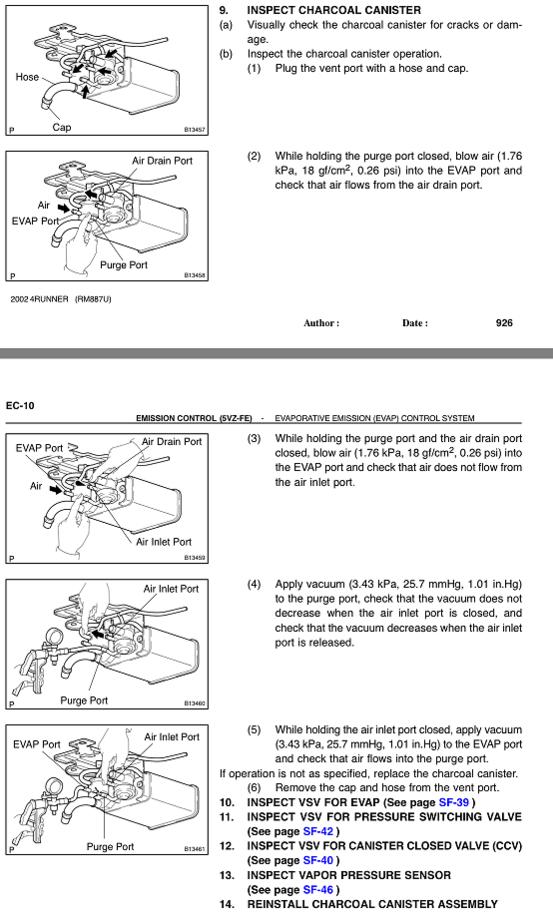

How to pressure & vacuum test charcoal canister. You can use a hand held brake bleeder with pump & vacuum option or air from lungs.

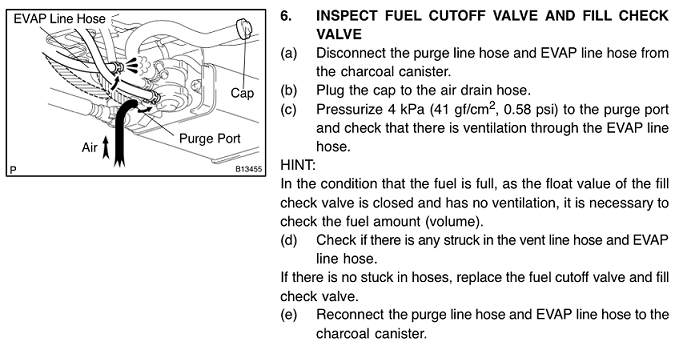

Overfill Check valve testing

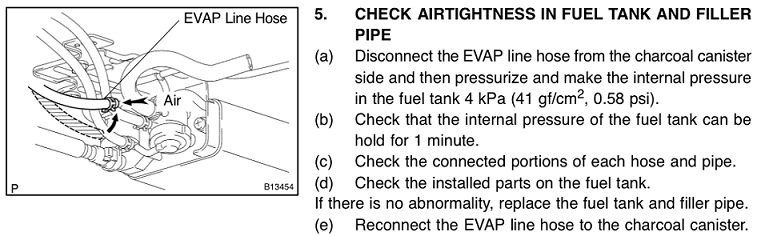

Fuel tank & filler neck testing for airtightness

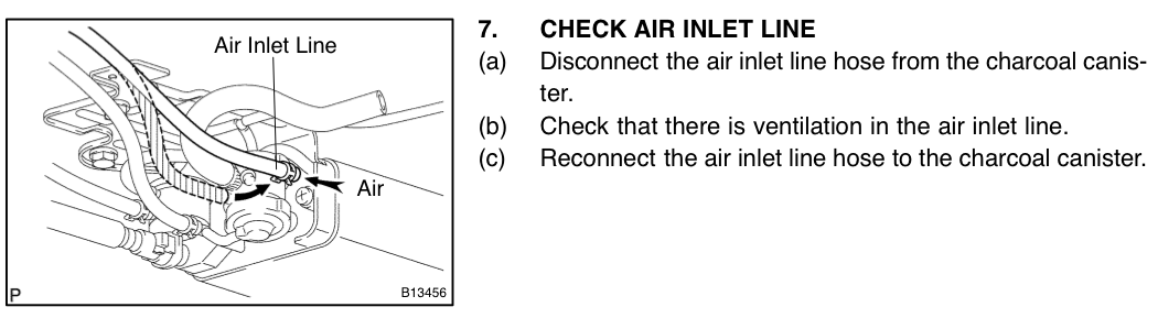

Check for proper ventilation on air inlet line on charcoal canister

If I remember correctly, when you pinch the hose, the tabs on the hose SHOULD expand away from the fitting allowing you to wiggle the hose free. You can use a small 90 degree pick (few bucks from HF or amazon) and work it around the house to help loosen it up &/or use some pliers to GENTLY apply a little more 'squeeze' to the hose.
Thanks for the clarification. I ended up pushing on the END of the tabs which allowed them to fold outwards making it easier to pull off. You do NOT want to break these- replacing the whole thing looks like a pain. Thanks again.
