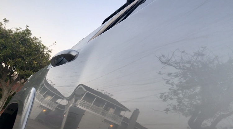

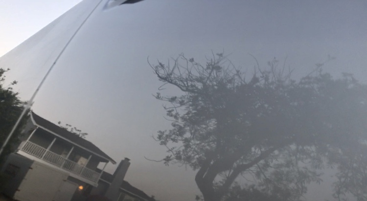

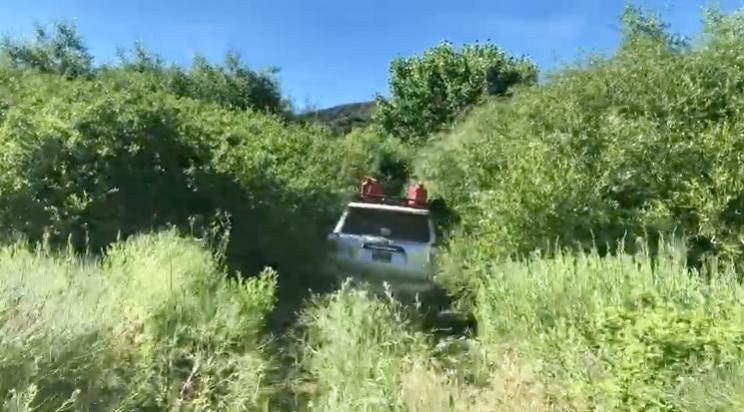

After a very legit backcountry adventure in Santa Barbara, I was left with paint that was pretty much trashed due to overgrown brush.
Been working a panel a day using the following in order after wash and clay:
Lake Country Purple Foamed Wool Pad + M105
Lake Country Black Finishing Pad + M205
Lake Country Red Ultra Fine Finishing Pad + Collinite 845
Using PC DA Polisher
Results are professional quality. I’ll add some more photos once I finish. Feels great to use it how it was made to be used and be able to clean it up afterwards.
