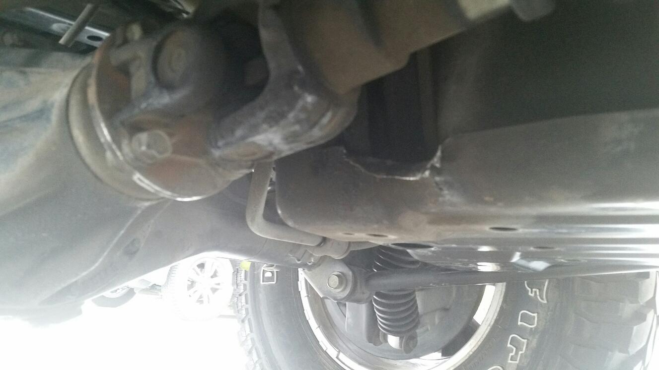

On topic. So I finally got around to hanging my new longer sway bar end links this afternoon. Check out what I discovered at the rear inside corner directly next to the universal joint...
Yup that is torn pealed back metal..... What is strange is I could not find any trauma on the universal joint or the driveshaft. Any thoughts from the experts...?

That is bizarre. The driveshaft shouldn't come close to hitting the skid for the gas tank unless the rear end has got abnormal movement side to side which I imagine you would feel big time. My educated guess is a piece of road debris kicked up into the driveshaft and then the driveshaft smashed it into the gas tank skid.

Pretty normal when you flex it off road with longer then stock shocks . Grind it off or beat it flat or it will continue to hit worse and worse . Bet you your grease zert is gone !
This is completely normal running more that 3.5" rear coils. The rear will flex the driveshaft into the gas tank. It's more prominent when not running rear sway bar. If you don't cap the rear driveshaft zerk it will sheer off. Notching the gas tank skid works pretty well.
I never knew the rear end could move that much side to side. It can obviously articulate up and down and the amount is dependent on your suspension choice and whether the rear sway bar was connected but that much side to side movement is a surprise to me.
Recently, I was helping [MENTION=102606]infamousRNR[/MENTION] pull his rear slip yoke to lubricate it better to get rid of the slip yoke binding clunk he was experiencing and I noticed his zerk fitting was broken off. I figured he dragged the driveshaft across some rocks but now I'm thinking he might have just flexed his rear end enough for the driveshaft to come in contact with the fuel tank skid.
