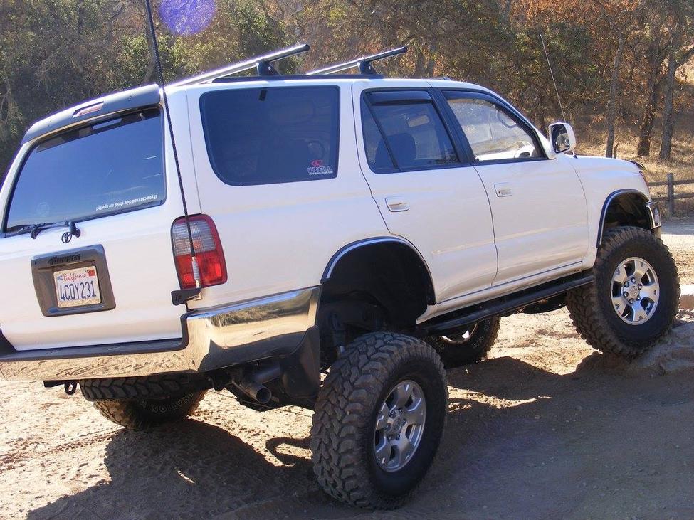

Flex and stuff

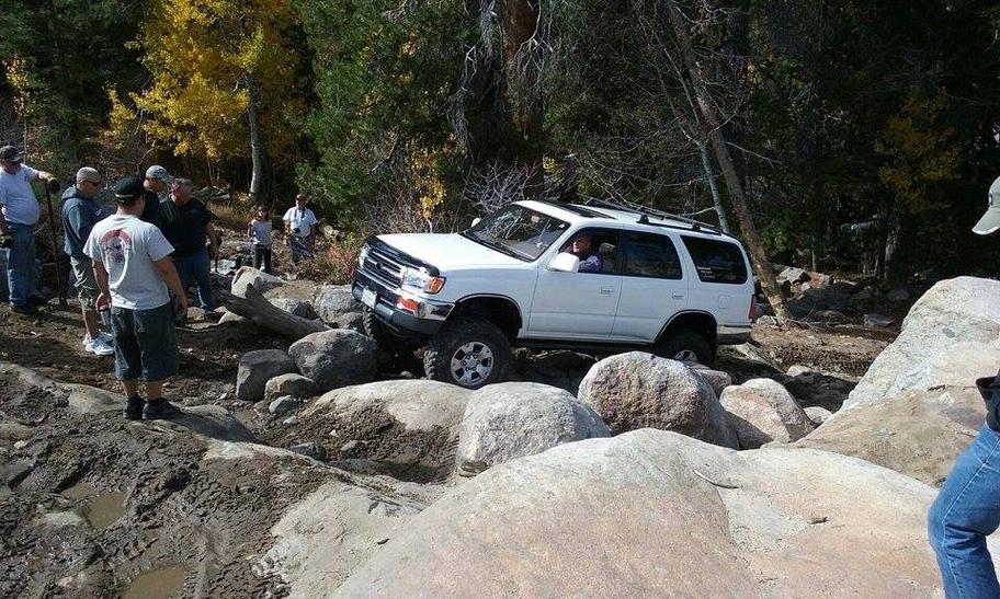

+1 my inside coil Stops stayed in. I seem to get great flex (see pic). And my Jeep friends are impressed, unless they just feel sorry for me lol... Yes sway bar was connected I've never run with it off. I do remember hearing something narly loud at Slick Rock last time. Trail maintance (a Stockton wheeling club) was there to move boulders and clean things up on "The Ladder" bcs the section had gotten 'too ugly for passing'. But I was the last guy (and only Toyota that day :) ) to go up (see pic) before they closed it and began their work. It wasn't a cake walk and my Snowden pulled for sure but I do recall hearing something. Could have been it.
(Flexing at Hollister Hills)
The Ladder at Slick Rock
