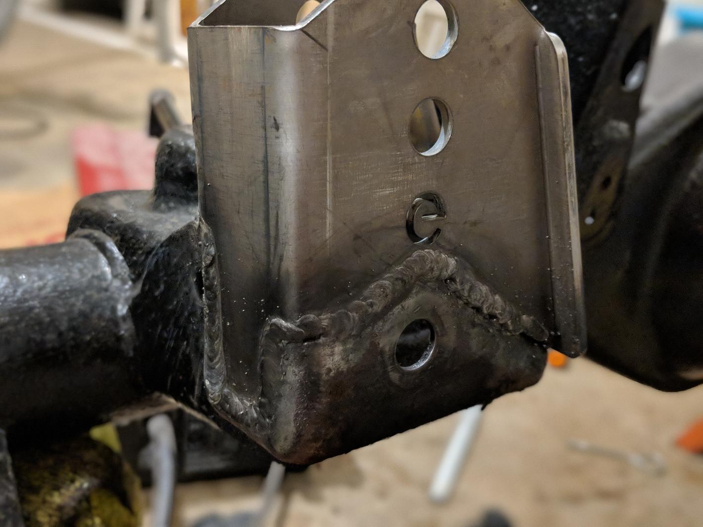

Started out beautiful ended up ugly haha. Not the prettiest welds, but they will work!
looks better than the welds on mine.
did you remove your axle to weld this thing on? I had the retired welder down the road do it under the shade tree.
I've had an ongoing project in the garage. I welded it onto an FJ elocker rear that will hopefully be going in this fall!
I got quoted like 250 to do this. Does that soound right?
It totally depends on who you have do it. I paid $40 and a case of beer plus a ride in the truck exploring some trails. That's probably the difference between old retired guy doing it in his front yard vs. a still working guy doing it in the shop.
250 seems pretty steep for 12 linear inches of weld.
If he's a decent welder I would have guessed $50-$80 an hour so it's a little steep considering it's just 1 bracket with minimal prep work and consumables. Should take him 1 hour or less if he's good.
