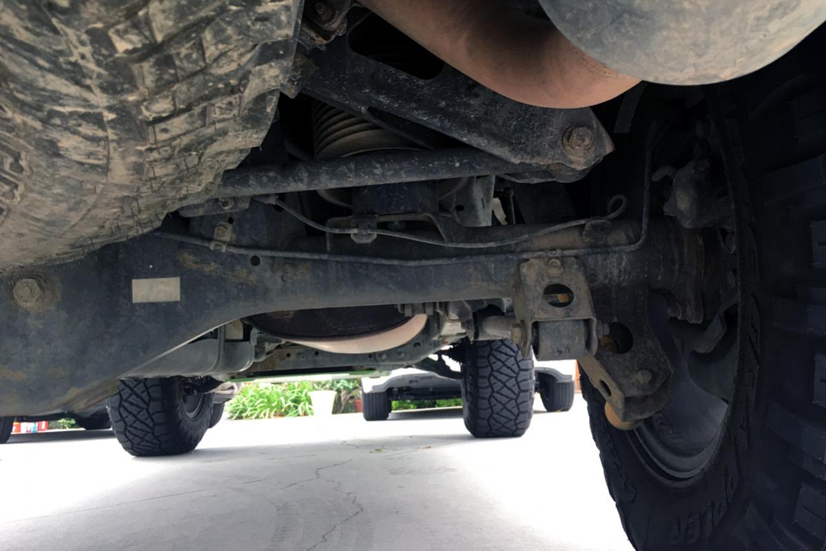

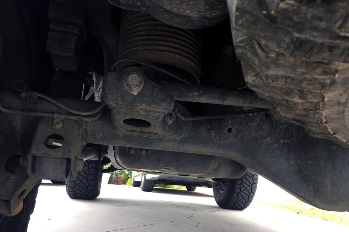

Yeah, I'm still running the sway bars in front and rear, so this might explain why I don't notice any issues with steering. Here's a picture of my rear panhard.
