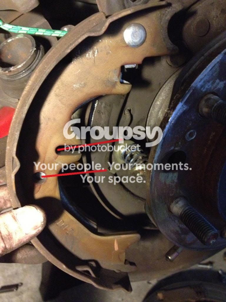

I joined this forum just to weigh in on this. I just purchased an '05 4wd sport which conveniently didn't have a working parking brake. Me thinking it can't be that bad to fix proceeded with the purchase. I replaced all the brakes but struggled with the parking brakes. So last night I was in here googling how to do it when I came across this thread. Very useful information with assembling he latch spring and cup on the pin prior to rotating the shoe into position.
Where I think I can help future users, while I was at O'Reillys I searched for anything that looked useful in this project and I hit pay dirt in the form of a tool for removing panels and trim. It is a screwdriver looking dude that has a bend just before the head. What would be a flat head has a cut splitting the head into two. It is red in the handle and silver on the shank and made this such a simple job.
I had to get everything in position and just before rotating the shoe up, I slid the tool across the top of the axle and pried the spring up. Pushing the shoe into position pushed into the loaded tool and it popped right into position. For the other side I worked the same way only sliding the tool in between the plate and the previously mentioned assembled shoe. Once I had to take a flat head and pry the spring off the tool. I suggest anyone in the future buying this $10 savior.

I also, have been victim of the infamous 4Runner parking brake repair. Recently replaced the rear discs and pads on my '05 4Runner, and in doing so - damaged the parking break hardware on the disassembly.
Read some good tips on here, regarding compressing the springs using string. Didn't have any string, so I used very small zip ties (2) each - worked well.
