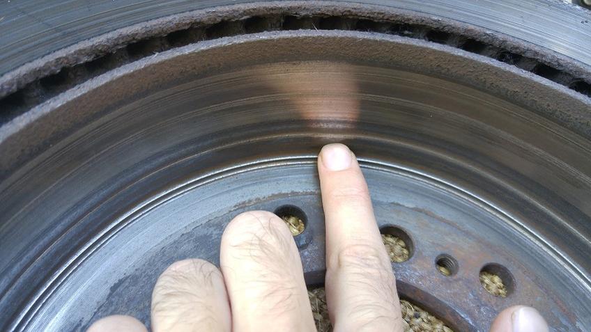

this is the condition of the inside drums.

did you put the car back together knowing it was dragging a little bit? Or did you adjust it until you heard nothing?

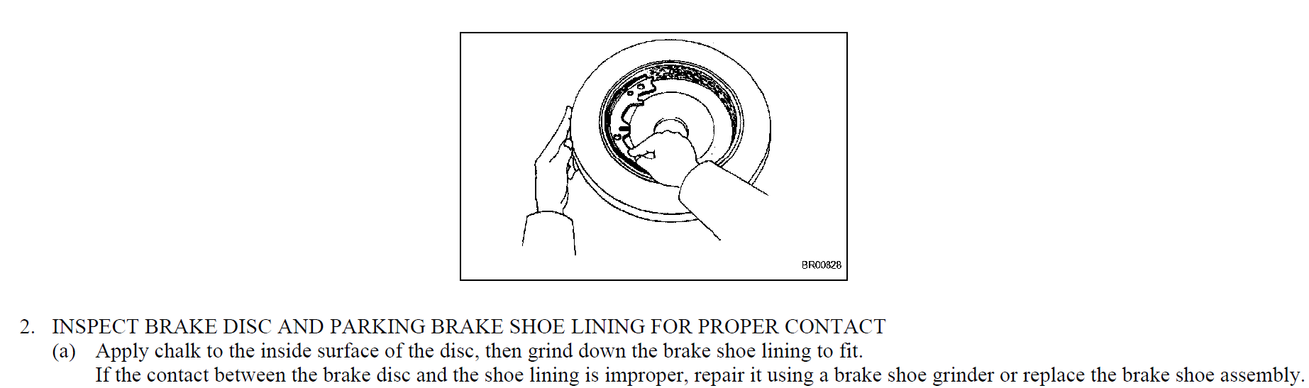

I believe the service manual says to use chalk to determine where it is touching and sand down those high spots?
edit instructions from manual attached as picture.
