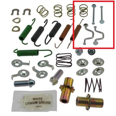

which exactly is the shoe pin? Shall i get the autozone kit or just get this part from toyota and keep the rest.
thanks!
The shoe pin is the 2" straight nail looking part. It goes in from the backside of the backing plate. Aftermarket will be just fine. You can get a complete kit for like 10.00 bucks.
these guys? (Attached)

Oh yes. Totally forgot about the funky shaped *****!

Do you mean the retaining pin that has kind of a U shape? The bent out side is supposed to face in towards the hub. The angled bend gets hugged by the slot in the shoe (see drawing below)

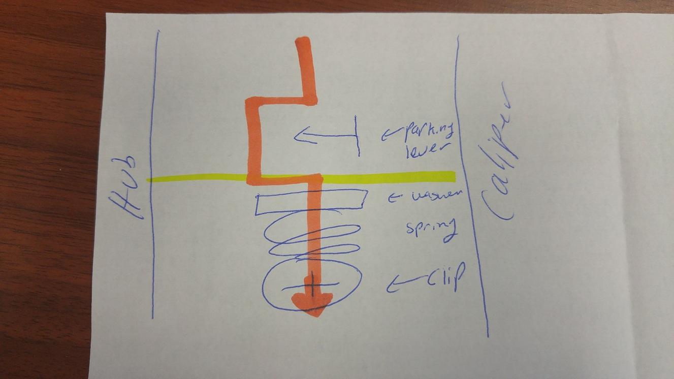

Yes that! I dont see why it would it would be that way. Why would a U even need to be used? is it meant so the parking lever has clearance to move? Please see the attached drawing of what i mean, Sorry for poor drawing.
I got it assemblyed again, but when i apply the parking brake it does not come out uniformly on both sides. as in it doesn't do this video

It's shaped like that so it can straddle the lever which actuates the shoes. If it was straight like the other pin it would interfere with it.
It might not spread out uniformly with the rotor off because there is nothing holding it centered so it can just shift to one side. Obviously when you have the rotor back on it will be forced to stay centered so this isn't a problem.
