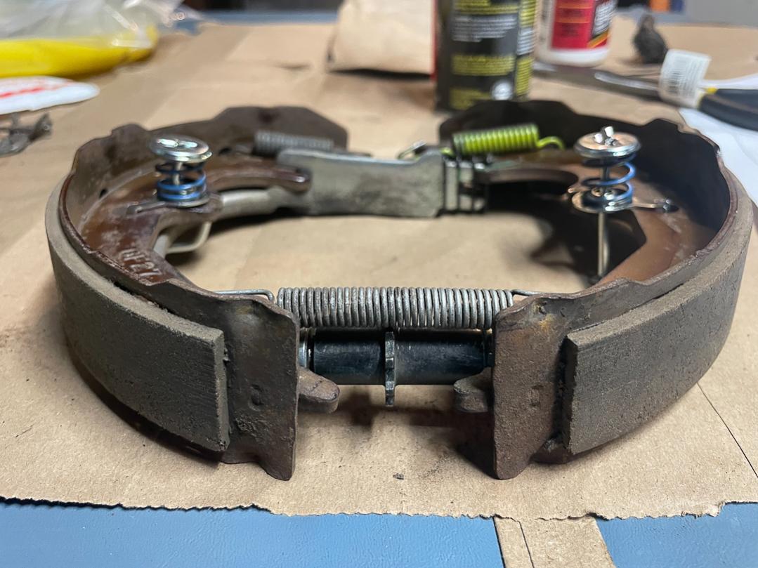

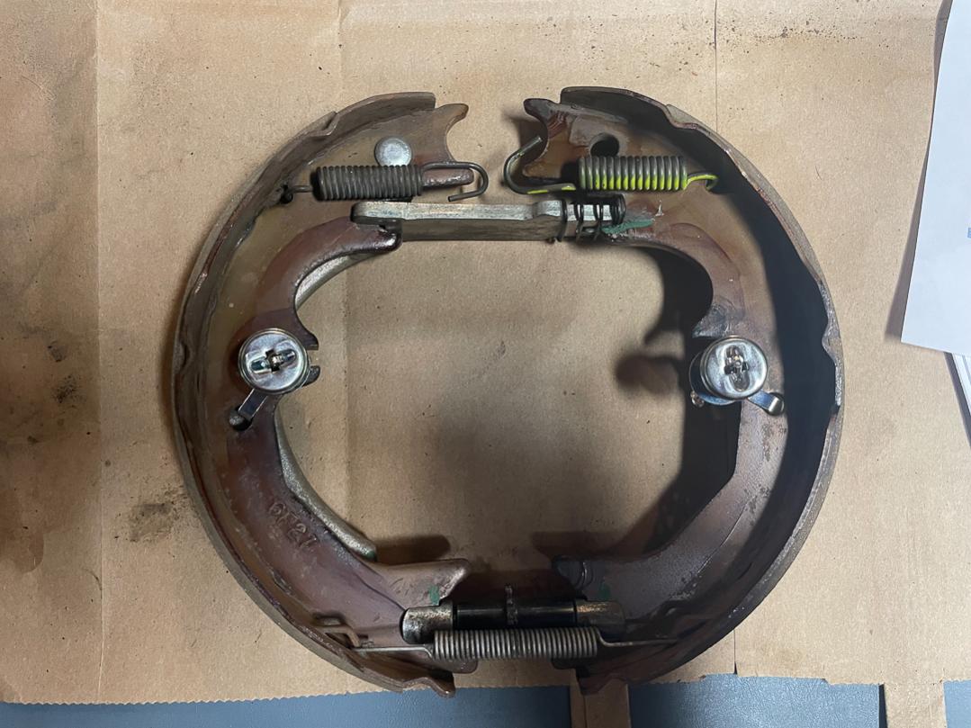

Today I finally got around to putting my emergency brake back on. I knew getting the hold down springs together was going to be difficult but really everything about installing the emergency brake seems to need three hands. I took a couple pics of things that helped me, mainly using a ratchet strap and jack stands to hold things in place and jamming a pencil eraser behind the straight pin to hold it in place. The straight pin was difficult since this was on my passenger side and I'm right handed. U pin was a little easier to hold with my left hand while working the hold down cup with my right hand.
I was kind of dreading this job and planned for a long time to get it done but managed to get it all together in about 2h45 (working in the street in front of my house :rolleyes:). FWIW I didn't tie the cups and springs together at all. I just used needle nose pliers through the hole in the rotor and once the pin was through the hole in the cup I used a pry tool to hold it down and got lucky rotating the pin into place.
Pics:
1 & 2: putting everything together before installing to visualize how it works

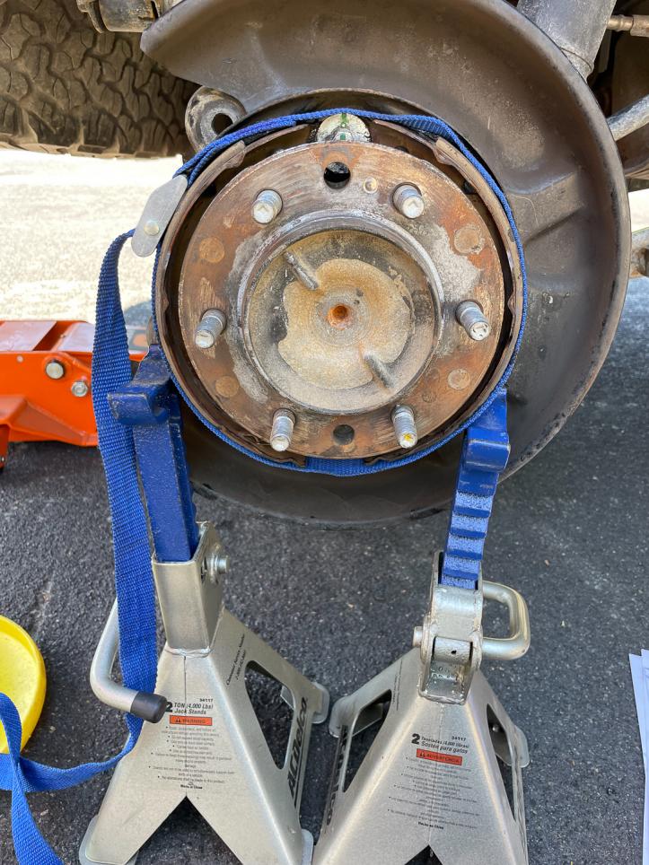

3: Ratchets strap and jackstands to hold the shoe assemblies in place while dealing with the hold down springs

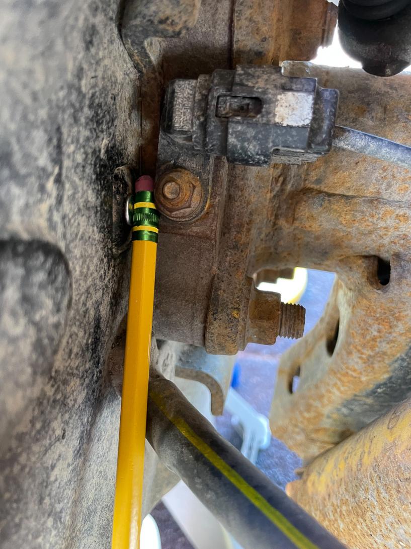

4: Using a pencil eraser to hold the hold down spring in place.

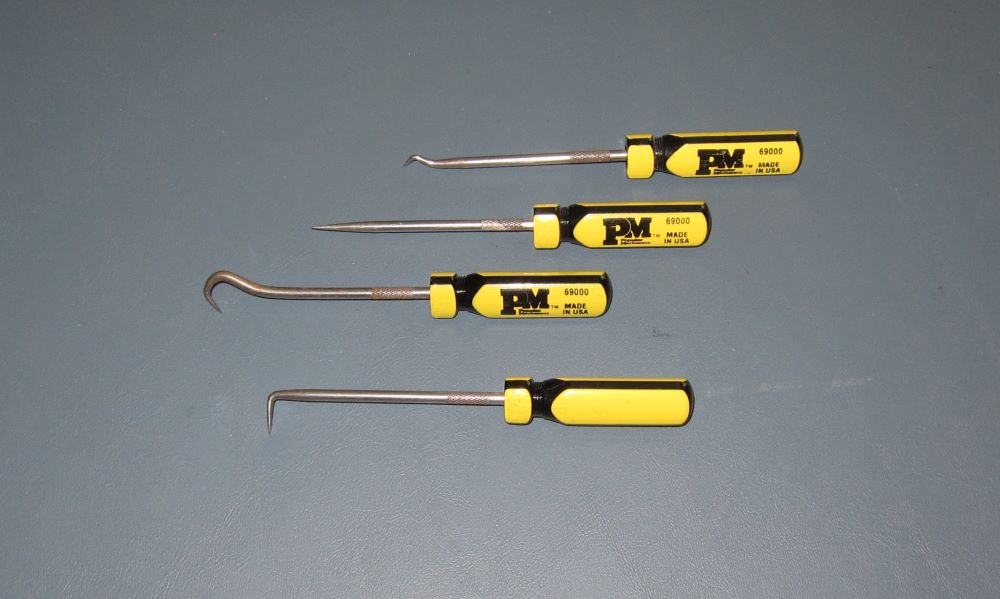

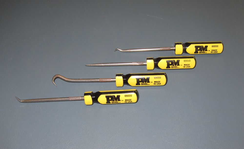

Here is the tool that I used. It came with the three other picks in a kit. I've had them for so long I don't remember where I got them. I've used them all at one point.
Here is something similar : Precision Hook and Pick Set for Automotive | 4-Piece Hand Tools - - Amazon.com
