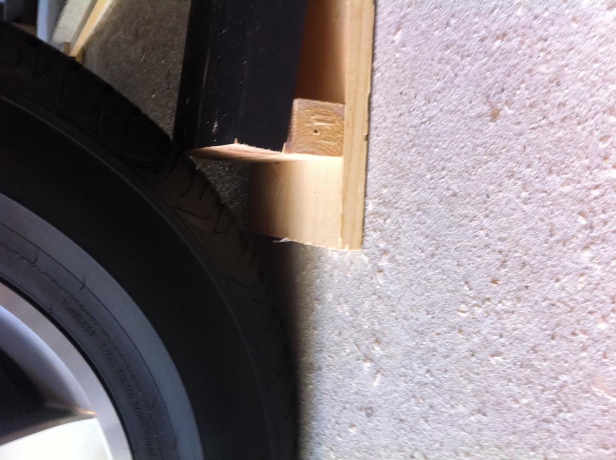

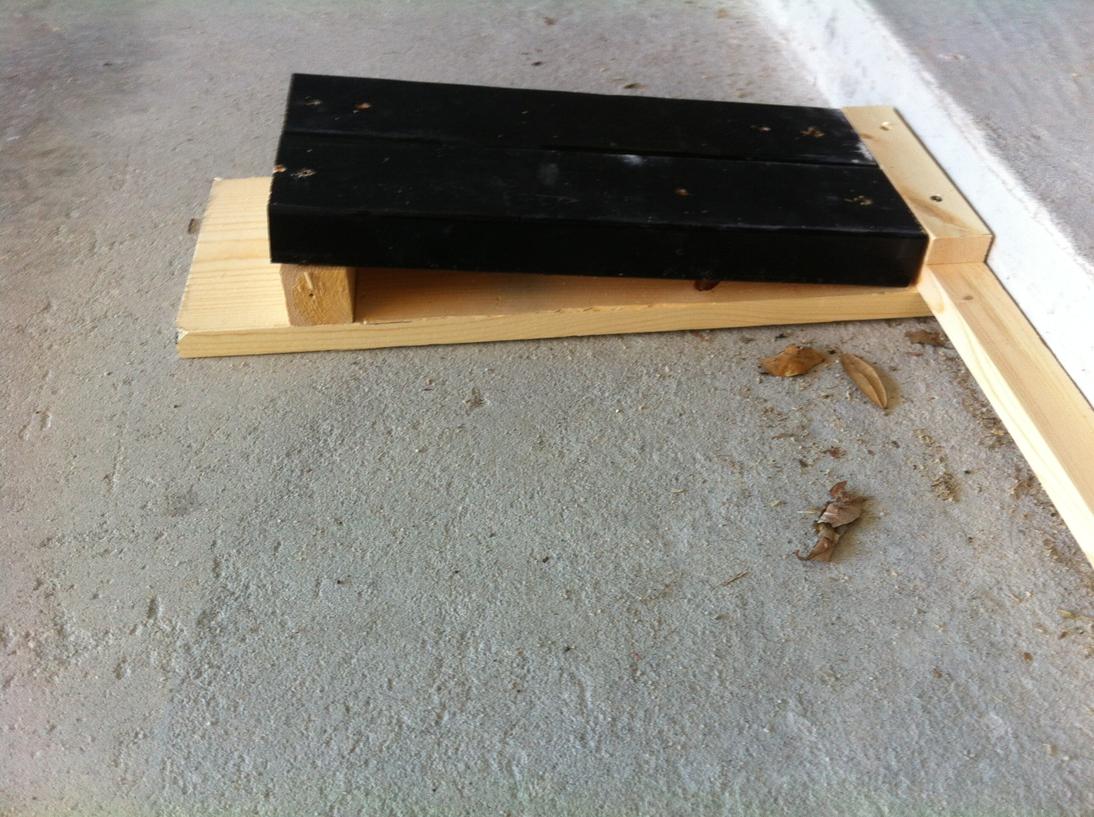

So, a slow day at work and I decided to use some extra materials I had around in the garage, and this is what I came up with. It's not perfect and I'm open to suggestions. For now, it gets the job done. Basically I pull in slowly, it stops me from creeping up, place it in park and the vehicle settles back a bit so the pressure is off the tires, and it's a perfect fit.

It's wasn't over-complication per se - more of a trial and error.
I started with just the 1 x 8s you see as the base. The problem is they shift or can get moved when I do other stuff in the garage. So I decided to add a cross brace that would keep them at the width of the tires no matter if the shifted or I had to move them for some reason.
I did that a few times but noticed the .75 isn't thick enough to feel when driving over them with the stock tires and suspension. So I added the 2x2s.
Then I noticed that when my engine was idling higher on it's own (no acceleration on my part), the T4R would lurch a bit faster and would overcome the thickness of the 2x2 and board on it's own. Remember I only have a couple of inches for error before I whack something.So I added the 2x4s on top and that was enough to feel the stopping point, even with the engine idling a bit high.
Yeah, I know, not my prettiest woodworking project. :D
