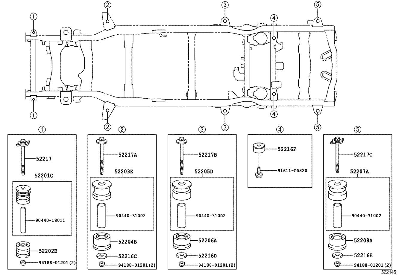

I can't help you much, but what I can tell you, is that it is part number 17 in this photo.

Looks like a body mount cushion. Basically it's one of the mounts that connects the body to the frame. If that fell off you have problems...

Is 17 in the rear of the 4runner or the front? I assume rear?

It's the rear crossmember. Take it to the dealer. Those should never fall off. It's a safety issue and the dealer should cover the repair for free IMO.

It may have been a spare/stray left over from the assembly line that finally fell out of a nook or cranny on the frame but I highly doubt that with your mileage. If that came out then the bolt holding it came out. I would definitely get it looked at if you can't crawl under and check for yourself.
You don't need a stealership. Get an indy shop/mechanic to take a look. Take the diagram above with you. You have the part, you just potentially need a bolt. I would also get the other location checked.
