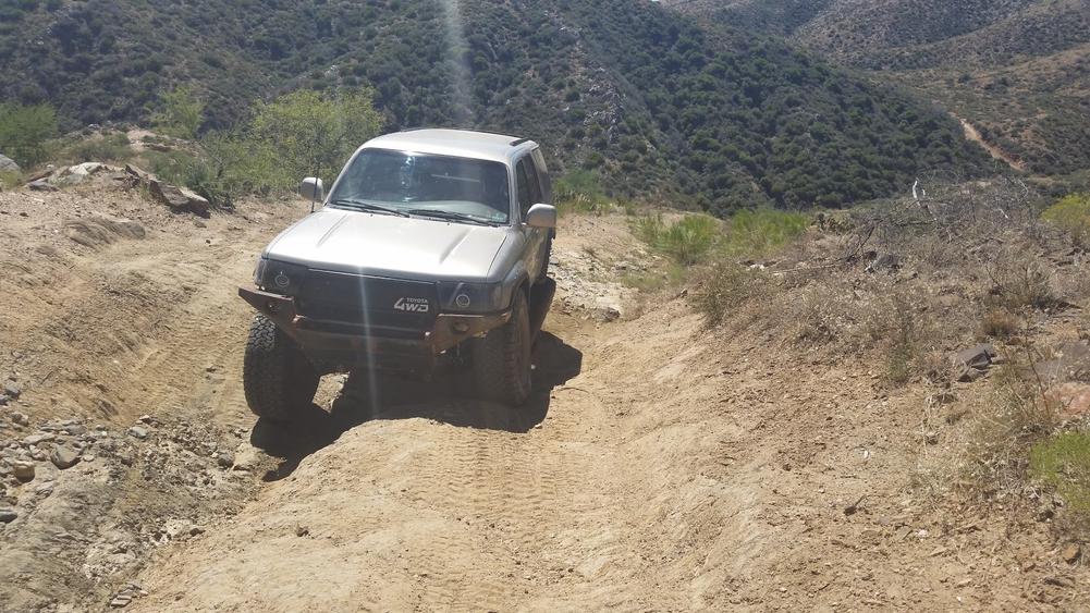

thats great, but I think any 4runner will flex like that in a spot like that, all the weight of the truck is forcing that spring to compress. the reality is that a softer spring rate in the front will compress more in more situations. thats not to say 700lb springs dont match up well with full skids and armor.
I was on bumpstops in the front so it won't compress any more haha, but that wasn't really my point. It's not so much "oh I flex so much" as a "you can still do it with 700s". I've seen many threads where people are worried and think that 700s are too stiff and will take away from flex. In reality they match up really well with full armor and a winch just like you said, and they won't hinder the performance of the truck off road

My ome 881 coils will do that, all the way to the bump stop. But they dont look as cool as you guys. LOL.

But can you touch your bump stops when you don't have as much of the vehicle weight helping you out like in the pictures above? If you're driving over a rock going uphill instead of downhill do the 700's compress Enough for you to reach the bumpstops? If not, I would argue that the stiffer springs are hindering the amount of articulation. Like [MENTION=100116]D Farms[/MENTION] said, a softer spring rate will obviously compress easier and I would guess this is the situation he was referring to.

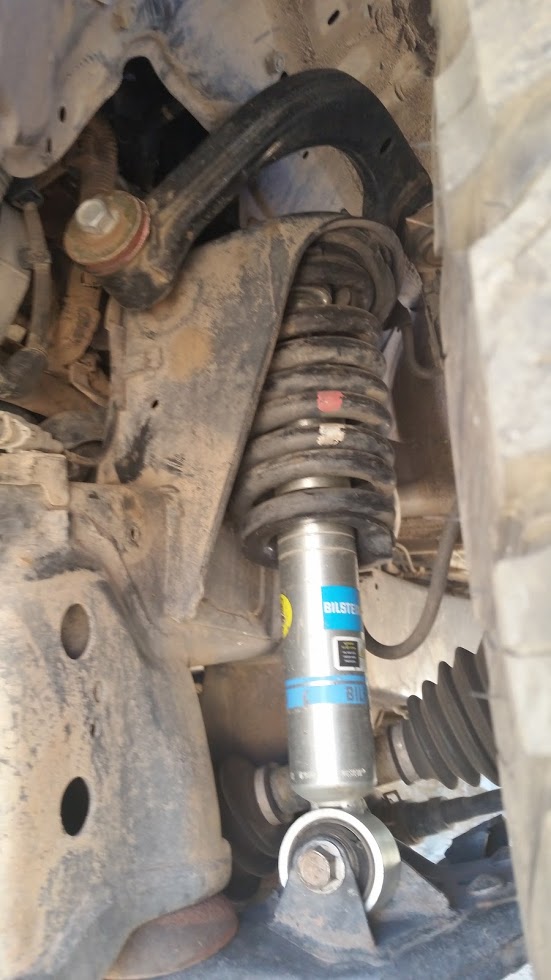

here, I shortened my bump stops and they are on the 4th perch, these are stock 2002 coils, the shortest available and I still have plenty of room to compress them on the 4th perch here, length is not an issue here. Also I have unrealistic expectations of my ifs and expect it to flex like a solid axle.
Nice. So in real world application the geometry is the limiting factor. Without seeing it I would have thought the coil would be just about maxed at that point. Its cool to actually see that geometry.
I cant say Im a true off road enthusiast, but if I were I would probably do the exact same thing you did there, without being able to afford ICONs. I currently run Taco 5100s with oem 99 coils. Basically the same setup, except Ive read the Tundra 5100s are valved heavier, as would be expected. Im sure the preload on your coils and the extra weight of the front bumper helps balance out the ride with the tundra 5100s
