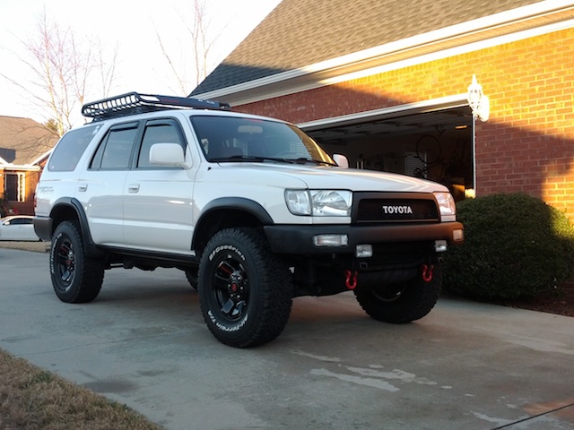

Here you go: 265/75/16r w/ daystar 2.5" lift.
NewLift.jpg~original
TNMud2.jpg~original
317.jpg~original

I have a short video walkaround of my truck after I did my lift and got an alignment; it isn't a Daystar lift, but it has ToyTec 2.5in spacers in the front, and Fat Bob's Garage 2.5in spacers in the rear. I have 31x10.5R15 tires which are roughly equivalent to 265/70/R16 tires (those have a diameter of 30.6in vs mine at 31in). The video is below.

If you get the 2.5in lift, your truck will look roughly the same as mine. I can take more pics of my truck on Friday if you want (the lift settled a tiny bit after driving a few thousand miles). Just let me know if there are any specific angles you want. I know I went through the same decision making process when I was piecing together my lift, so I'm more than willing to help you out.

Also, for what it's worth, I got the full 2.5in out of mine, which settled down to about 2.25in all around after about a thousand miles. Since mine is a 97 2WD 4 cylinder, it sat about as low as your 2001 when it was stock, so what you see on my truck is about what you'll see on yours if you go with the 2.5in lift.

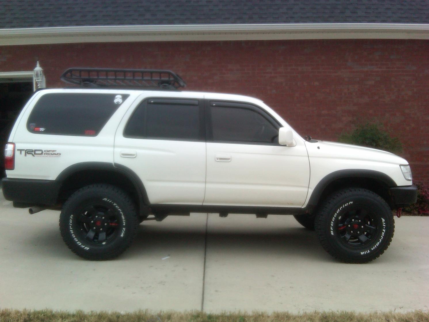

Alright, so both of the images show 265/75/r16's:
BEFORE the Daystar 2.5" Leveling Kit:
IMG00093-20100123-1551.jpg~original
AFTER:
IMG00216-20110408-1902.jpg~original
Thanks, these two pics actually help a lot as well, the difference in springs i think from ealier 3rd gens to the 2001 and 2002 that sit so low really do not make the 2.5" spacer look overly huge, I appreciate your posting very much, very helpful!
