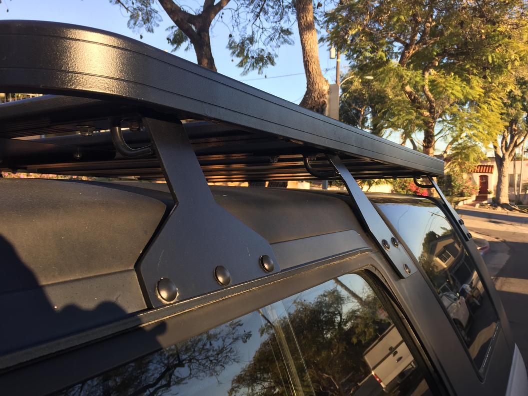

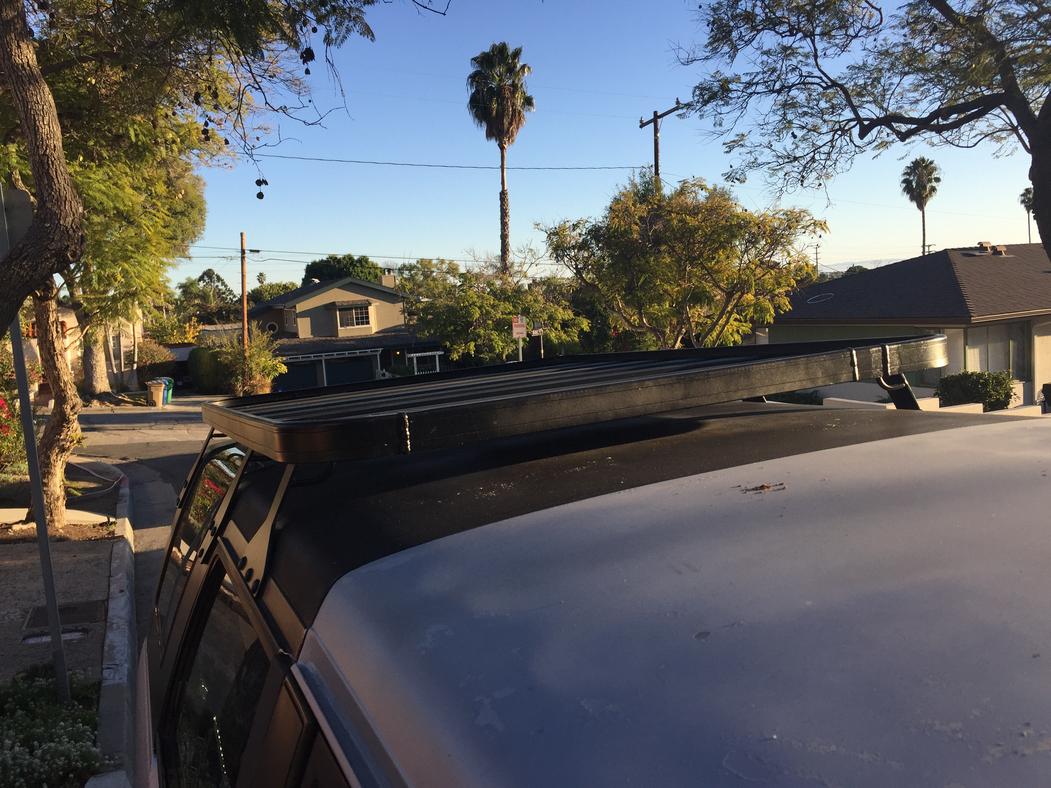

1st Gen meets Frontrunner slimline

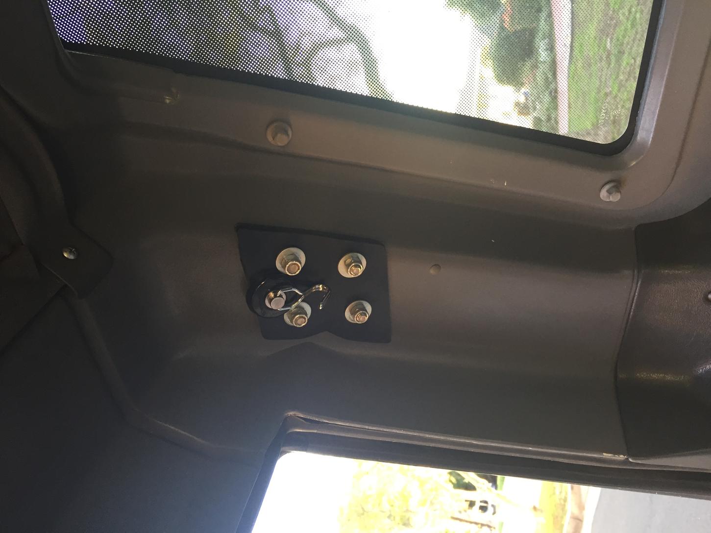

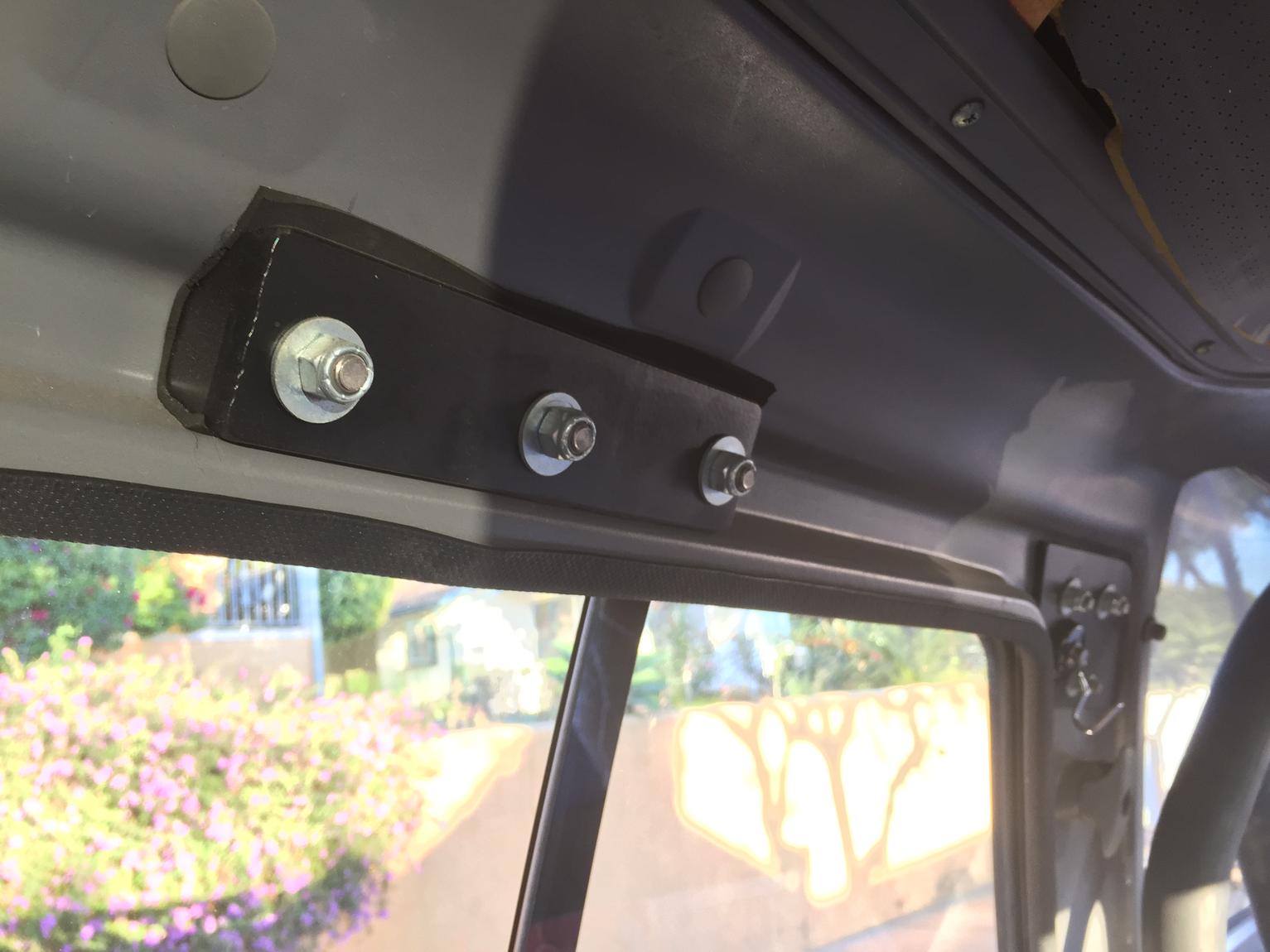

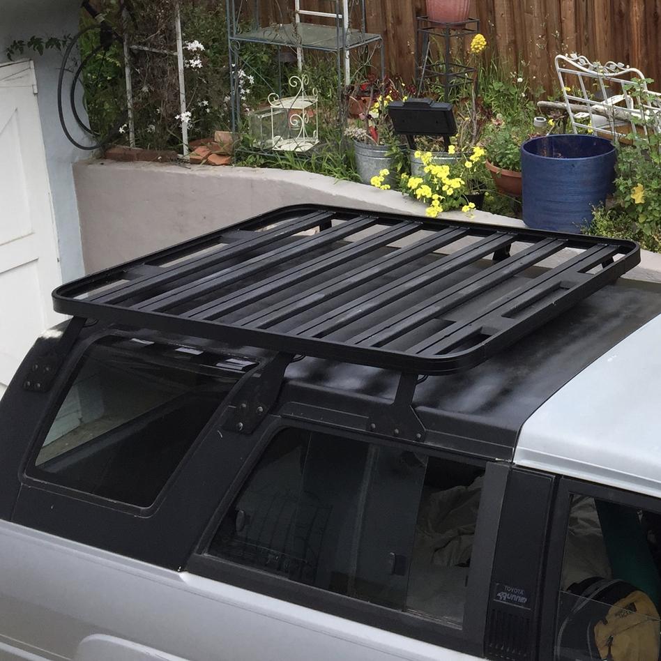

Been meaning to post this for a while now, sorry took so long.
I customized the Frontrunner aluminum slimline 1 to fit the width of the fiberglass top better (44" instead of 48" width).
Then designed the custom brackets for a local welder to fabricate. Brackets bolt through the top and meet up with interior steel plates. In essence the two plates sandwich the fiberglass top, which spreads the load to the surrounding area, not just leaving the bolt hole to take all the pressure.
This is one of my favorite mods to date.
Designing rear bumper as we speak here. Planning to have my same welder fabricate for me.

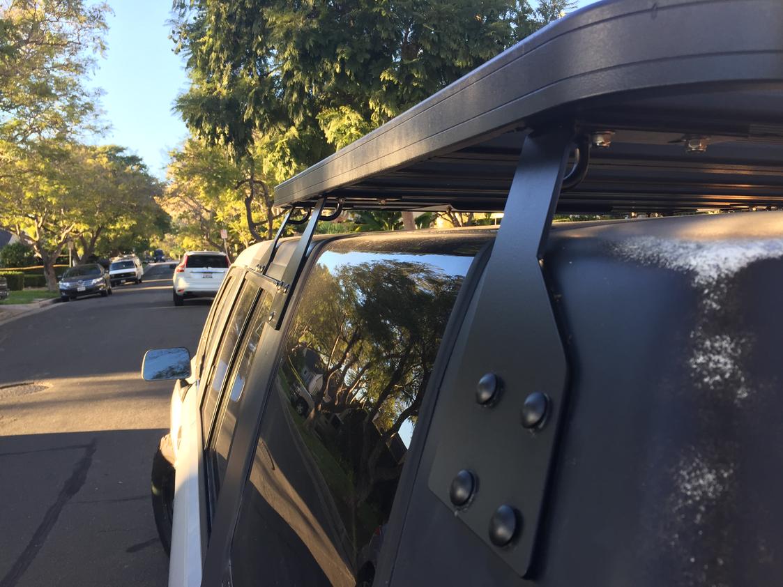

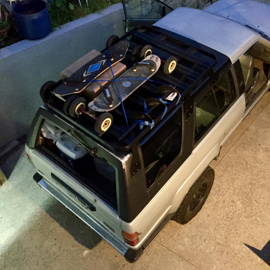

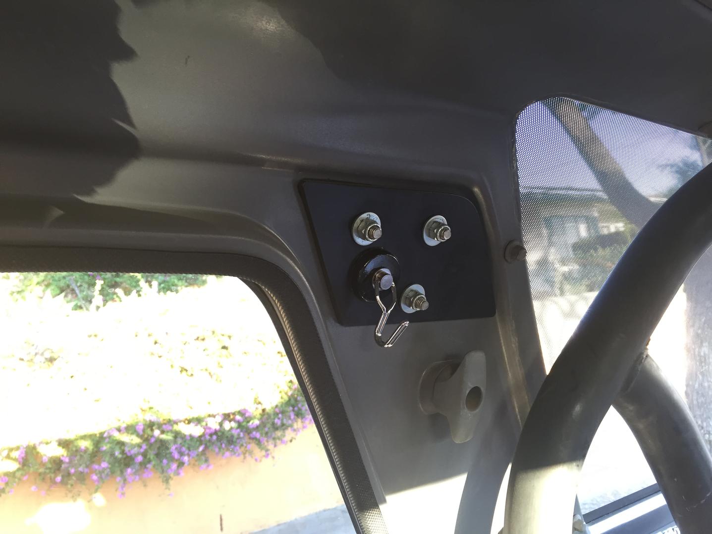

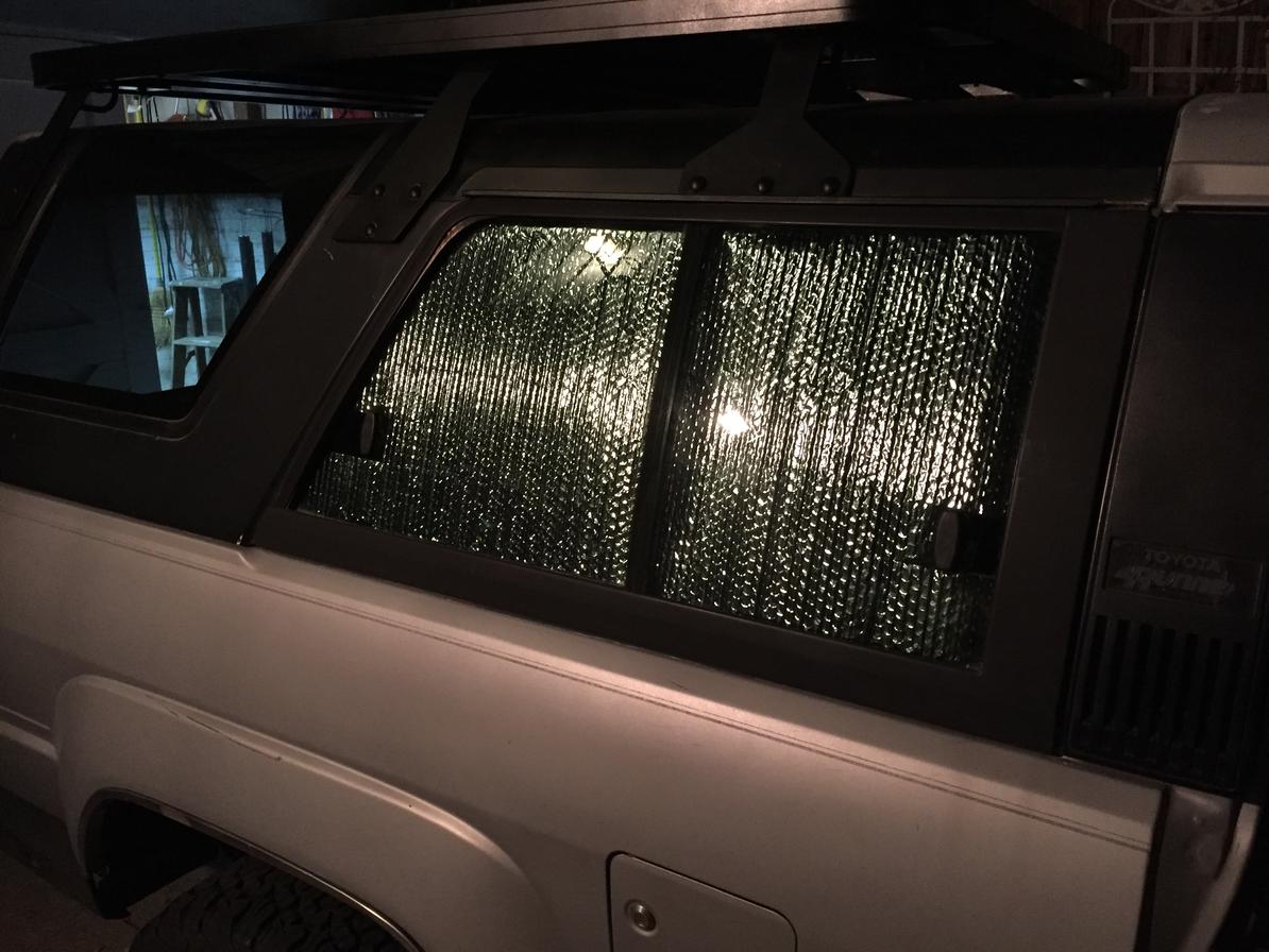

...more pics of Frontrunner rack
Here are a few more photos of my rack and mounts.
Glad you guys like it!
