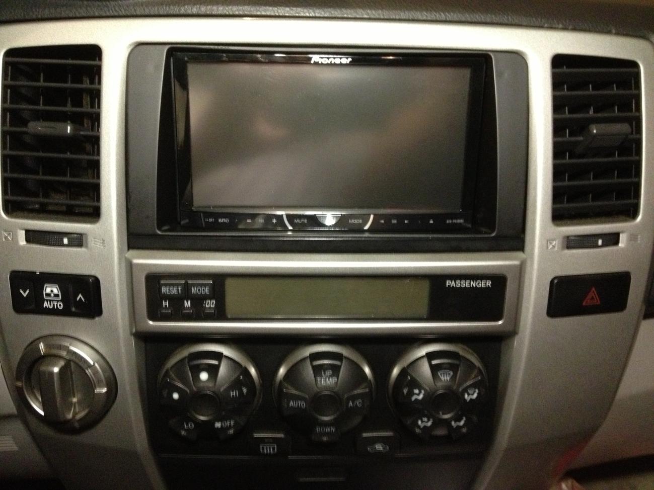

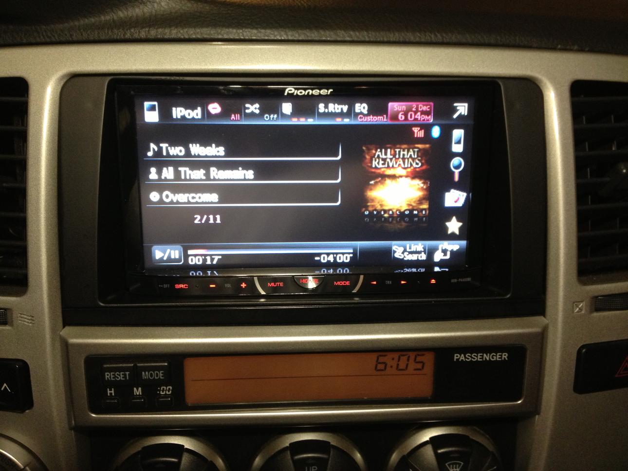

I literally just finished installing the same head unit in my 04 Sport about 45 minutes ago. The place I ordered it from sent me the Metra kit and said it would fit, as you know, it does not. Luckily I had another kit from a previous install that I ordered from Best Kits. It works perfect. If you do a search on here there is another member that had this same problem.
You don't need the Y adapter.
Thanks ohp, thats exactly the info I needed, I wish I would have known the meta didn't fit, do you have a better pic of your install? I'll order one of the best kits ASAP.
Here ya go.
i sanded the texture off the dash kit and spray painted it flat black It matches the rest of the black dash pieces pretty well.

Hey, OHP, the install with the BestKit looks really nice! Question...it looks like the screen is recessed a little bit, does that reduce the viewing angle? Can you still see the whole screen from the driver's seat?
I'm thinking about getting the same stereo for my 2008 SR5 and will probably go with that kit. It says it's for Sport and Limited...anyone know if there is a difference on SR5 that would keep it from working?

Ok, finally found some time and with help of this thread have redone my install. Thanks to Techsan for letting me borrow his factory JBL stereo so I could check all my initial settings and OHP for the pics on the install kit!!!!
So I uninstalled the Pioneer and sure enough the didn't connect both antennas so the reception was shite, found another post about poor reception and ordered the parts to connect both ends of the antenna. works great with twice the reception. Now my radio works like factory and can get reception!!! Also hooked up Techsan's JBL factory radio and it was set to fade to the rear, changed that back and made sure all other settings were 0. Also checked the TATO adapter and set it to full gain to get max volume. Works great now, Thanks Techsan.
Also sanded and painted the bestkits mount per OHP and removed that crappy Metra kit. Took pics so you could see the difference. My install looks just like OHP!!!! Looks better than factory if that's possible.
