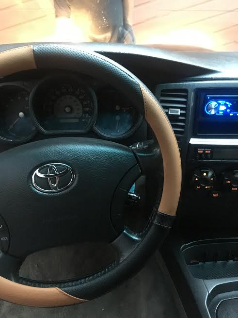

Purchased an '03 Limited two days ago. Have been tuning it up before a cross-country trip back to school in two days.
Took apart the dash and installed my own radio. Radio works perfectly. Also painted dash with black truck bed liner. Looks awesome.
I put the dash all back together and turned on the car to find that the instrument cluster was not working. No lights, no odometer, no movement of the gauge hands.
Was there a wire cluster I did not connect again?
When I took the dash apart, I did not go past the instrument cluster.
All the lights work, the turn signals work, the radio works, etc. I checked fuses and spun the dash light. The problem is that the entire instrument cluster doesn't function.
I've attached an image. Let me know what y'all think!
