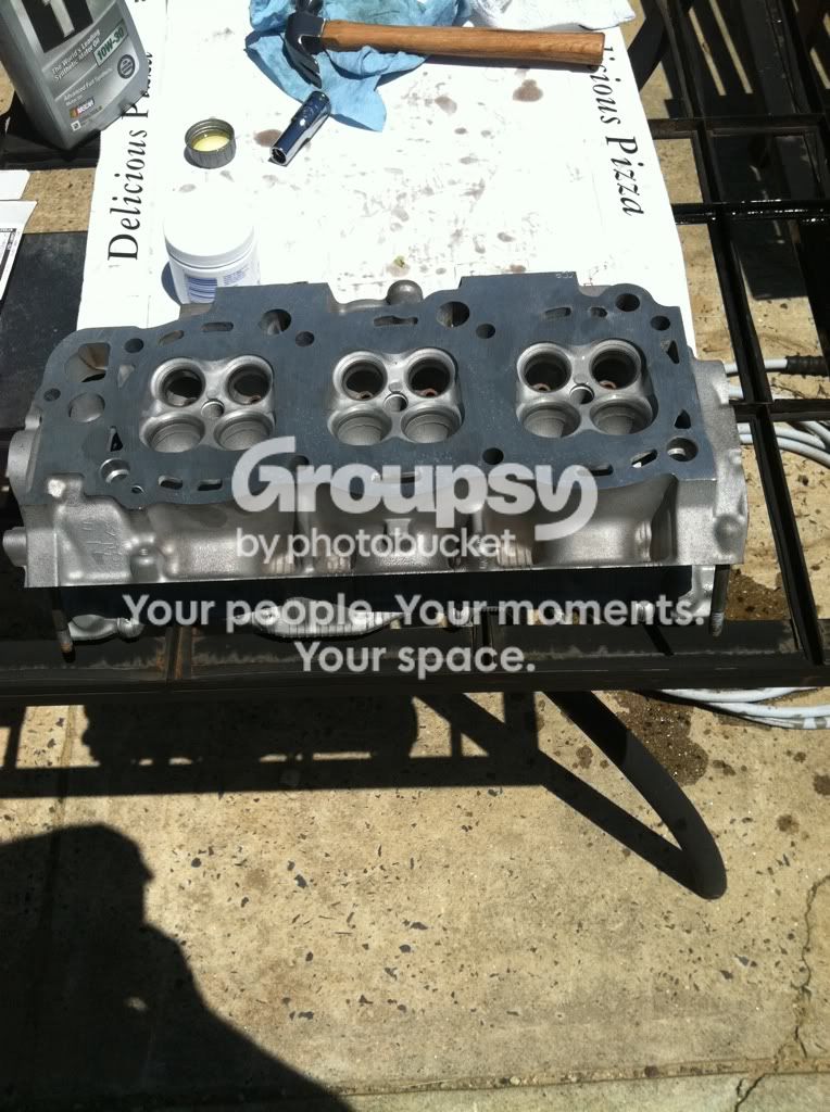

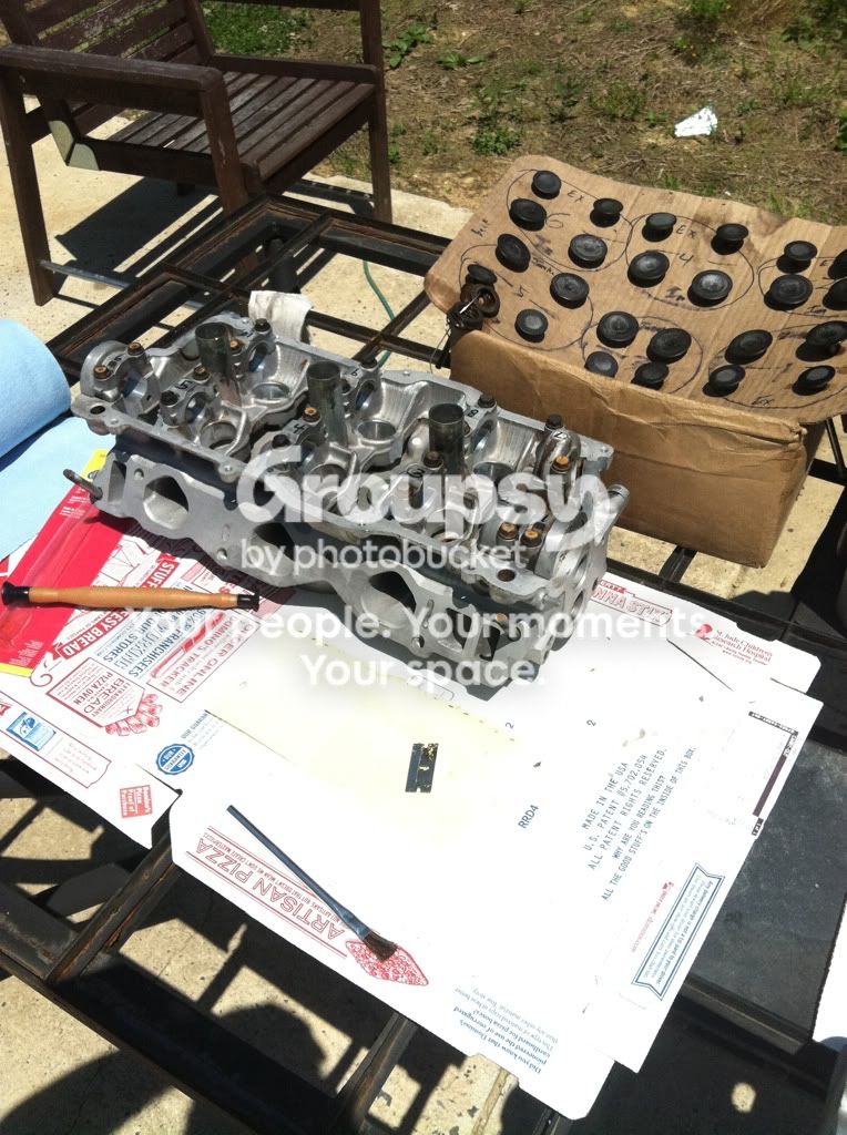

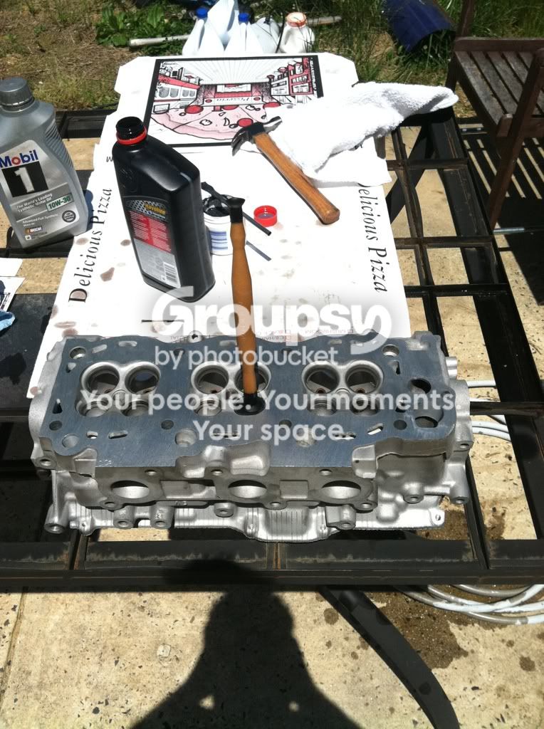

Some progress today. Heads are back from the machine shop. I installed the new valve seals and lapped the valves. I will most likely re-assembled the heads at some point today too.

Re-assembled one of the heads today. What a pain in the *ss. The keepers just wouldn't cooperate. But I got it done. Cams are in, I may tackle the valve adjustment tonight. (we'll see, long day.).
One of the valve seals I got sent was bad, I contacted the place I bought the kit from, they shipped me a few more today as a replacement. I'm going to wait to re-assemble the other head until they arrive, I don't want to disassemble it again.

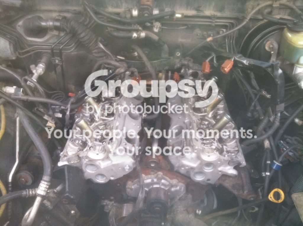

And, installed the heads today. It's coming along.

Yeah but I didn't take pictures yet. Bolted the cams back in in. And spent two hours trying to get the drivers side exhaust manifold back on. Wound up tearing up my shoulder a little bit (I've had problems with them for years) and got more pissed off than I knew was ever possible. I'm planning on diving back into it tomorrow.

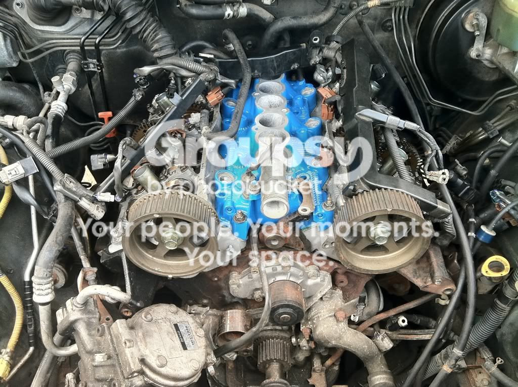

Put a little time in today. Didn't make much progress, just finished putting the exhaust manifolds on (which is a b*tch) and installed the lower intake manifold.
