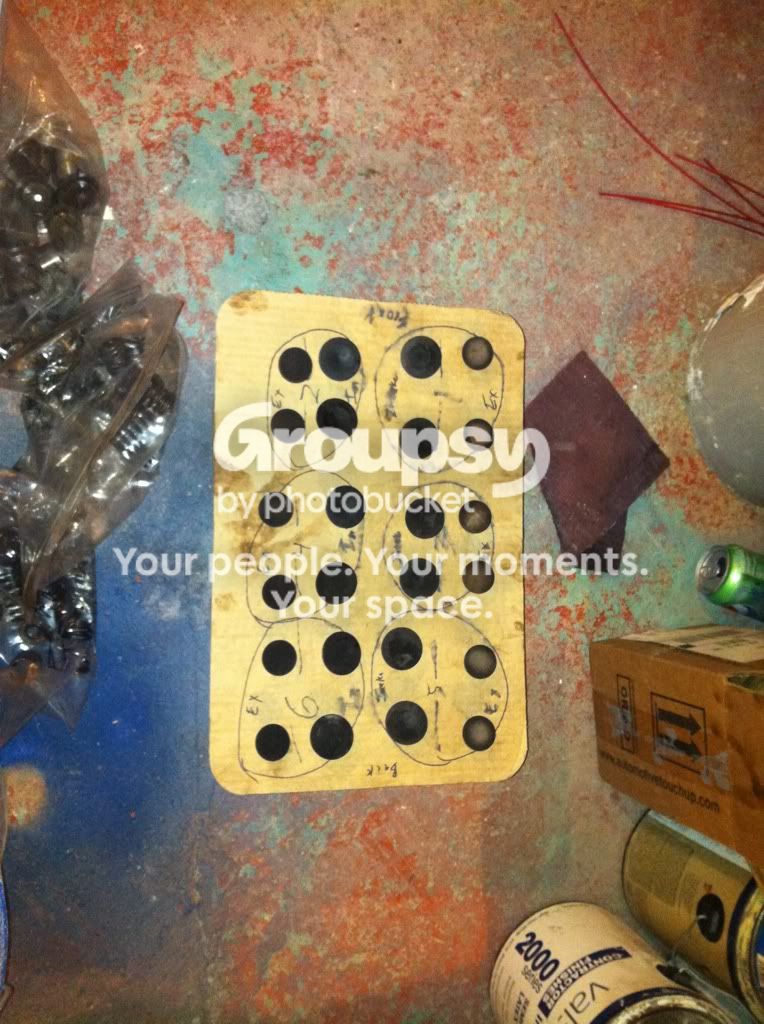

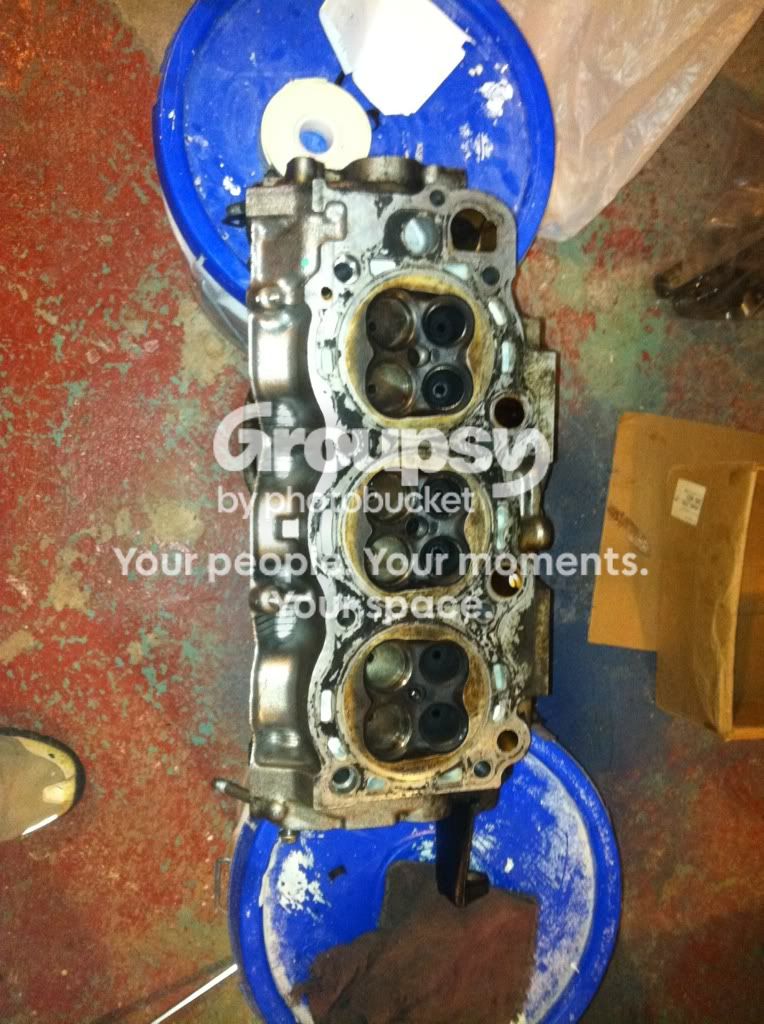

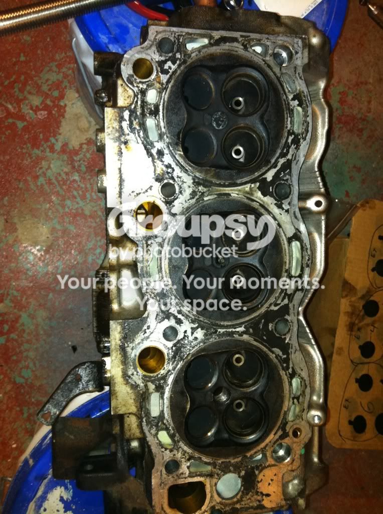

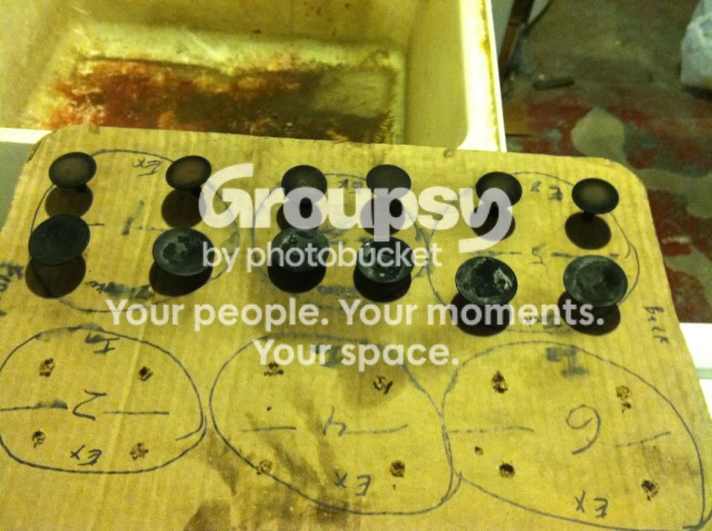

So, I got home from work tonight and dug in a little bit. Dis-assembled both heads. They're headed to the machine shop later this week to be hot tanked and decked. I'm going to lap the valves and re-assembled them myself.
Da proof :)

Pretty clever with the cardboard filing cabinet. Makes me wish I had done my own valves. Do you have a bench grinder to buff those back to beautiful?
