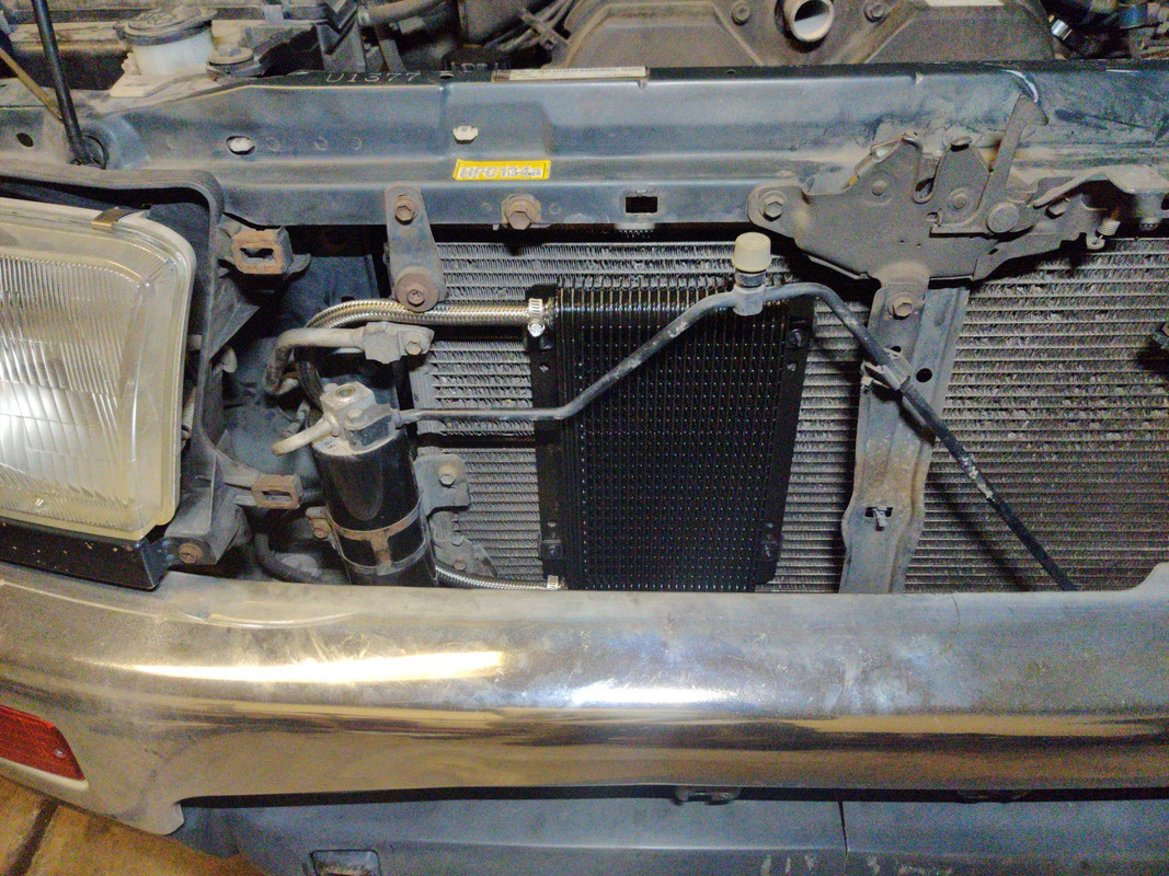

I installed a B&M 70264 about a month ago. It's the bigger of the two choices from B&M that most use for this mod.
It's twice as thick, but the face of it is more narrow. This one is rated at 14,400 BTU versus the 13,000 BTU of the smaller version, B&M 70268.
I had to remove the horn on that side to get it to fit, but I was planning on tossing the factory horns and relocating the mounts for an upcoming mod anyway. If you want to keep the horn there, there was another thread where someone mentioned they just bent the bracket forward to get it to clear successfully.

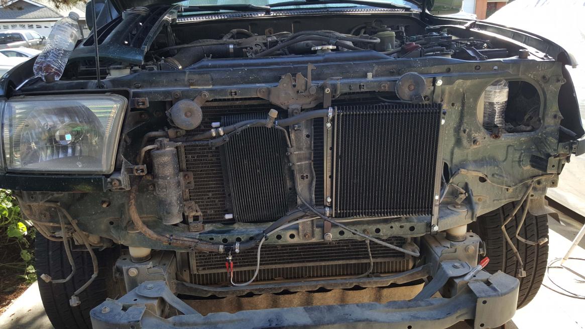

Hayden 699, it's big, I made brackets for it, but I also installed a fan for it a bit of fab work. Fan on at 185 and off at 165 with manual on too. Overkill, yes but ther is no kill like overkill. Bypassed the stock cooler as that is a weak link period. If I have a too cool issue in severe winter conditions I can toss a piece of cardboard over it and be done.
Edit to add - I ran the B&M cooler but it didn't make the cut for me, I wanted a fan and more cooling capacity. I didn't want to take it out, so I flushed it, then made it a power steering cooler, there is where it works perfectly. One day I'll remove it to replace the a.c. condenser.
I used the same. Used the brackets that come in the kit instead of the zip ties through the AC condenser.
