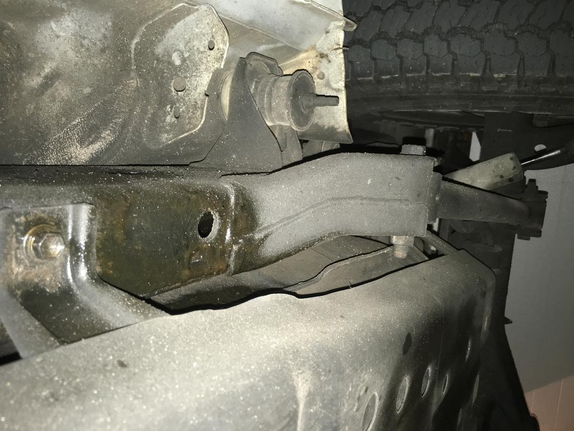

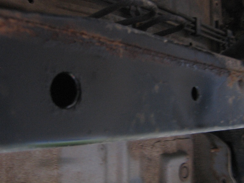

Also, I made sure (see hole in frame in pic) I can keep the inside of the frame near the rear lca free from pooled briney water, gravel, salamaders, etc. The frames on pretty much all 3rd gens I see around here are rusted in half at this point, and full of a wet salty dirt and rust flake paste.
Here's a shot with the cosmo and fluid film wiped off. You can see where I hit the bare metal with touch up paint after drilling. That was two winters ago. I'm going with the theory that greasy metal does not rust. I feel I lack the skills to properly prep and paint a frame, but I can apply fluid film and cosmo.

What drill bit did you use, that looks large? My largest bit I think in 1/2".
3/4".
Thanks, I'll just stick with my 1/2" for now.

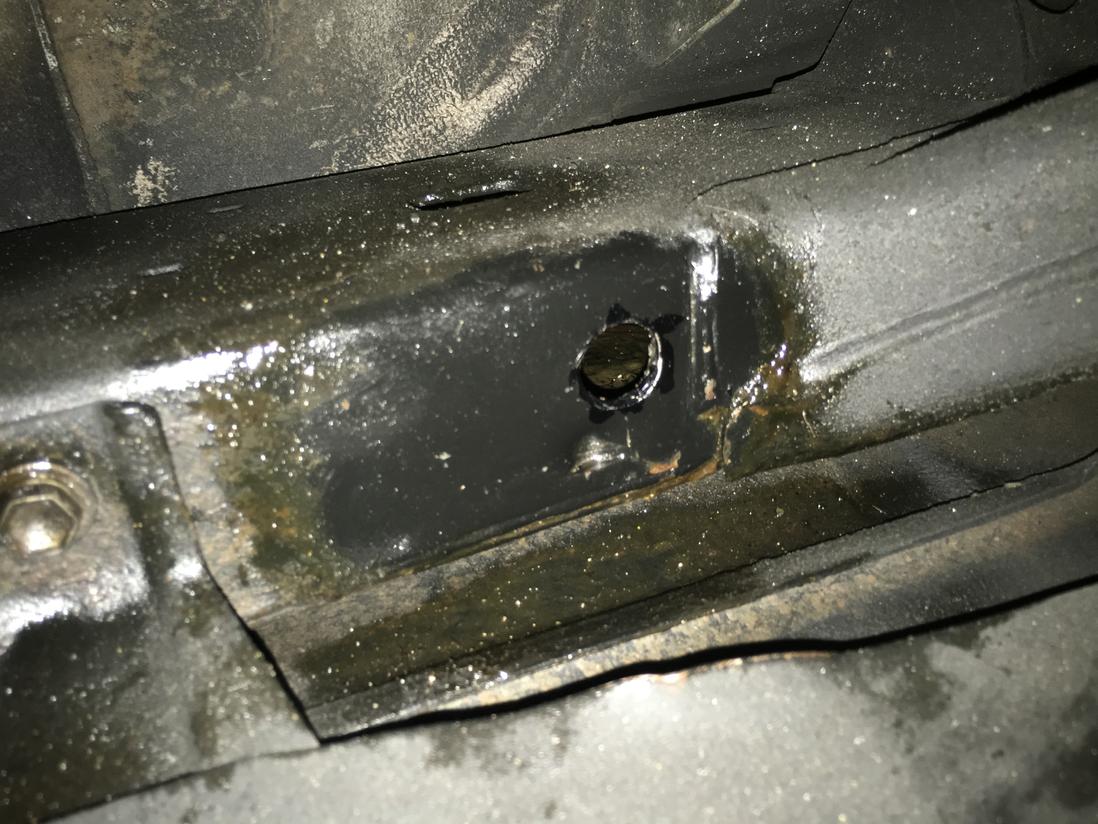

Last Sat I attempted to drill a 1/2" drain hole in front of the DS control arm mount. I started with a 1/8" bit & then a 3/8" bit but the 1/2" bit was too dull. So I have a 3/8" drain hole & I'm very happy to say that there was plenty of steel to drill through. I was a little worried that if it was rotted inside that I would have pushed through too easily. So my frame is still solid! :thumb:

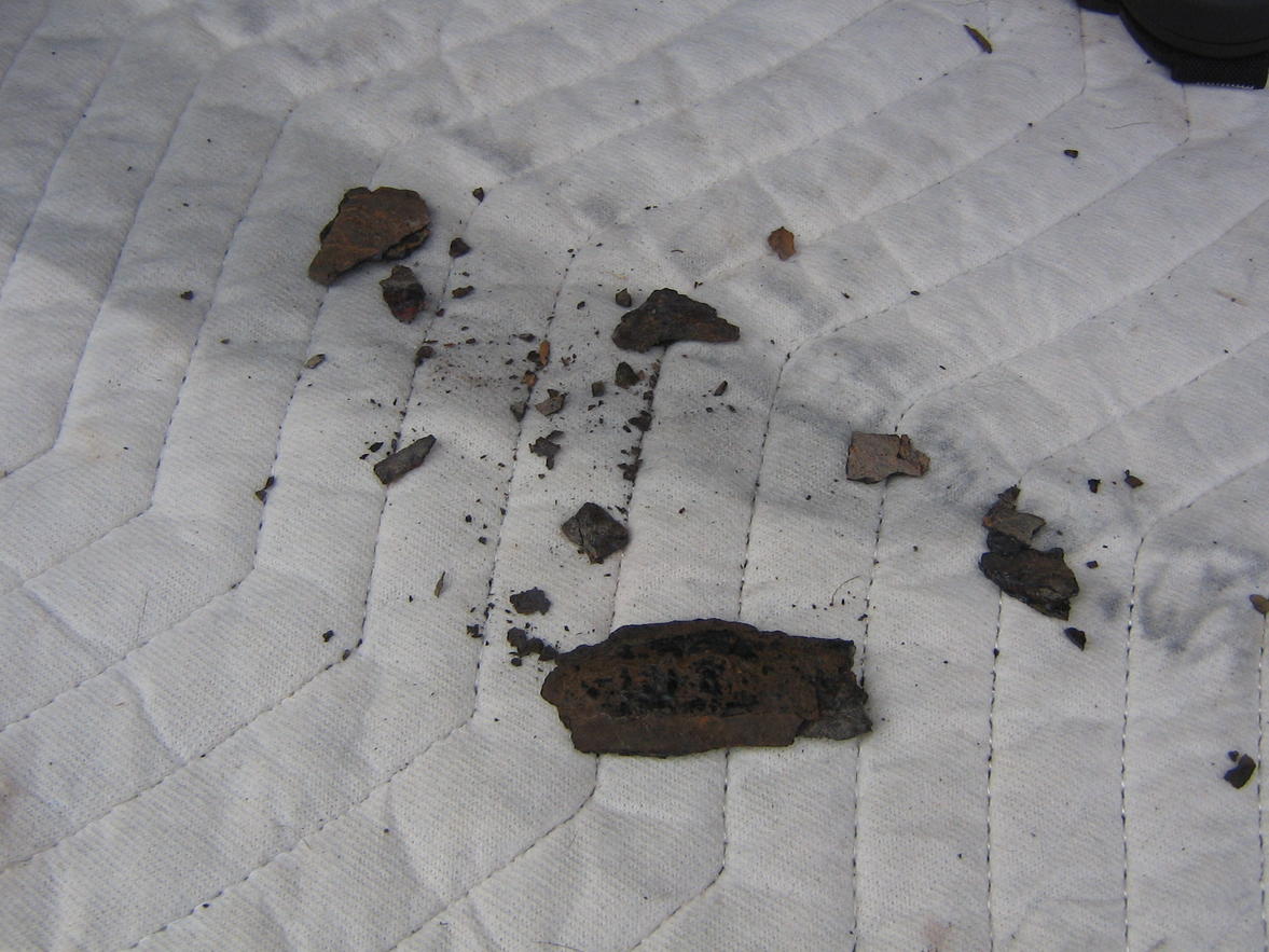

All of those brown chips in the center is what came out of the front square DS drain hole. They didn't come out with water, they had to be pushed/pulled out with my fingers. You can get your pinky in the square drain hole.

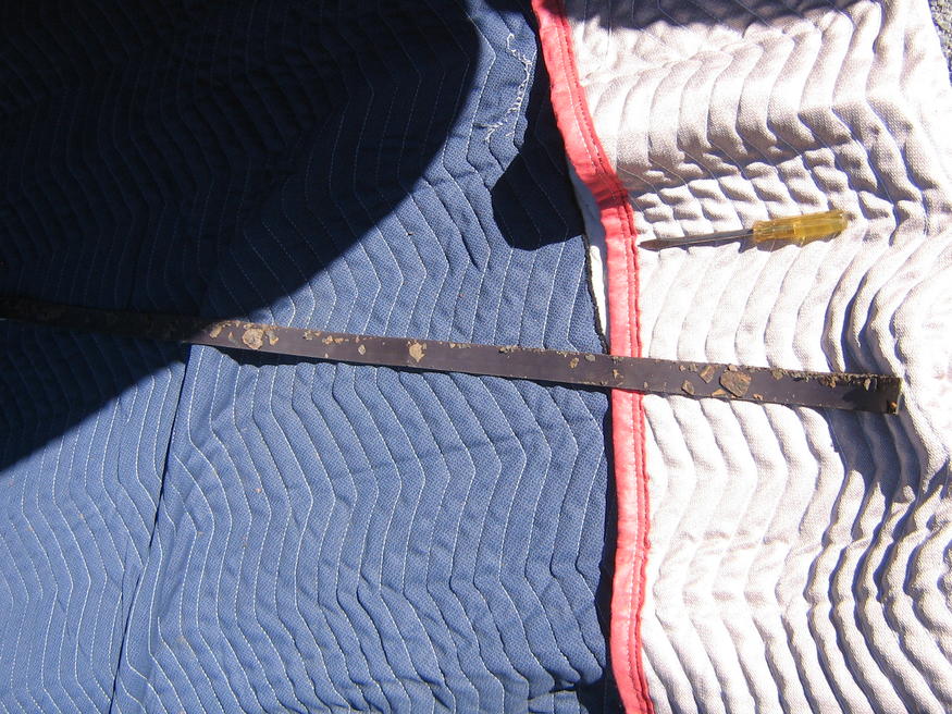

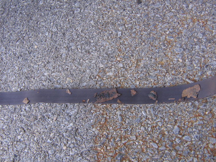

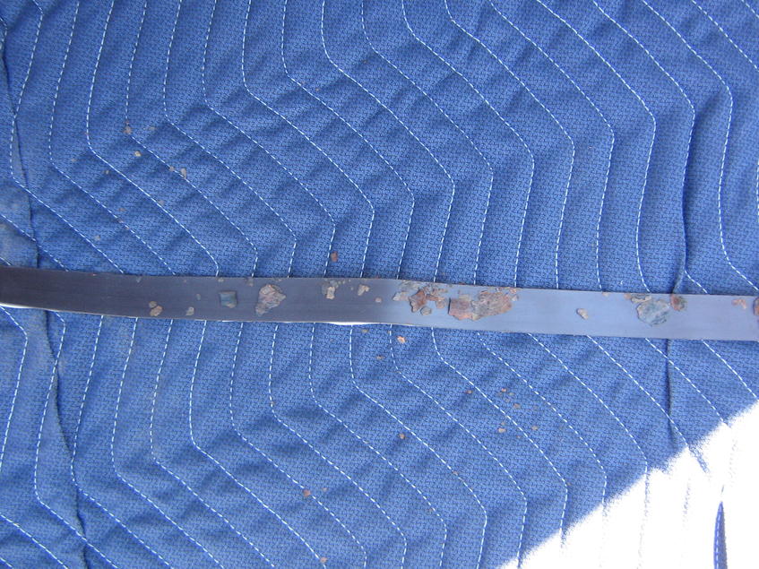

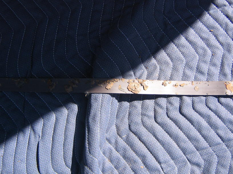

Here's a few pics of the larger rust chips I got out with 1" wide magnetic strips.
The strips come on a roll & I fed it into the frame from the rectangle holes on the sides of the frame.

You have to pull out the strips slowly or the flakes fall off back into the frame.

I was surprised how many flakes were still in the frame after rinsing it out with water a few weekends in a row.

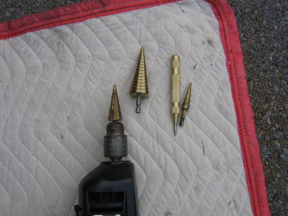

I watch every car show on TV & saw the body guys using these step bits so I though I'd give them a try.
They make quick work out of the frame & I hit the holes with some general purpose black paint for now. The next step is to hit the inside of the frame with the Eastwood Internal Frame Coating when the temps & humidity are good outside.
