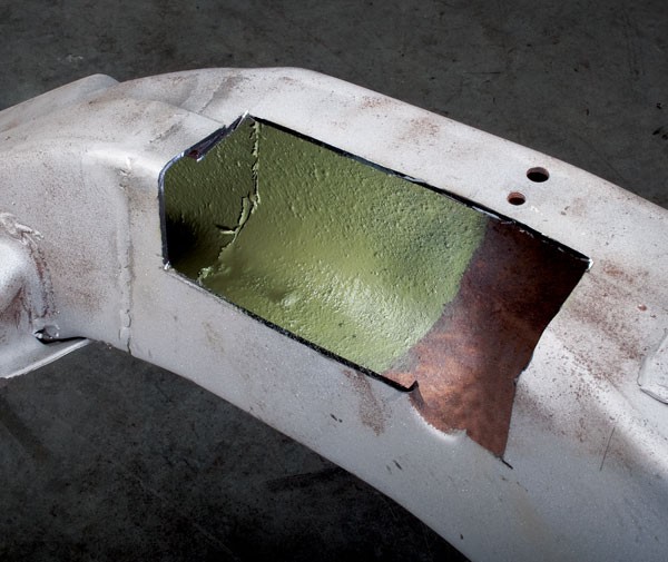

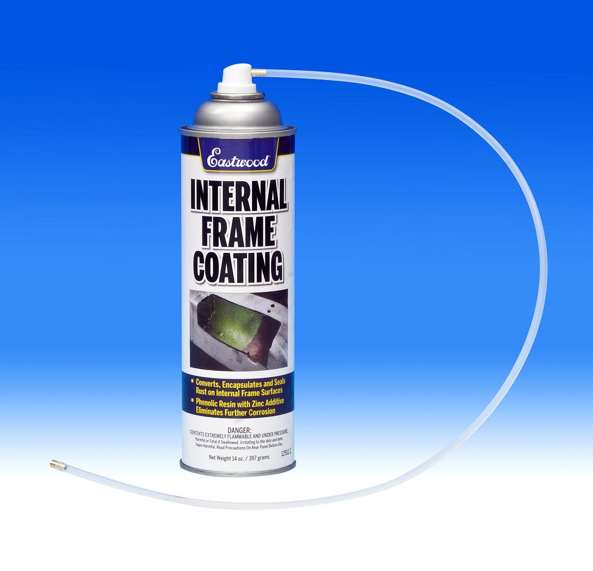

Forget about the oil for now, you can do that last. The inside of the frame needs to be totally clean & dry & you spray the Eastwood rust encapsulator in there. Then paint the outside with the rust encapsulator of your choice & then chassis paint over that. Fluid film & oil will not stop rust. You can use them after the previous steps.

Yes, if there's still silt in there it will absorb the water & stay wet for a long time & accelerate rust. My silt was building up in front of the control arm mounts where the frame starts arching up & it feels pitted & flaky in that spot. I've managed to wash the silt forward where there was no internal rust & this weekend I plan on getting it all out & as soon as it's dry apply the Eastwood internal frame coating. It might take until the following weekend to apply the Eastwood but I want to do it right the first time so it will be good for a few more years.
