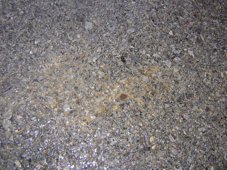

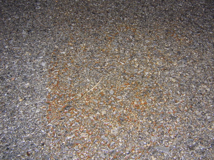

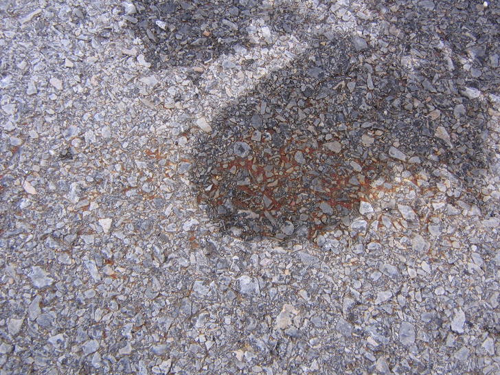

I took a few pics even though I didn't think they would show much. My little old Canon A470 still does the job.
My driveway is clean so anything you see came out of the frame.
The tan is dirt & the brown chip is rust. This was from the back.

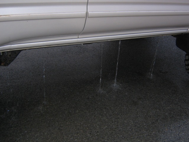

I put compressed air through every frame hole I could find, then proceeded to run many many gallons of water from the back of the frame to the front, then through each hole in the frame front to back. I PORed the outside then fluid filmed the inside. After each snow I give the frame a good bath.

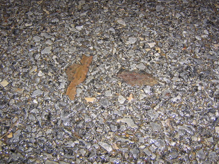

I'm scared to see my inside. LOL The hammer test & finger test feel fine though. Like I said in the other rust threads, my trucks been to the car wash after every snowstorm since new. The frame is still solid and I'd like to keep it that way now that I know there's surface rust inside.

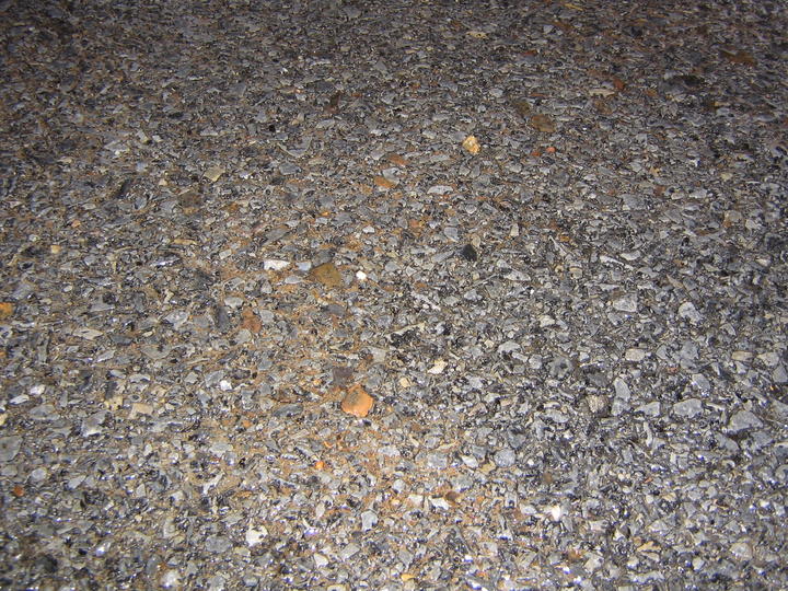

These rust chips came out of the passenger side.

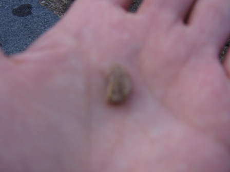

Bigger rust chips that came out of the big drain hole. Drivers side front.

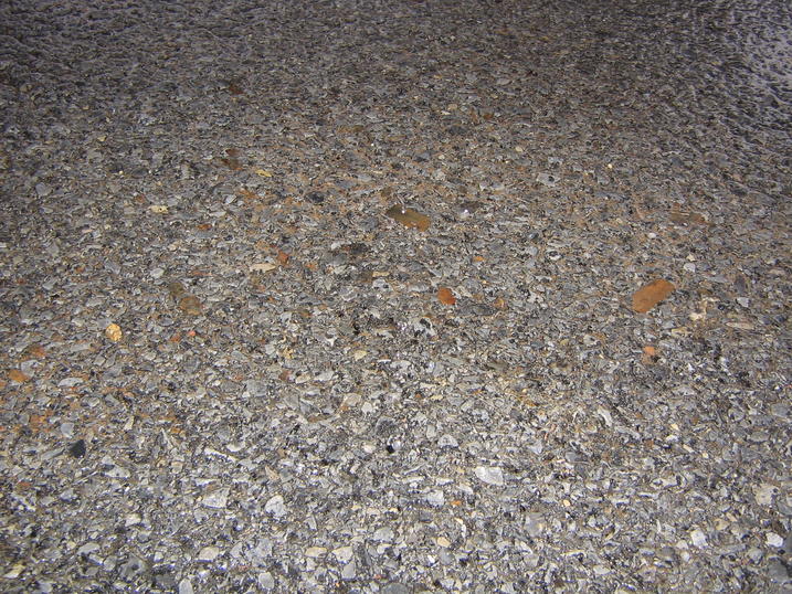

3 more pebbles, it's amazing what gets in there. Remember that these small rocks will block the drain holes & keep dirt & moisture in.

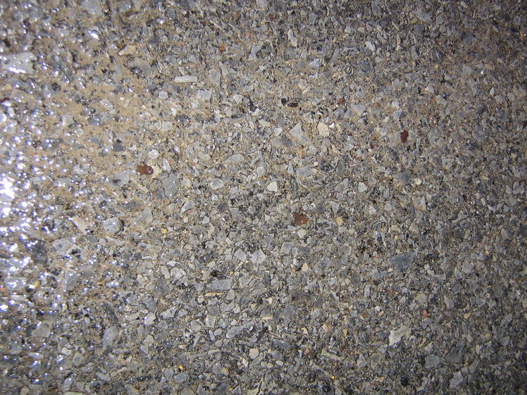

The little Canon had a tough time focusing in on the rock, sorry, but I got 5 of these out of the drivers side. Two with my fingers & 3 came out of the big front drain hole.
