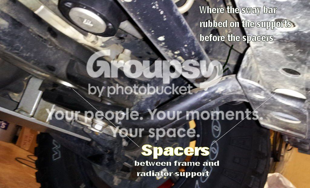

So looking under my truck, there is no rubbing but it looks like the stabilizer bar is hitting the frame of the truck. Any way to fix this? I'll post pictures soon.
It's the bent part of the stabilizer bar (towards the middle of the bar. It's resting on one of two forward oriented support braces. The right side has plenty of clearance and the left side is touching the bent part of the stabilizer bar.
Purchase the sway bar relocation kit. It drops the bar and those support braces and should stop the two from colliding. I've seen them on eBay fairly cheap, any of the sponsors on here should sell them too. I ordered mine on sale from icon off their website think I paid around 30$ shipped.
I installed the sway bar relocation kit already included in my stage 1 suspension. It moved it forward and down. It helped it not rub against the coilovers, but now it's hitting the front of the "compartment" bout to upload pics.
Alright, here is a shot from the drivers side looking into the area under the skid plate. You can see where the sway bar is touching the brace.

Welp, after browsing some. I saw harper7's post on this. I think I put the skid spacers in the wrong place. Doesn't looking like they're for the skids, but relocating that brace instead.

If your asking if you need to put the spacers on,then yes you need to put them on or take your sway bar off. It will bind more and possibly damage the sway bar mounts or link if you really flex the drivers side. It's not that hard to do.
Hey harper, I was referring to the chips on the UCA's. I found it weird that they were only on the drivers side UCA and not the passenger side. Thought maybe something was up.
I just installed the spacers and it gives me about a millimeter or less of clearance. Doesn't seem like much. Is that about right?

Seems like you should have more space then that but as long as they don't hit is what matters.Heading out the door....Happy Holidays!
