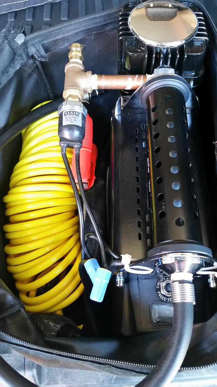

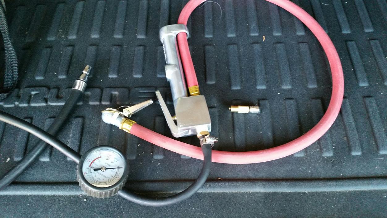

1st photo is of the tip of the Smitty Built air chuck cut off and the replacement air chuck. The tip is used as a deflator. The replacement Air chuck was from Amazon the 1/4 NPT barb from Harbor Freight.
2nd Photo is a 1/4 NPT copper T and 4" extension to clear pump. Blow off valve is at top and the Viair switch is on the other side. Turns on below 80 psi, off at 105 (no hose issues).

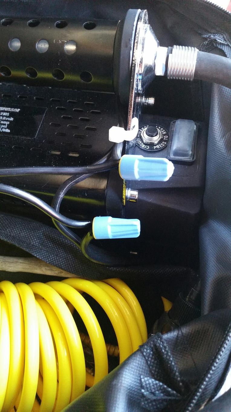

3rd Photo is of the Viair switch tied into the power line with waterproof wire nuts. The zip ties are for strain relief on the power line.
I did this because the basic Smitty Built air chuck is "always open". You have to attach it to the tire valve and then turn the compressor on. With this setup I just turn it on and air up all tires.
