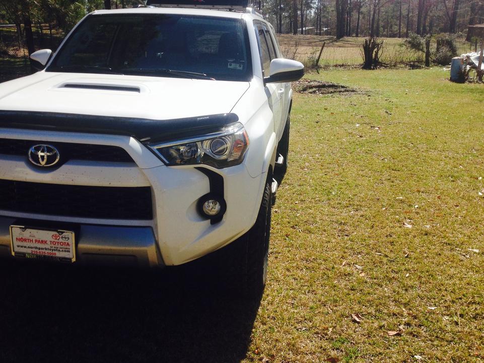

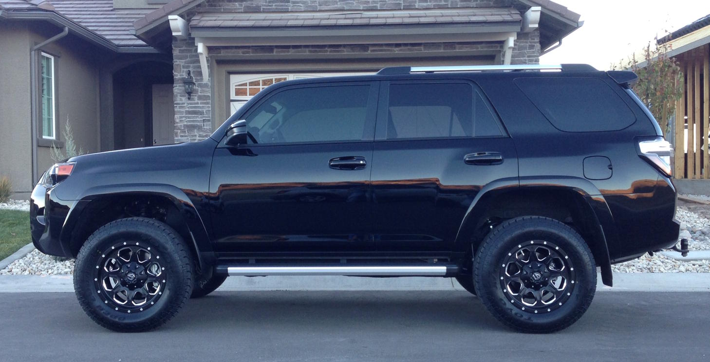

Finally got the lift installed and thanks to everyone who posted their info; it helped me select the items I chose. It still tracks at freeway speeds and had it aligned 3 times. I may have to get UCA's. Other than that, I'm very happy.
Bilstein 5100 2.5" front (stock springs), Bilstein 5100 and Daystar 1.5" rear (stock springs), 18X9 Fuel Boost wheels, Toyo 275/65/18 AT II's. 1" Trans drop. Firestone airbags.

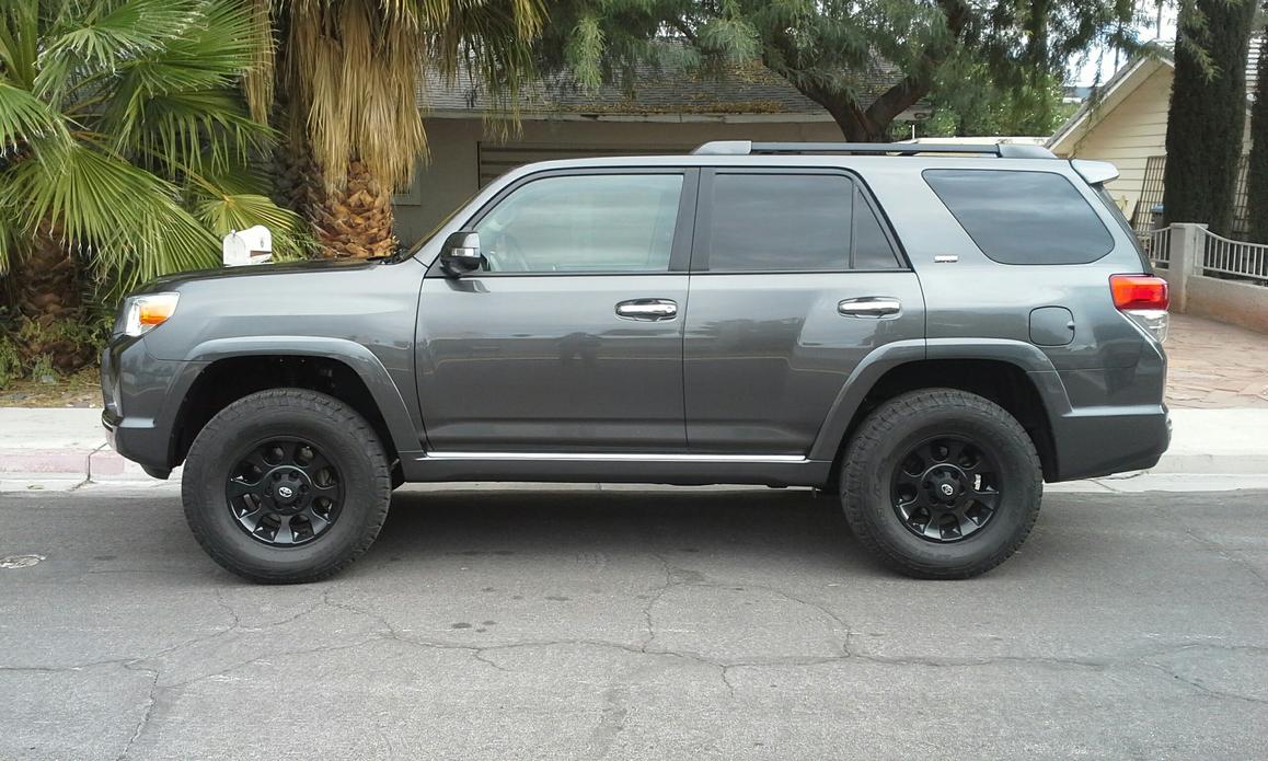

Took off rear spacer .
Didn't like how I thought it looked higher n back . Now it's not ? Sorry for night pic got done late . :redface: Will post daytime pic !

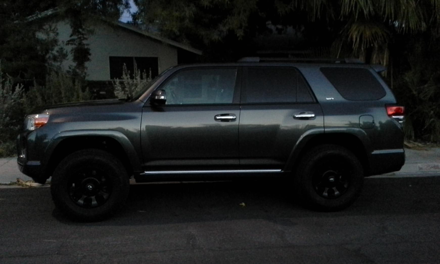

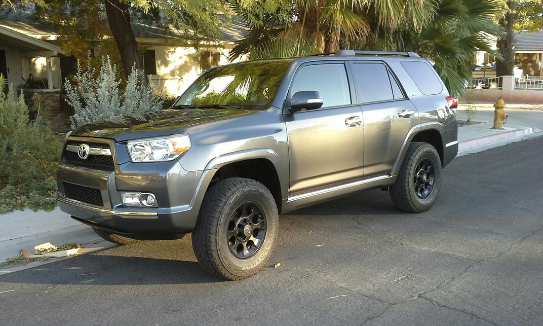

Unlifted
Better pics of it w/o the rear spacer . Kinda of a prerunner look ? I do have a 1 1/4 spacer coming to level it waiting on 51s from carid . Luv the mag gray with a little sun on it !

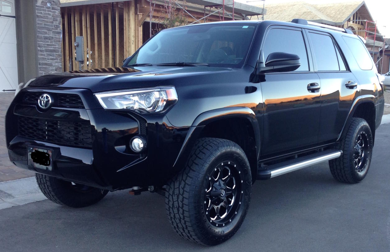

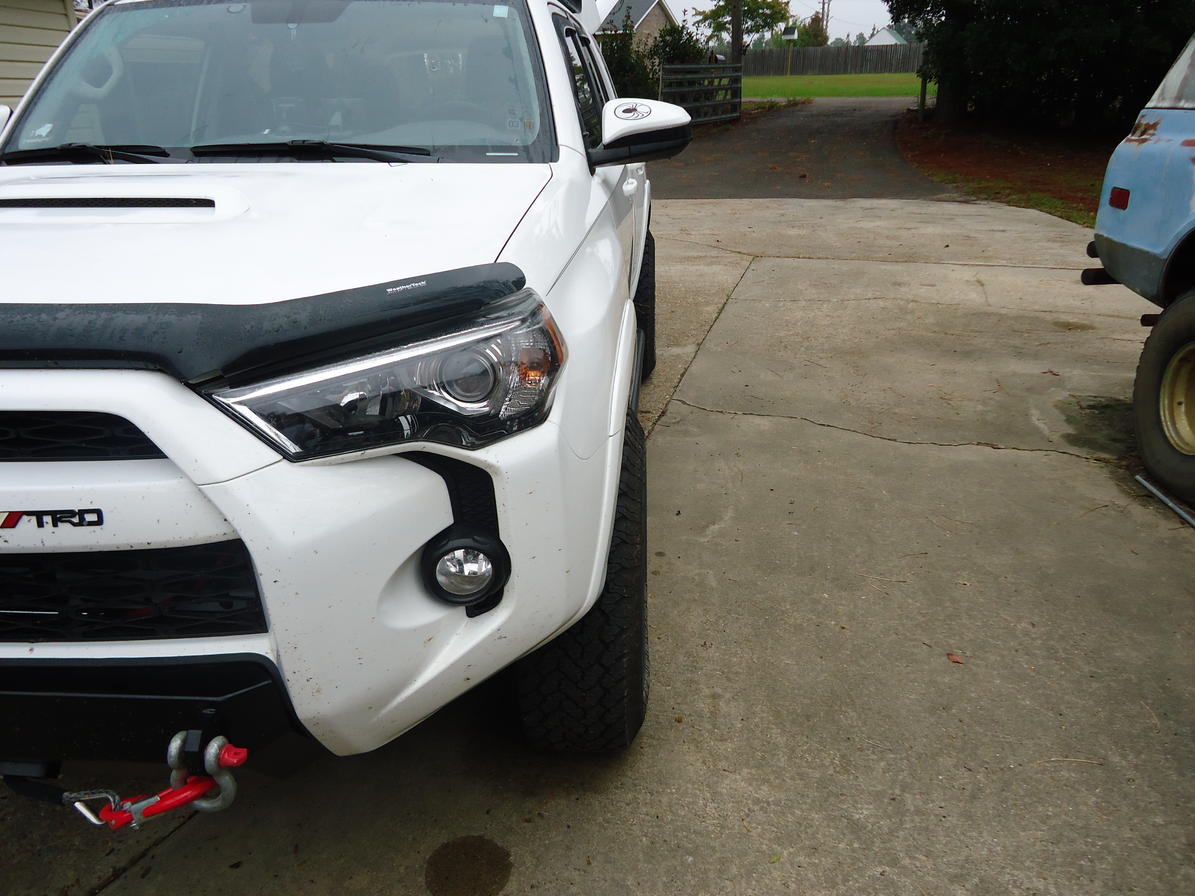

The pictures below are using 265/70's on 8" wide wheels with 4.5" of back spacing. Top is without and bottom is with 1.25" spacers I had to trim both front fender and the mudflaps. If you go this route with 285's you will very likely also have to do a body mount mod.
