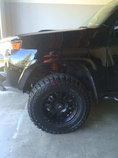

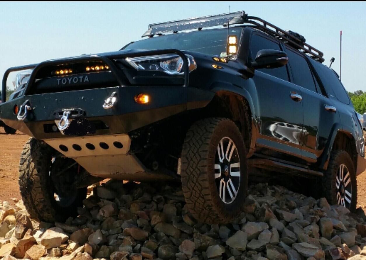

nothing crazy but... bilstein 6112s (on the 2nd groove) on the front, 5160s on the rear with the stock springs. I like the slight rake, and need it due to heavy camping gear that gets lugged around.
thanks to Curt @ C&C Northside Motors in Houston and [MENTION=120150]TotalAutomotiveLV[/MENTION]. Couldnt have got this pulled together in time for the toyota lone star jamboree without you guys!
:driving:
if anyone was wondering, i really REALLY like this setup. way better than the stock IMO. much smoother, soaks up bumps like a champ. plus i had close to 60k on the ODO so it was time for an upgrade anyway right??? :dance:

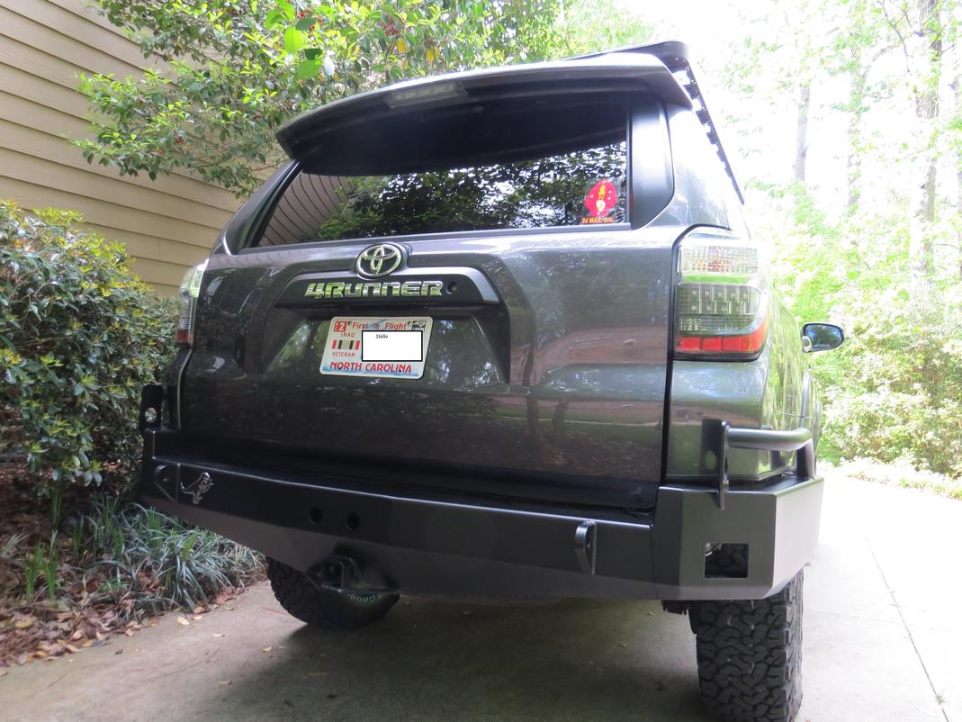

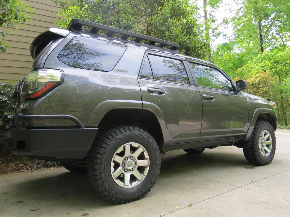

Hello all,
Long time lurker here finally posting. This is my 3rd 4runner, '84....'03...now '14. Thanks to all members who posted on the Toytec lift, and CBI bumper install....I could not have done it without those posts. Here she is....
Toytec Boss lift with HD rear coil, CBI Bumper, 20% Tint, FrontRunner rack, 275/70 BFG All-Terrain KO2.

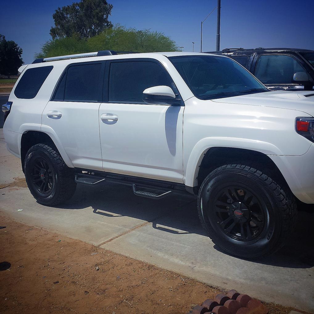

2015 te
2015 Trail Edition
Revtek 3 inch suspension lift kit.
Cooper Discoverers ATP 285 70 17
Nerf Bars
MB wheels

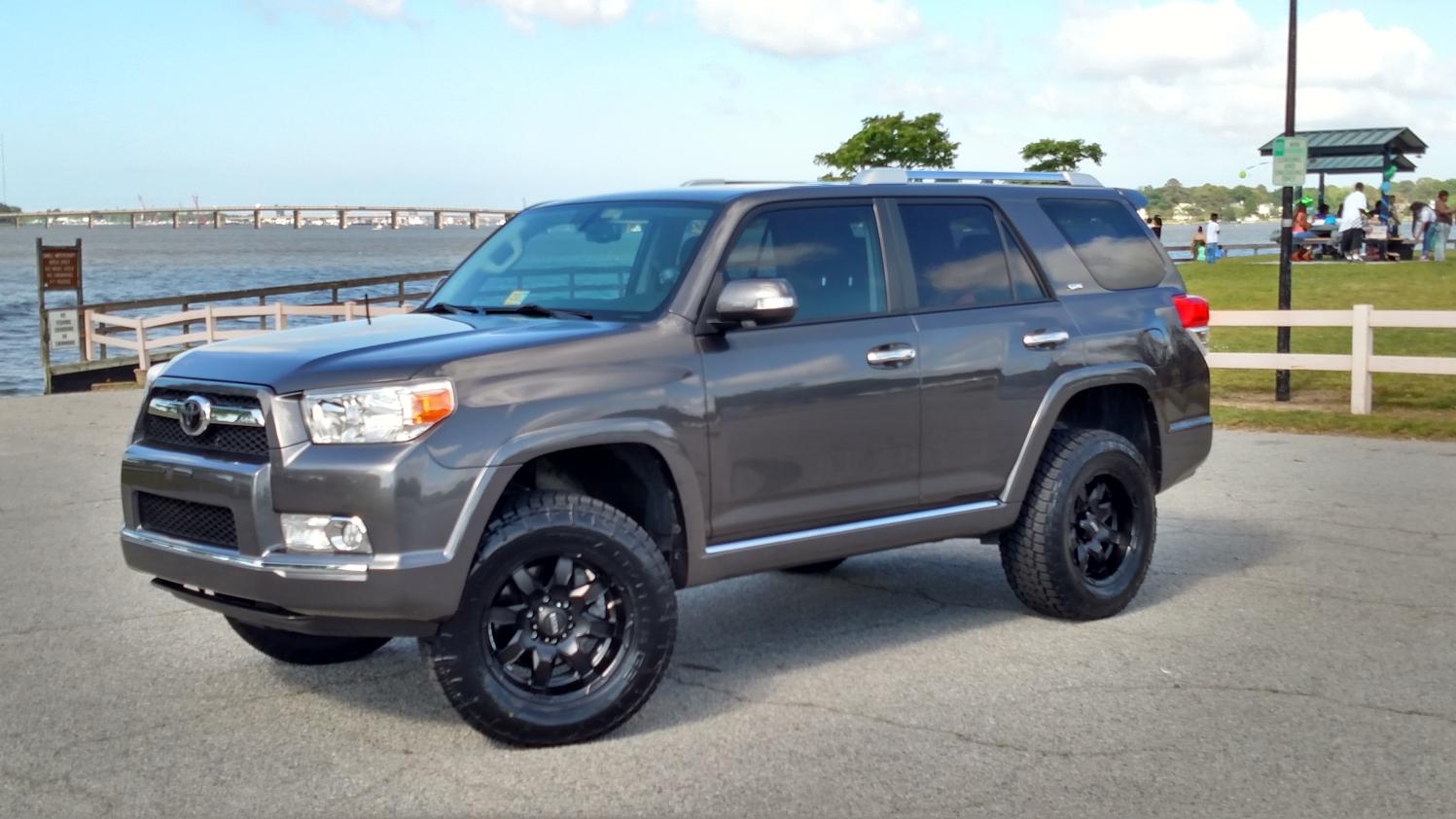

Getting there
Another 3" lifted 4runner!!!!! 18x9 -12et w/ 285/65/18's

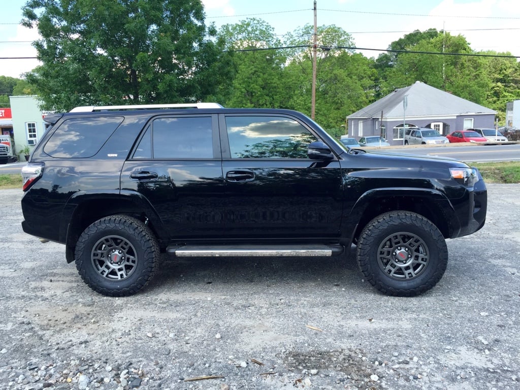

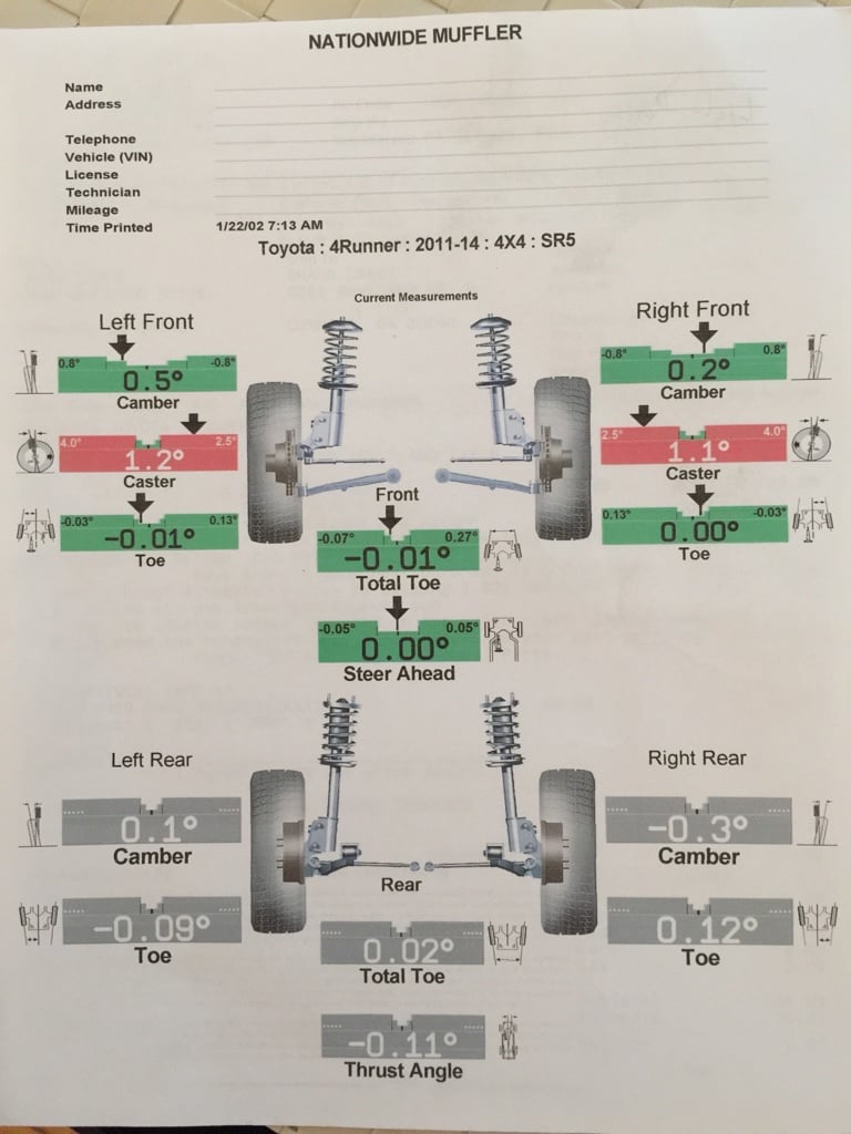

How about another T4R with Bilstein 5100s + Daystar 1.5! 275/70/7 KO2s on Gray TRD Pro wheels.
Unfortunately they told me I need new UCA's to get to factory spec alignment. They got close enough to get me by, but I guess I gotta go shopping now for more stuff to blow money on lol.

What setting are you on? Doesn't seem right? I'm on 1.75 setting and my caster numbers are around 2.6-3. Maybe they were trying to sell you some to make an extra buck?

I'm all the way up at the top setting, so 2.5 I think? I didn't get the feel that they were trying to sell me anything. They made it sound like it was pretty much fine to drive as is, but on the highway at speed it might be looser than it was before. I haven't had a chance to test it out past 60 mph yet though.

I'm at 2.5" and @ 2.6 caster. 99% of the time, they should be able to get it in spec. Find a more experience alignment guy.

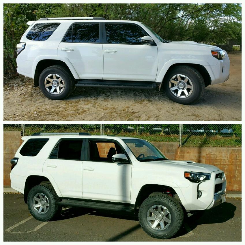

Seems to be a popular combo right now, Toytec Boss 3", Light Racing UCA's, on BFG AT KO2's. Here's a good before and after.
