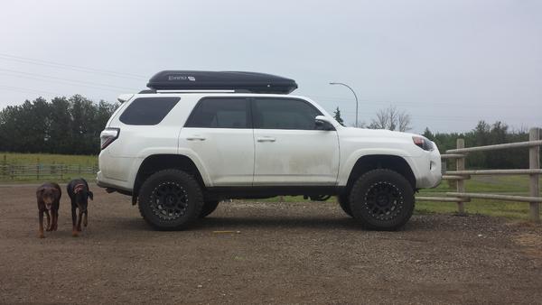

[MENTION=107484]Segarspr[/MENTION] what are the specs on lift/tire combo? I have a '15 Limited and am looking to do something similar to this.
Finally after a full year of reading this thread I pulled the trigger on a lift and tires for my '14 Limited. With a friends help it took us right at 4 hours to install the lift. Thanks to everyone on T4R.org for the great posts making this happen.
Bilsteins all the way around. Fronts set to 2.5 with Toytec spacers on top to make it right at 3". Toytec Superflex springs in the rear. LR UCA's (a must have) and Spidertrax spacers. The tires are 275/60r20 BFG KO2's. So far I really like these new KO's. I remeber people saying that pictures didn't do these lifted 4Runners justice. They were right. It's way more impressive in person!
Thanks for info, since you have a Limited, im assuming you removed XREAS?
Hows the ride quality compared to before?
