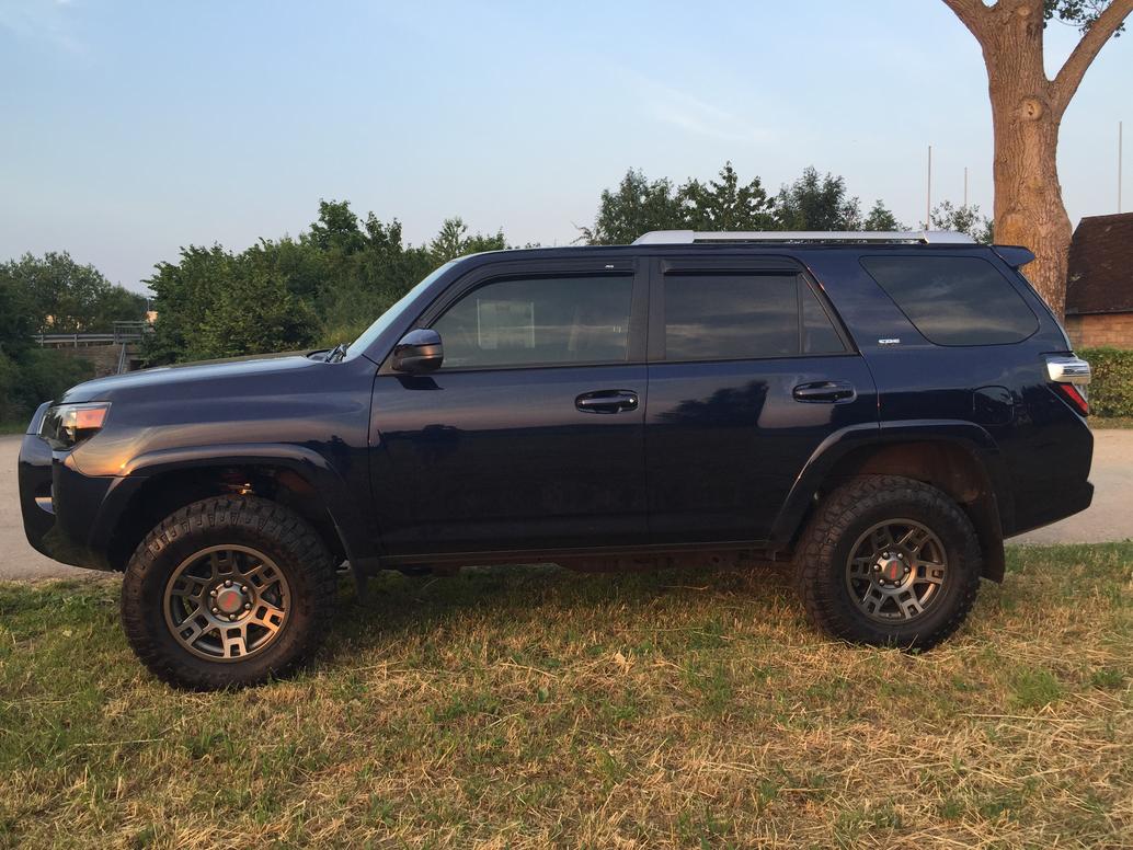

Toytec Boss 2", w/ LR UCA

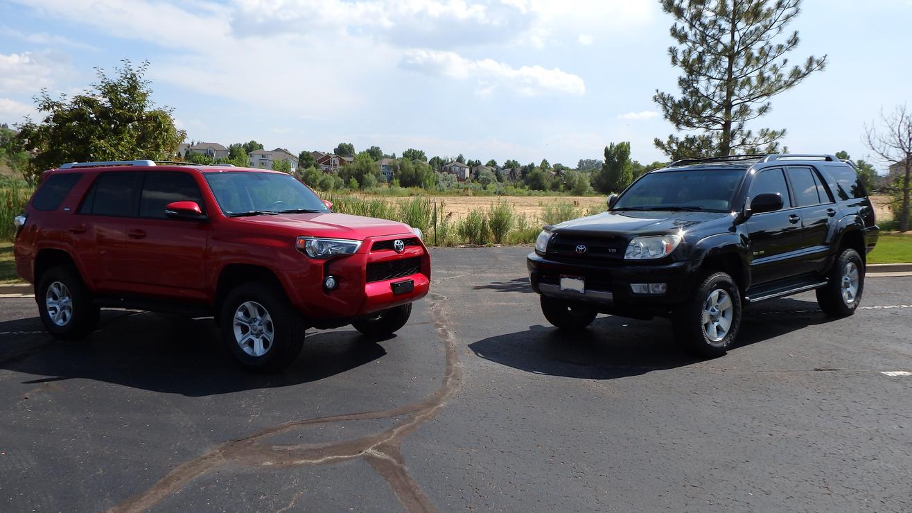

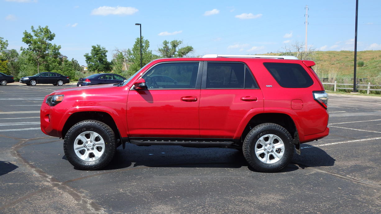

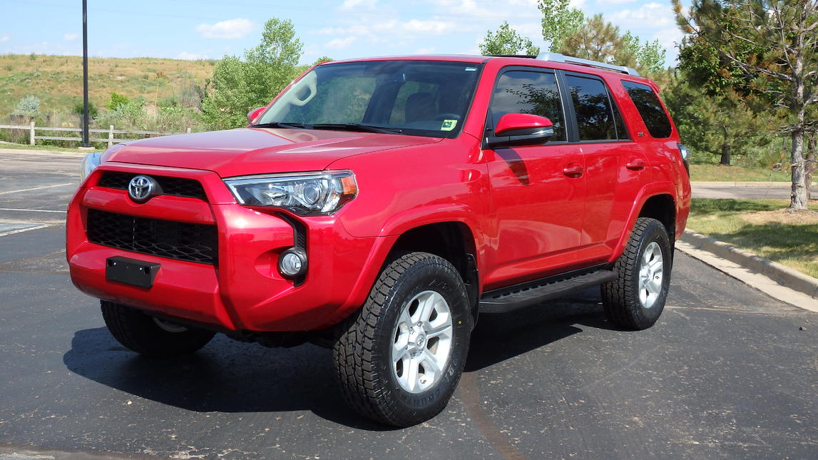

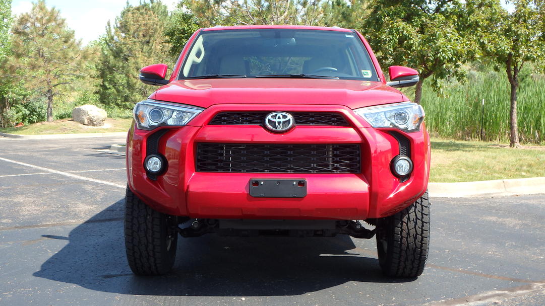

new 2015 lift
2015 sr5 prem. and new lift. Bilstein 5100 front and back with front's set at 1.75" (3rd notch from bottom), cornfed 1" rear spacers. Toyo open country AT2's. Spidertrax spacers. The 5100's made such an improvement in the ride.
I am now wishing I had the fronts set at 2.5" for a little more leveling and lift in front - which I might still do, but was concerned about having reverse rake. Right now I have about a 1" rake. The 2003 is an OME lift, with toytec rear flex coils done some time ago (now being sold to my son).
Anybody else have cornfed 1" rear spacers with the 5100's set at 2.5 up front? Diff drop needed ? Reverse rake? Or maybe toytec 1/4" spacers up front?? thanks.

you won't need a diff drop, and you already look like you have aa bit of reverse rake to me
