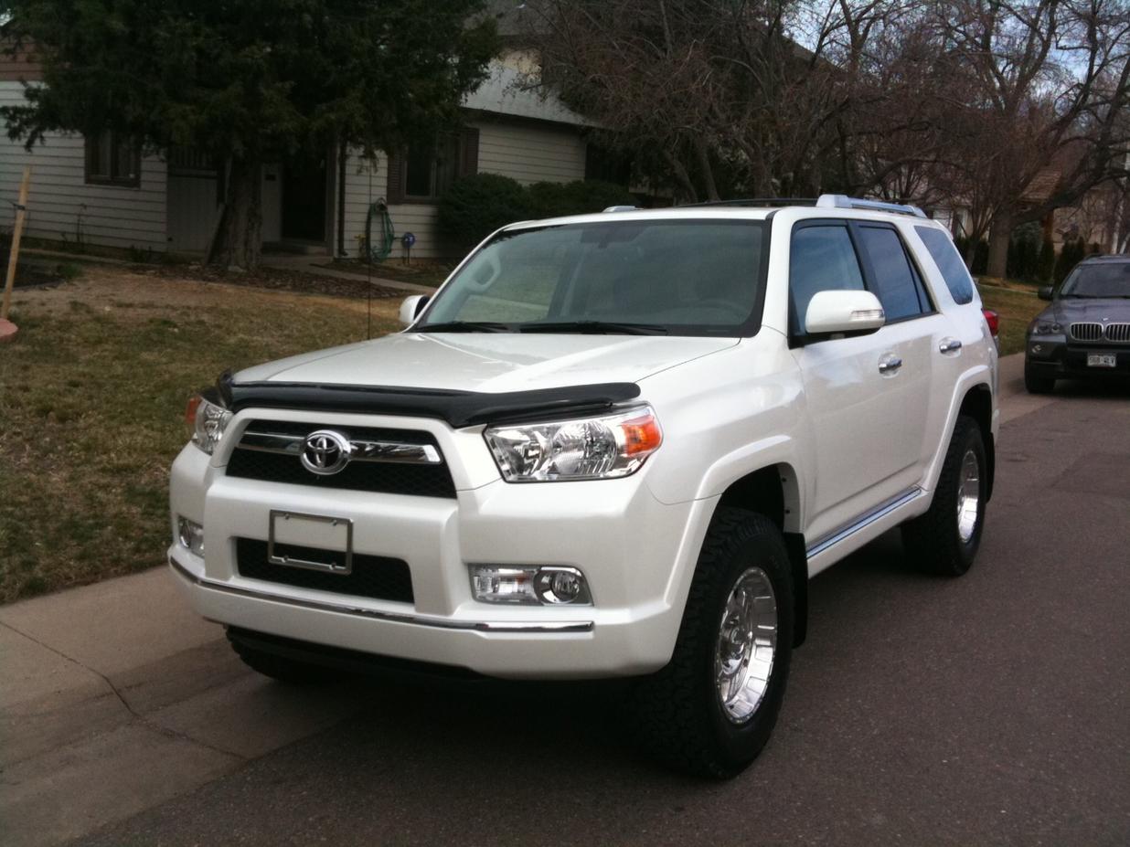

Your truck looks fantastic. I am hoping to go with a very similar setup in a few months. How much rubbing did you experience with the 285 Duratracs on the stock wheels?
Thanks man! It's my first lifting attempt! As far as the rubbing there is none at all actually! Even with at extreme angles it's all good!
Road noise is a bit louder than the all terrains. Guessing mostly has to to with the tread lugs that are 22/32" deep. Deepest I've ever seen on a tire. I figure it will quiet down over time.
Yes, third set I've bought.

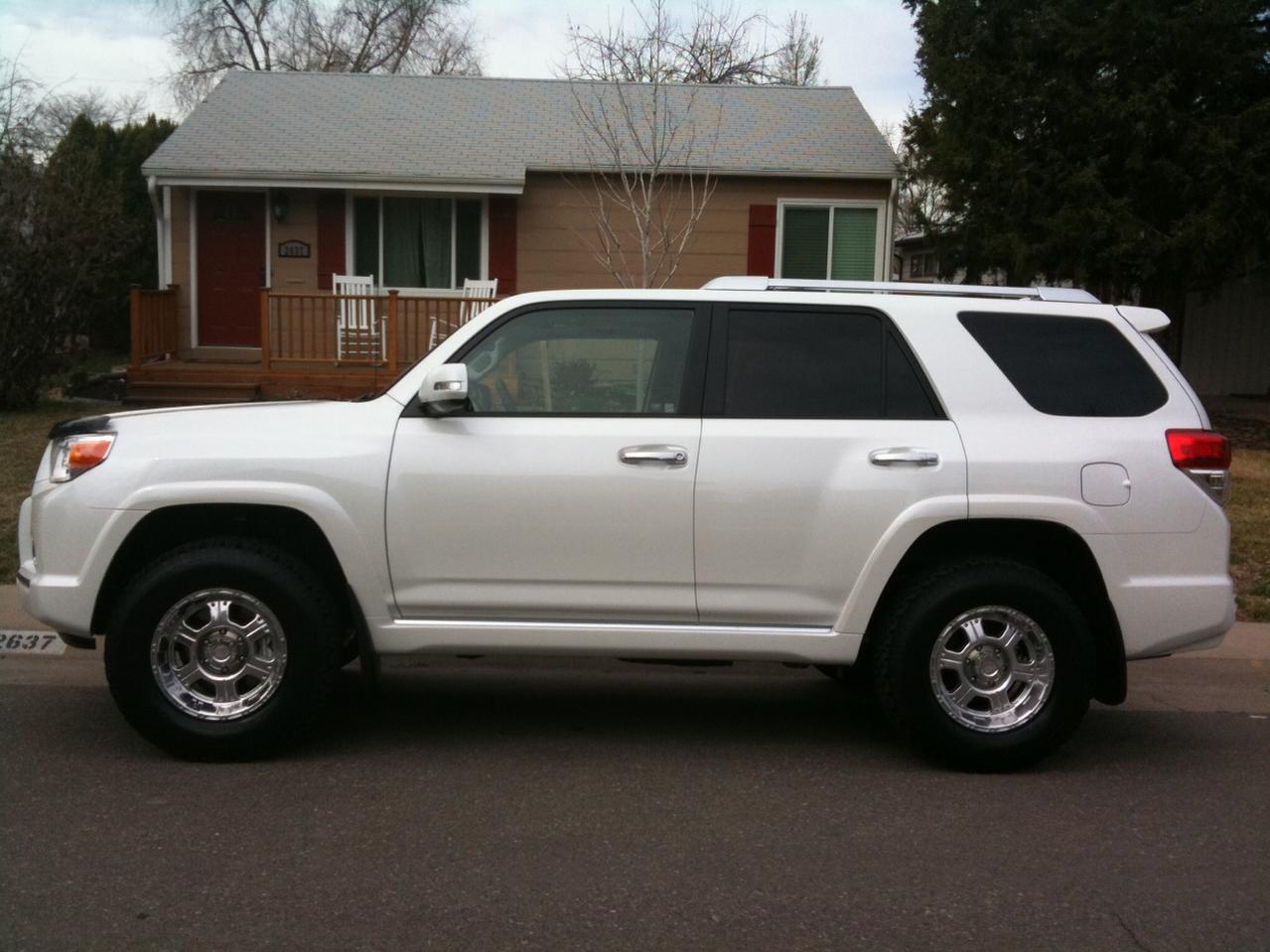

Here is my 2011 SR5. See signature for details.
