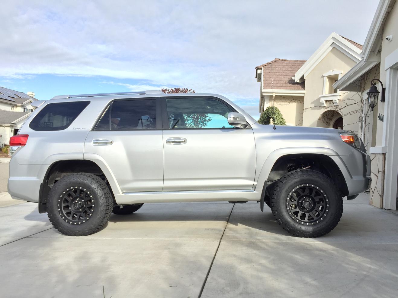

Woot woot! I can finally post my baby here. :hello:
Toytec 112-620 coils in front on 5100s @ 0" w/ 1/4" spacers on each side. 5100s and 1.5" Daystar spacers in the rear. About 2.25" in front now, should settle around 2" in a bit.
Got it installed by Toy-Crawlers in Broomfield, CO.

Looks really sharp, congrats! Why'd you go with the toytec coils up front vs stock? and if you don't mind, what did it run you for parts and installation through that shop?
Thanks. Probably 4 reasons I went with coils... 1) the OCD in me didn't want preloaded coils while offroading, 2) wanted closer to 2.0", 3) slightly extra coil rating (620lbs) to support some extra weight, and 3) if/when I upgrade in the future (slimline bumper?) I don't have to relocate the 5100 clip potentially weakening that link because I'd keep it at 0 and maybe get an OME 885 in the front.
Install costs were reasonable compared to the 4 other places I looked at. $400 install + $200 for lifetime alignments. While I probably could've done it myself, with 3 kids and a wife, alone time is at a minimum.
I like the way that looks! I just priced everything you have in your lift and I got roughly $630 with shipping and all! Saves me $300 or more from the Toytec 3" kit!
May just be doing this!
