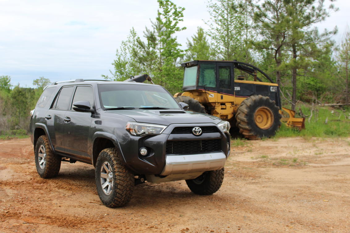

Awesome. I had 255 MT's on my 4th gen. Wasn't thrilled with the stance it gave the truck but I think they look great in your pics. How do you like them?
They're great for what I do, 50/50 gnarly trails and highway driving, the tires also measure out to a true 33"s! I had the 255/85 pizza cutters on my '96 and they did better than the 285/75's I had before, I also need full articulation so I can't go too wide and still be 100% useable. If I didn't do as much Offroading I would have gotten the K02's.
yeah, i'm not into wheel spacers personally but i think they'd make the pizza cutters look just right.
that said, your Trail looks really great. love it. :thumb3:
I'm also not a fan of wheel spacers, so I went with an aftermarket wheel with a -10 offset to make them stick out and fill the wheel well better. That and they are 8 inches wide, so my "pizza cutters look just right".

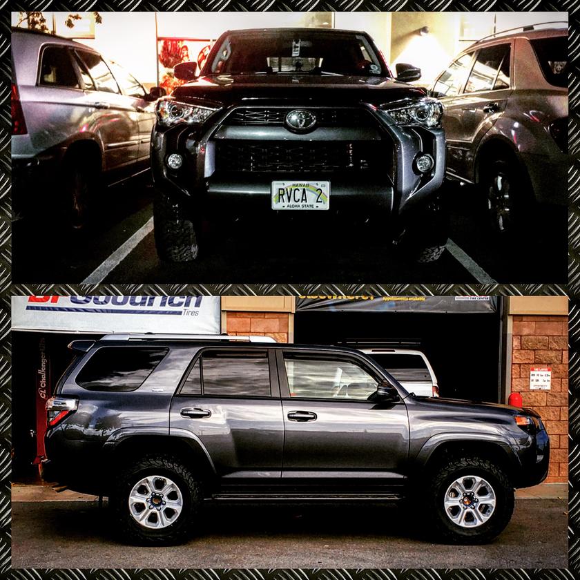

my new Te with KDSS.. lifted on bilstein 5100. 1.75 front, 1 inch cornfed spacers in the rear, 275/70/17 bfg at.. all done the first week I had the 4runner thanks to the forums, previous ride, 2012 jeep wrangler sahara lifted on 33's

Im thinking of doing the same suspension set up. im picking our 4runner up this week. How do you like the ride? can you post some more pics

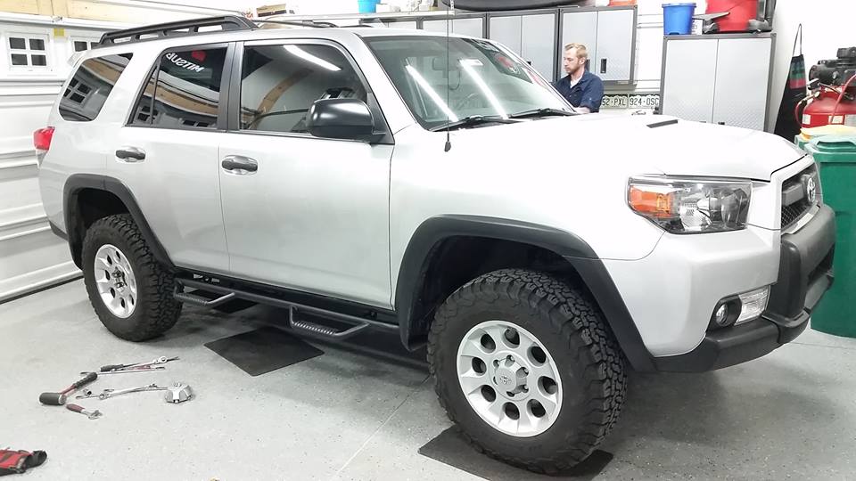

I just installed this same setup (5100 bilsteins the front set at 1.75" and 1" cornfed rear spacers). I got my alignment today and drove it around and so far am really liking the ride quality. As many with this setup have mentioned, the nosedive during breaking is gone. It appears to have very little rake and overall looks much better. I couldn't be happier with it so far! I think I will like it even more after I put on some 1.25" spidertrax wheel spacers and bigger tires.... Muhahaha

Beautiful rig

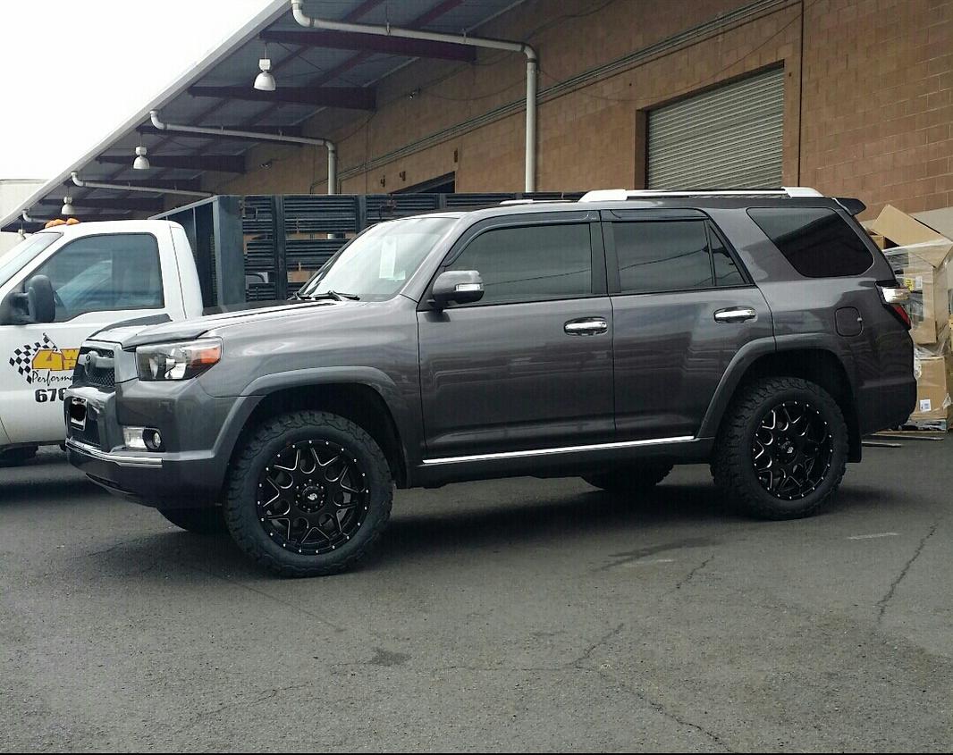

Bilstein 5100s all around fronts [email protected] / 1"cornfeds rear (Done)! Got some new shoes 20x9s along with some BF KO2s (Done)! Next mod: planning to set fronts at 2.5 along with upgrading rear spacers to 1.5

Great looking rig!

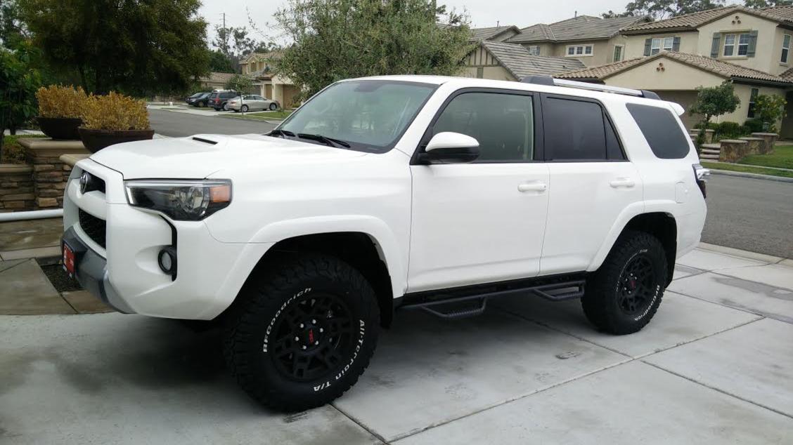

Finally got the Toytec springs and Total Chaos UCA's installed with Icon 2.5" remote reservoirs all the way around. What a difference rear springs make! It's sooo smooth now. New tires are coming next. :) This is near Panama City Beach FL last week. Also got some weathertech's which are great for the beach!
