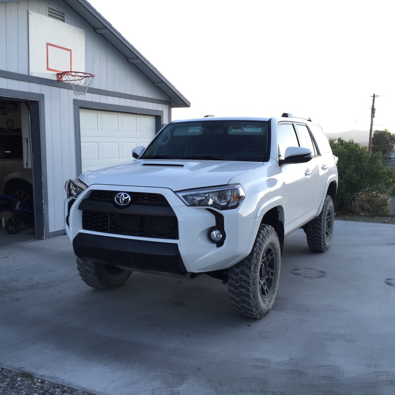

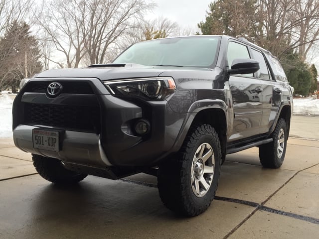

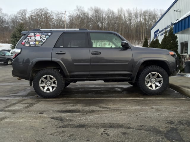

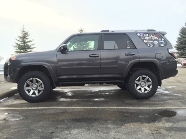

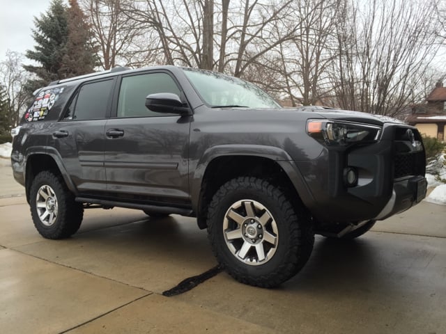

Just fits in the garage until the tent goes on for the summer

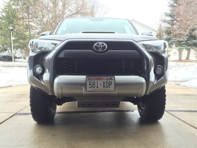

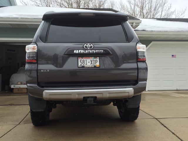

Bilstein 6112 up front
Icon 2" springs in back
Toytec boss remote resi shocks
285 tires
My Bilstein 6112s set on the 3rd clip in front for 2" of lift, the rears have Icon 2" lift springs paired with Bilstein 5100 shocks. Like the look, love the ride!

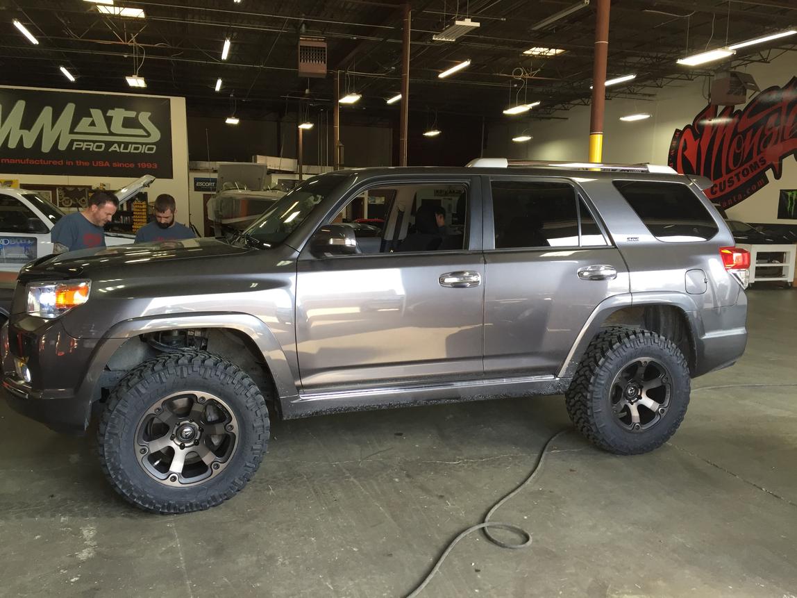

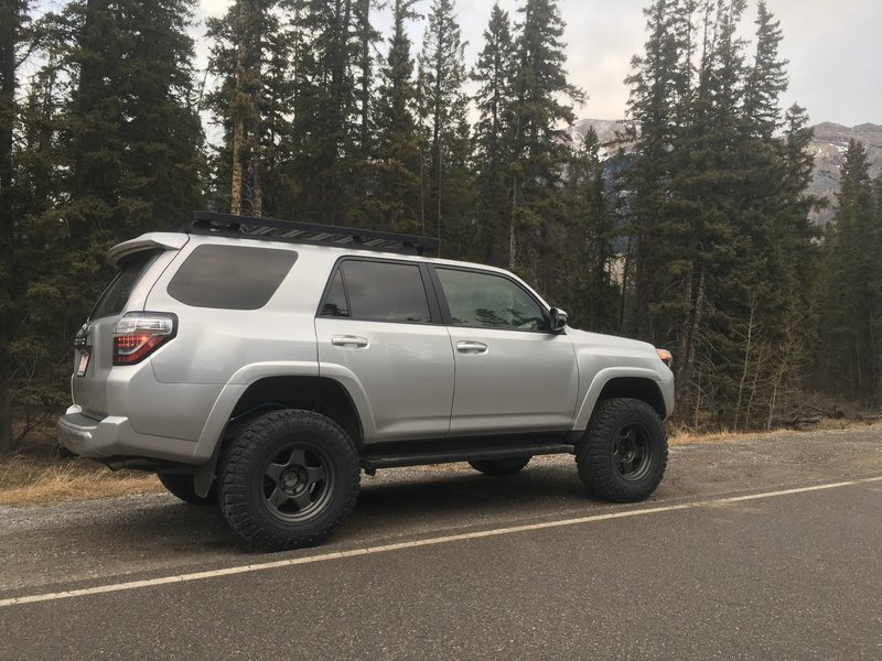

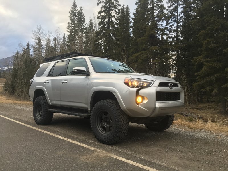

After about 8 months with my first 4Runner I finally got around to some mods. 3" lift with new Fuel Beast 18's with Nitto Trail Grapplers. In the process of blacking out all the chrome. Next will be N-Fab nerf bars then Gobi Stealth Rack.
2010 SR5 | 3" Daystar | Fuel Beast 18x9 | 285/65/18 Nitto Trail Grappler

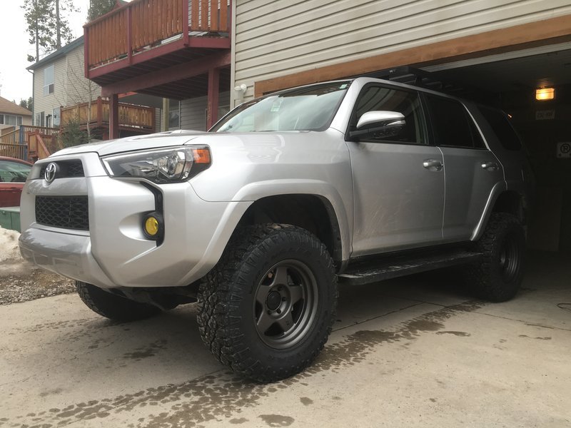

I struggled to get the ride height the same with my 2015 TE. I've got the Toytec Ultimate 3" lift kit.
There's a difference in the stock spring rates between the left and right sides. From my notes it lists the front right rate at 590 lb/in and the front left at 600 lb/in. That implies that the front left is heavier than the front right. Thus if your new springs are the same rate than you'll have to raise the left side spring perch to level the ride height.
