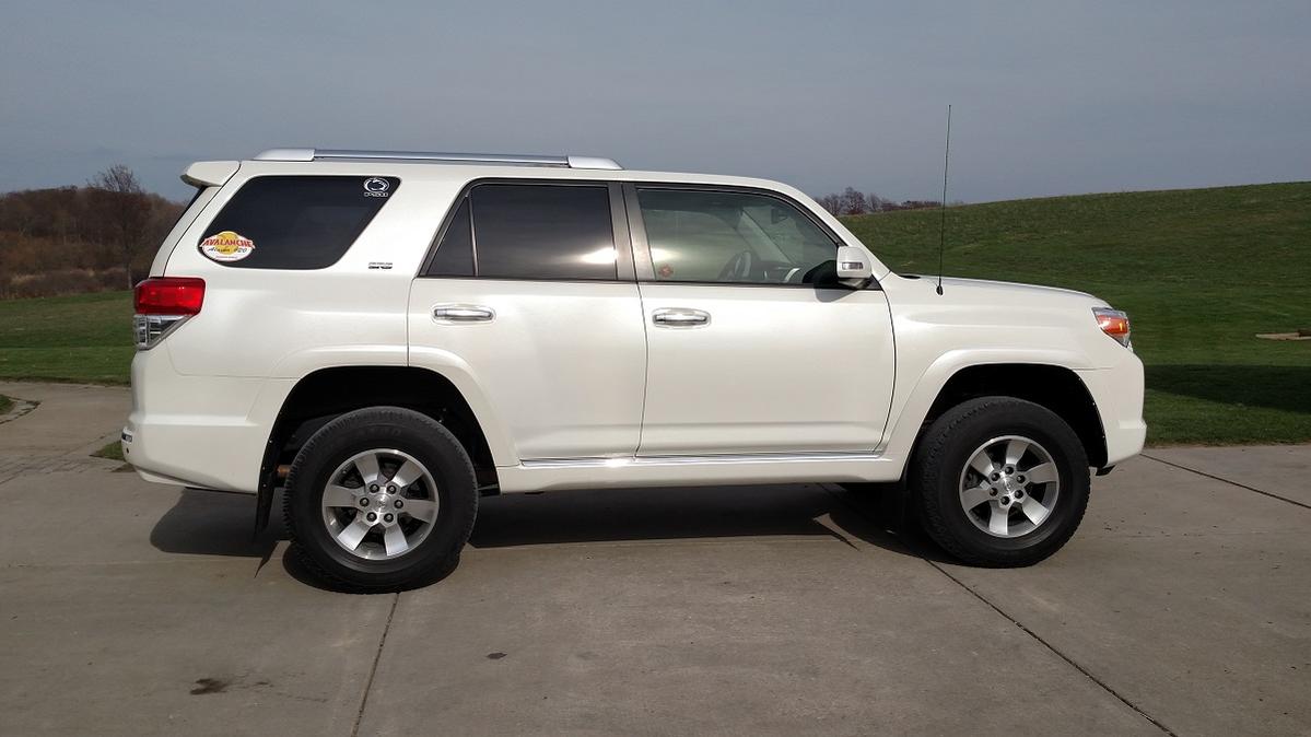

2012 SR5 with 5100's all around, OME 884's at 0 up front and a Daystar 1.5" spacer out back. I'll switch to rear springs when a true 1.5" lift spring is available for the 5th gen's. Top photo is stock, bottom is a week later.
I'm not going any bigger on tires as I do 98% on the road (fuel mileage is priority) and 2% on our cabin dirt road.
Stock it had 37" ground to fender opening in the rear and 35" in the front.
Just off the neighbors garage lift, (yes he has a Rotary electric two post lift in his barn/shop) we were at 38.5" in the rear and 39" up front. We adjusted the toe in so it would not rip the tires to shreds going to the alignment shop. Immediately after the alignment it had settled to 38 up front. Now it's been a week with the lift installed and alignment done (caster is off but the ride is so, so, so much better) and now it's exactly 37.5 up front. It still has a bit of a rake which is fine. The alignment shop said bring it back after I get the Camburg UCA's in and he'll readjust it under the 6 mo/6k guarantee. I'm very pleased with the results.
