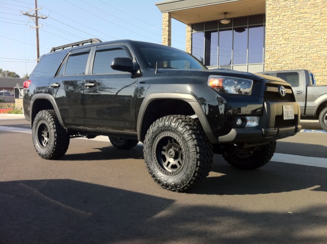

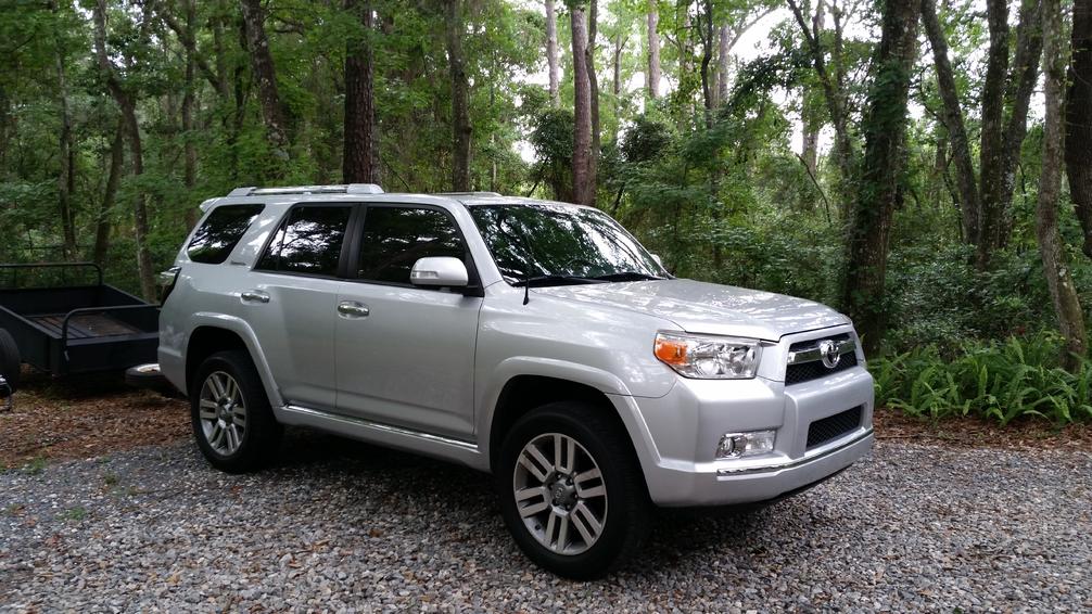

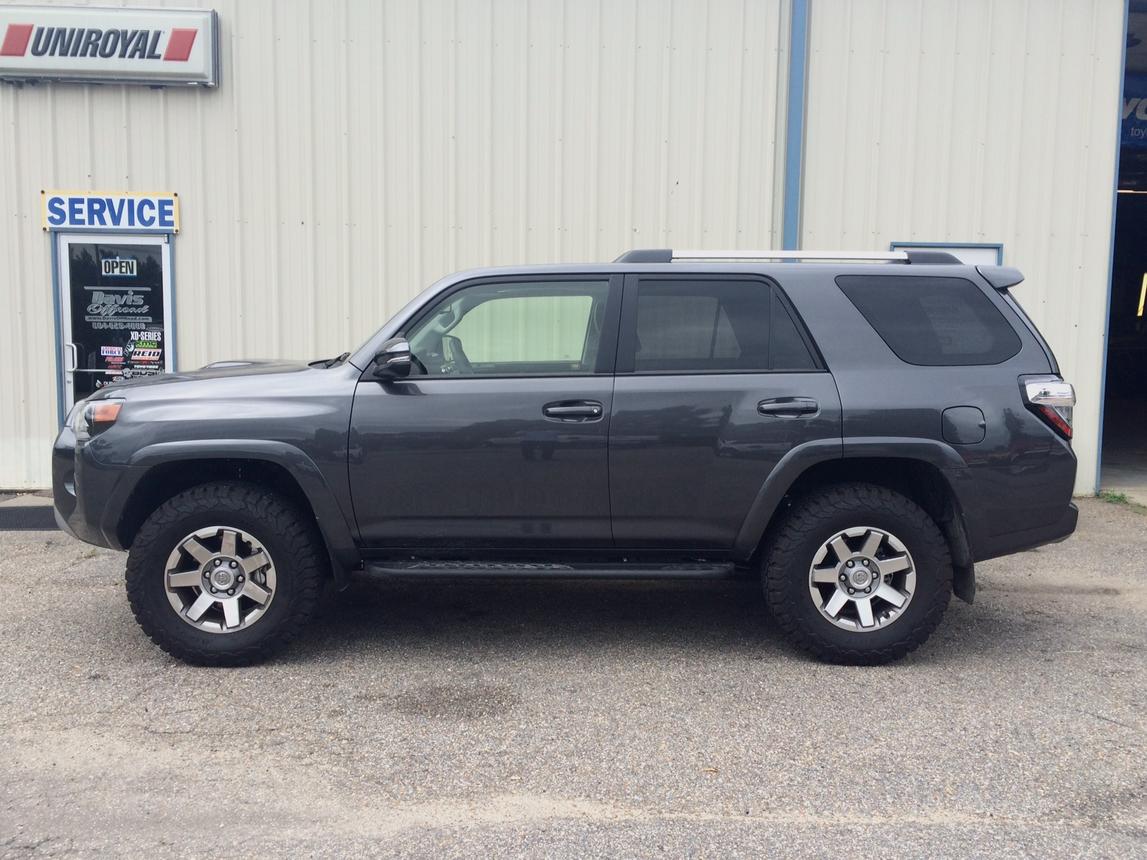

Got her lifted Saturday. Currently sitting at 3.5" of lift with 35's.

What lift do you have on there? Tire width? How bad is the rubbing?

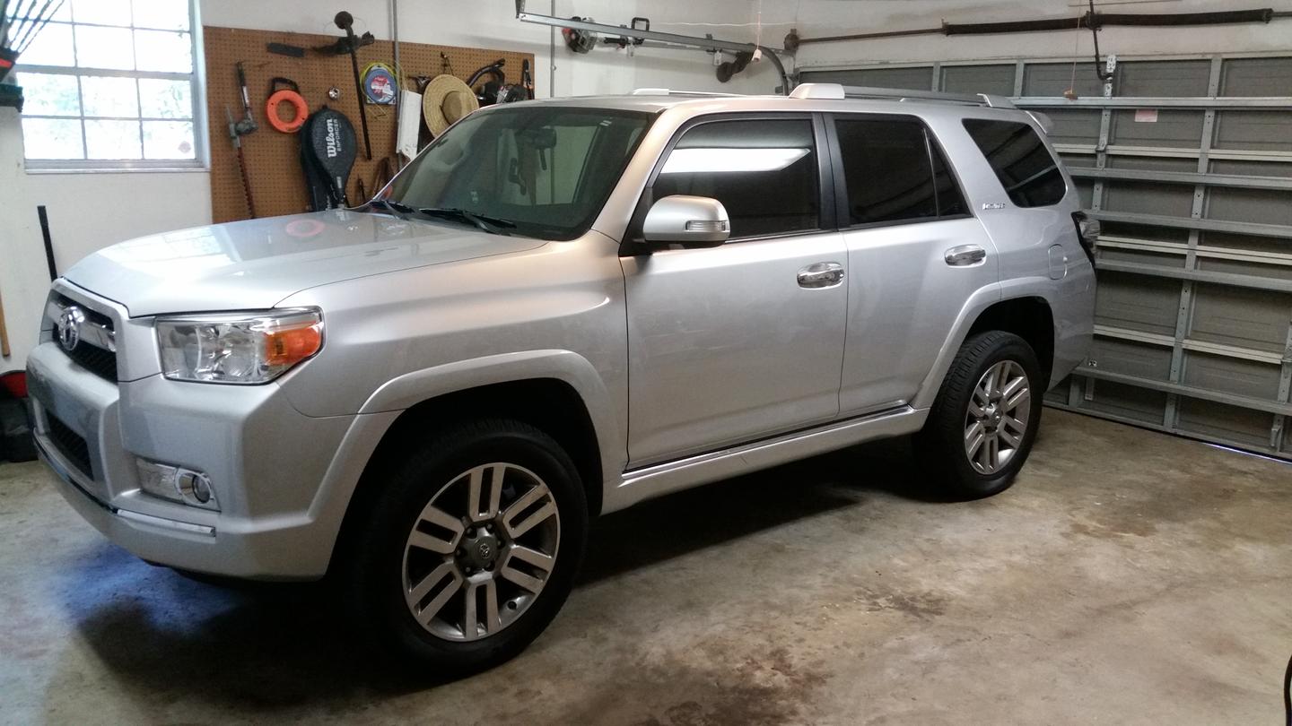

Bilstein 5100
I know its not a huge lift, but it's exactly how I wanted it and how it should've looked out of the factory. I had the Xreas before, replaced last friday with 5100's all around with the adjustables up front set to .85

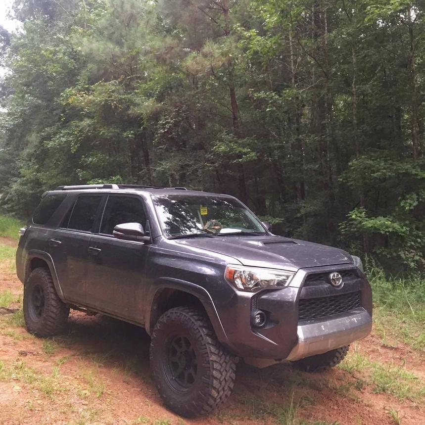

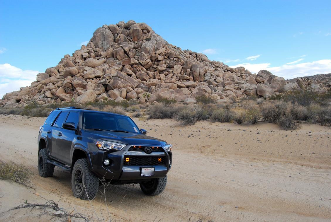

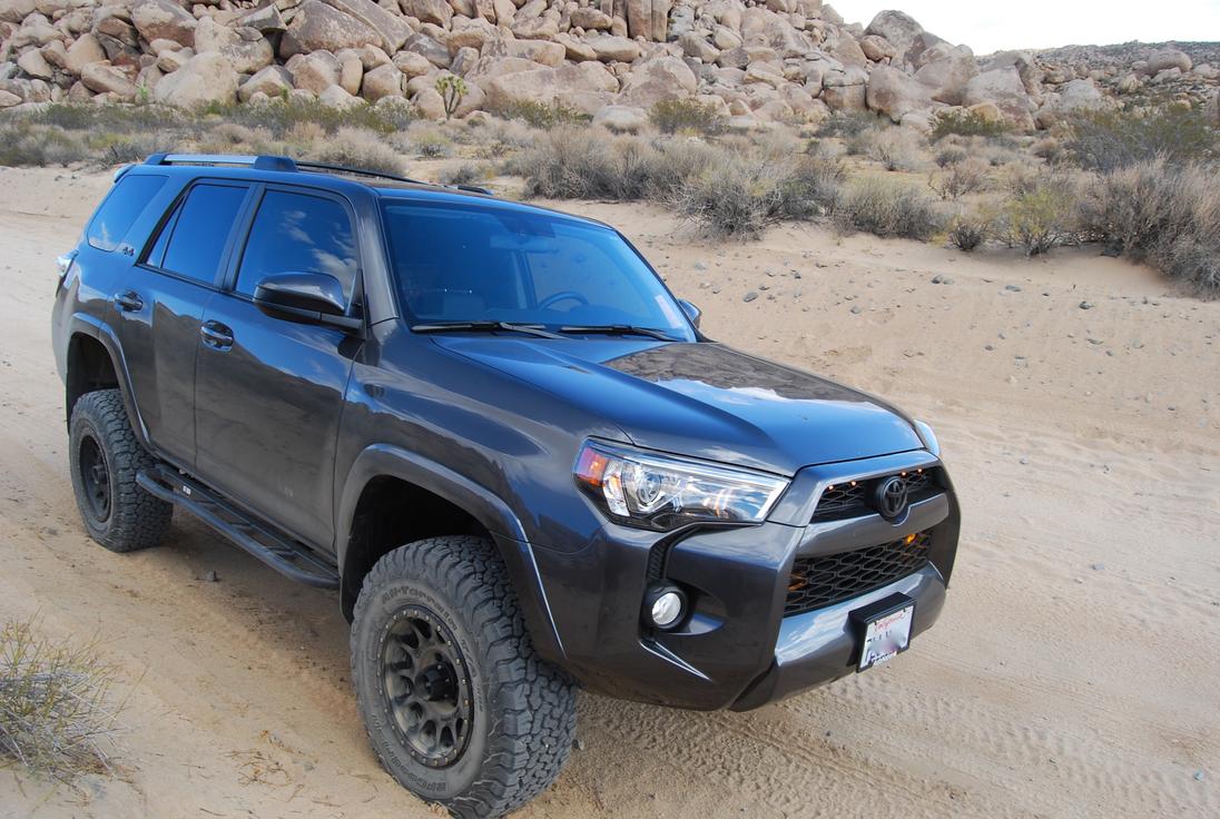

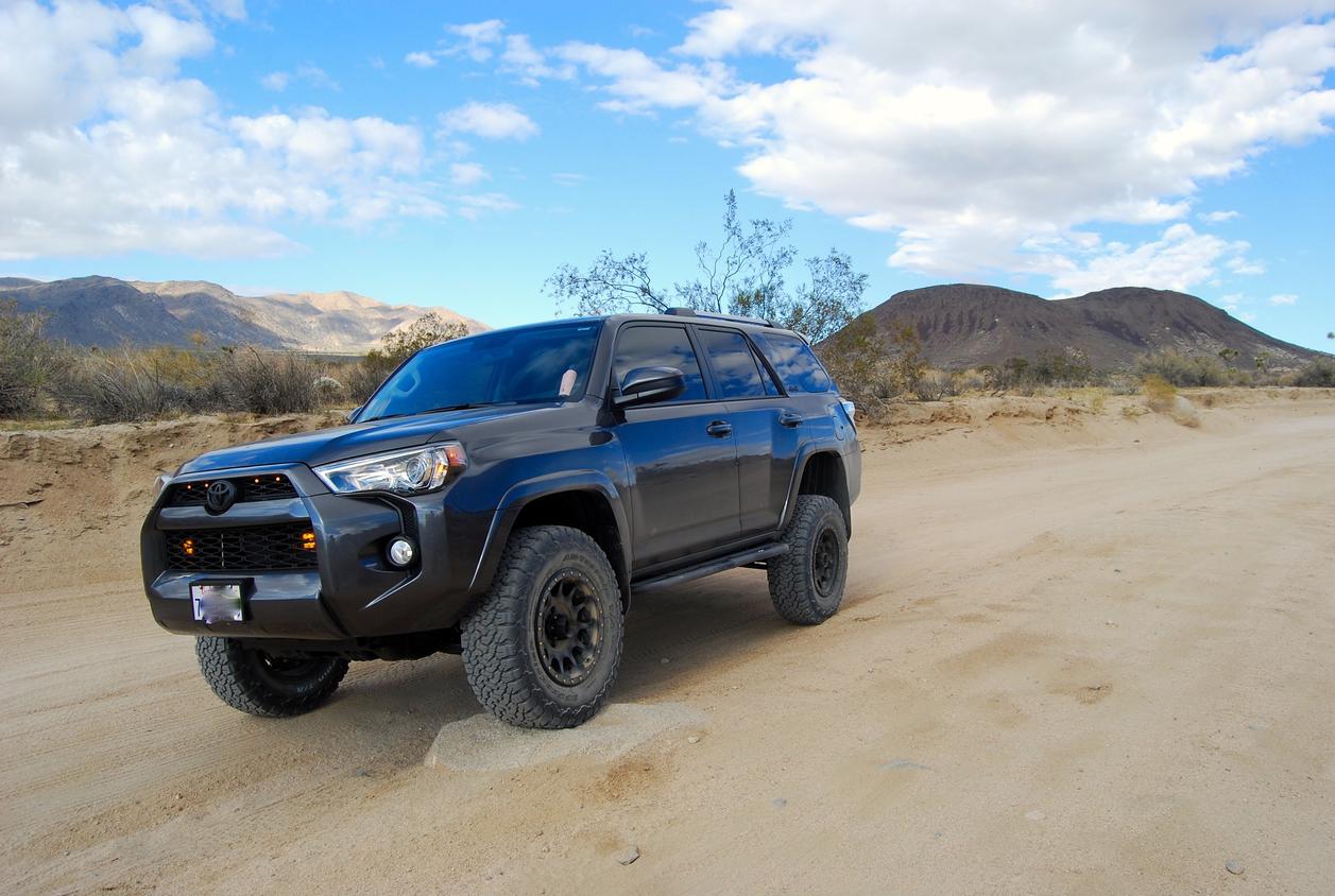

Finally able to post here! Been piecing together my setup over the last 2 months, finally got it all installed and took it out for a weekend camping trip.
Bilstein 5100s on all corners; front: OME 884 coils (2.5" lift with Bilsteins set at 0), Camburg BJ UCAs; Rear: SAW 1.5 coils
Wheels: 17x8.5" Method NV in Matte Black
Tires: BFG All-terrain K02 275/70/R17
Ride quality has DRASTICALLY improved over the SR5's mushy stock suspension. Very happy with the end result!! :becky:
man. absolutely beautiful.
(slightly off-topic, but I love the lighting accents as well! How'd you mount the SAEs?)

Can you compare the handling of your LE with the 5100s over the XREAS? Are you experiencing more body roll or nose dive with the 5100s?

I dont feel a difference. My buddy has the same year and his didnt have xreas and felt mushy had more bounce compared to xreas on mine... the bilsteins feel the same as xreas and are quality.
Thanks. I lived with the stock suspension (2010 SR5) long enough. Having been in LE's, I believe that XREAS would provide the improvements I'm looking for, so am researching an aftermarket suspension that would be the closest thing to having XREAS.
you're welcome. BTW, I've never experienced the drastic nose dive that ppl talk about with xreas or 5100. My 4runner dives less than my old 2013 WRX...

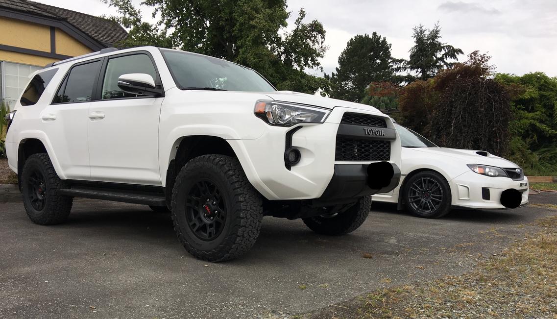

Icon coilovers set at about 2" of lift and 1" cornfed spacer in rear

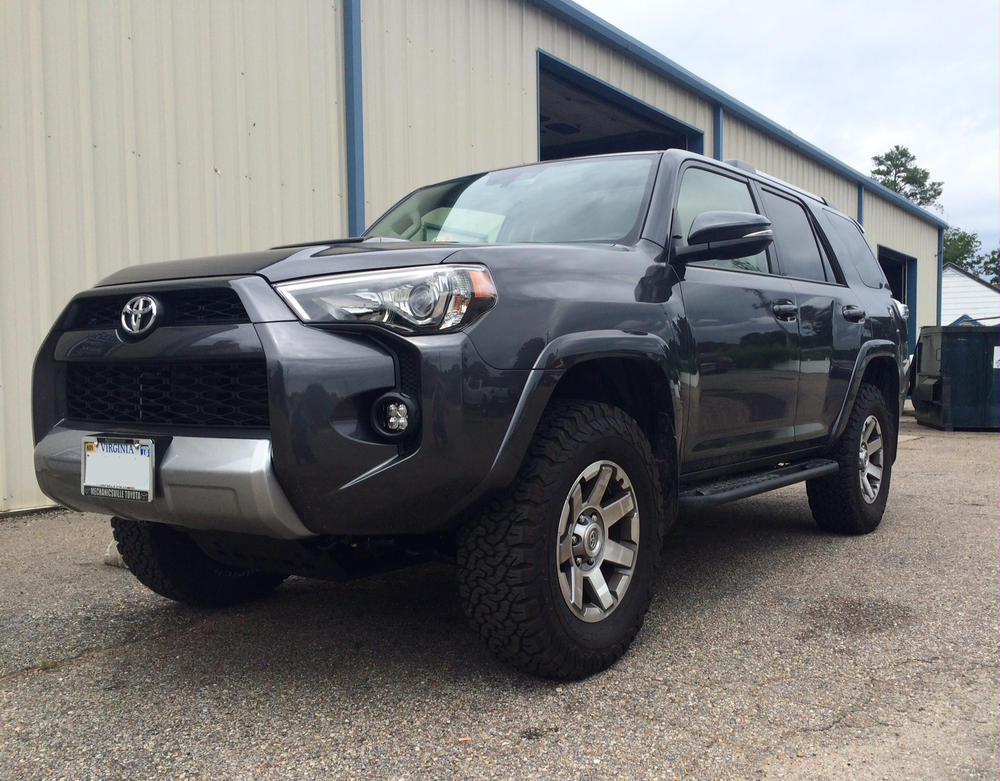

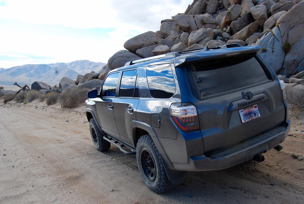

This thread inspired me to replicate something similar except with Bilstein 6112/5160's. Unfortunately, I didn't take any measurements or pictures beforehand, but I'll try to answer whatever questions I can. Here's the set up:
Tires: 275 BFG KO2's
Front: Bilstein 6112 set on 3rd clip
Rear: Bilstein 5160 with custom Deaver coils that are 0.75" taller (will result in ~1.0" of lift) & 15% stiffer than stock
Like I said, I didn't measure, but I think I got 2" in the front and 1" in the rear. Definitely accomplishes the moderate lift/level I was going for. It looks close enough to stock that it won't catch the attention of 'commoners' but is still lifted enough where there should be marked improvements in off-road performance.
I also got the shop to throw Airlift airbags in the rear, but since they have minimal pressure in them, they shouldn't have any impact.
