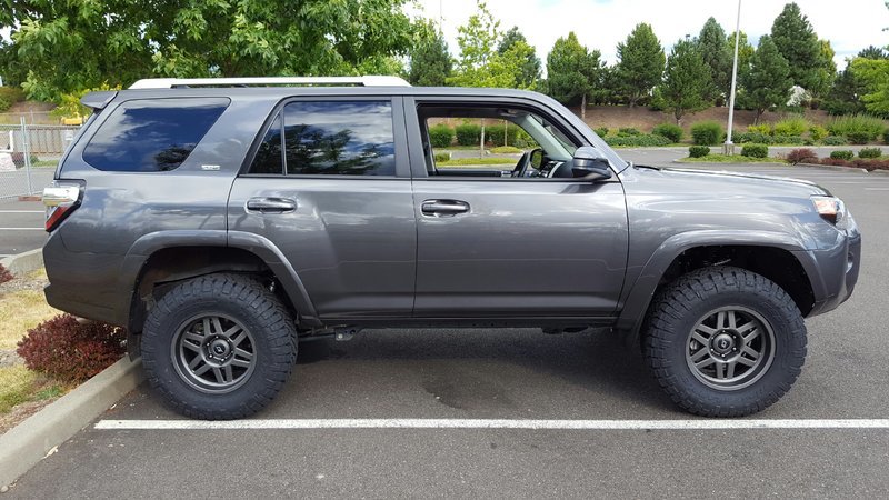

I posted this in a different thread, but I figured it needed to go in here as well for reference purposes.
This thread inspired me to replicate something similar except with Bilstein 6112/5160's. Unfortunately, I didn't take any measurements or pictures beforehand, but I'll try to answer whatever questions I can. Here's the set up:
Tires: 275 BFG KO2's
Front: Bilstein 6112 set on 3rd clip
Rear: Bilstein 5160 with custom Deaver coils that are 0.75" taller (will result in ~1.0" of lift) & 15% stiffer than stock
Like I said, I didn't measure, but I think I got 2" in the front and 1" in the rear. Definitely accomplishes the moderate lift/level I was going for. It looks close enough to stock that it won't catch the attention of 'commoners' but is still lifted enough where there should be marked improvements in off-road performance.
I also got the shop to throw Airlift airbags in the rear, but since they have minimal pressure in them, they shouldn't have any impact.
Perfect. I love the look of your setup.....goals.
Sorry man lol, I didn't know if that was a typo or not.
But I just saw the other picture you posted and I can tell from that view.
I was just making sure cause I'm about to make the same move. Beautiful set up! Are you on Instagram?
Thank you! Can't go wrong with 35's IMO. You can follow my build @project_recon on Insta.
