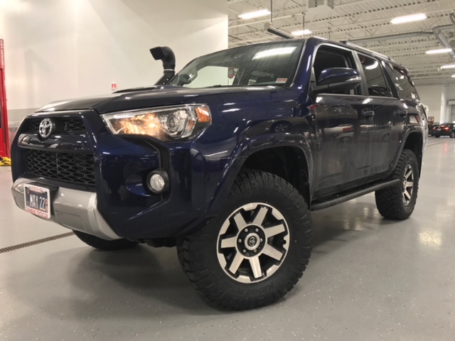

Bilstein 5100 1.75/1
Here is mine! Sitting on BFG KO2 275/70R17. A local shop did the install, mounted the tires, and aligned the vehicle for 300 + tax.

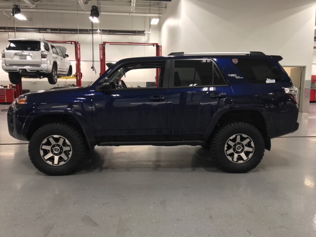

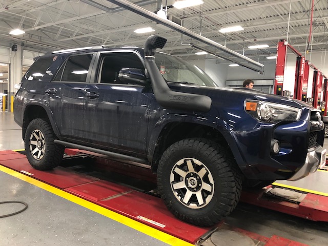

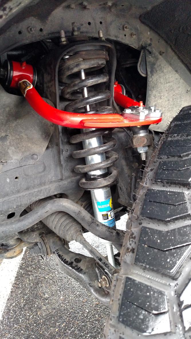

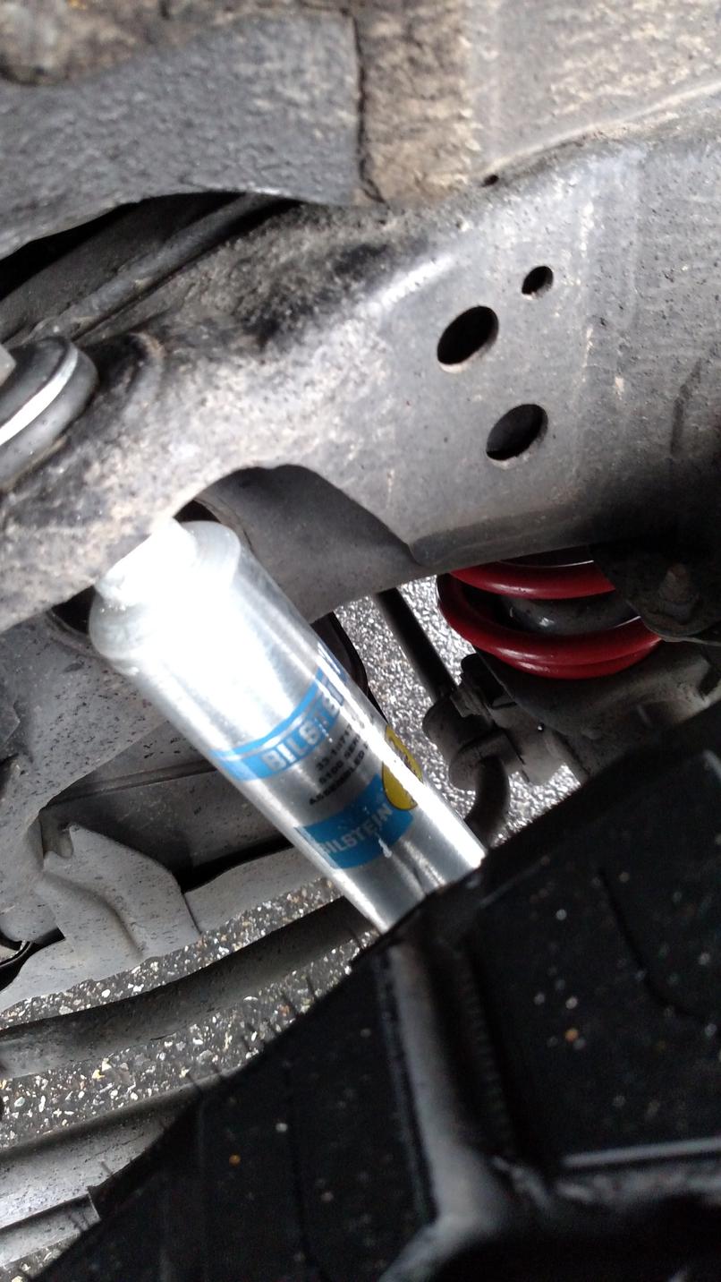

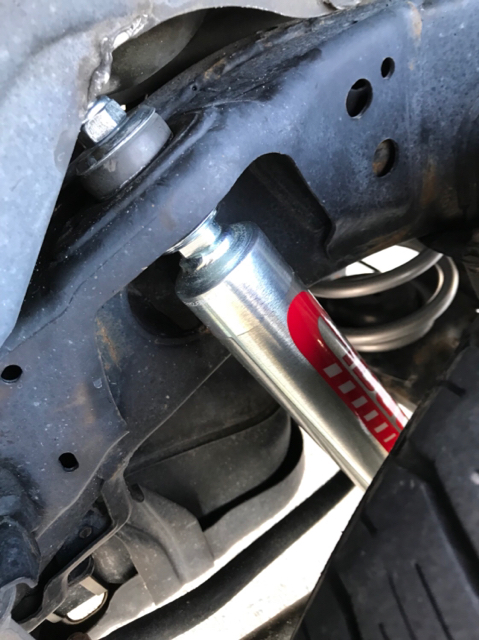

Front:
5100s @ 2.5"
Toytec 1/2" top plate spacers
JBA Upper control arms
Rear:
Icon 2" superflex rear springs, painted red
2" extended 5100s
Install went ok, besides breaking an abs wire while trying to get the 5100 in on the passenger side. Had to solder it! I had a ready lift 3"/2" spacer lift before and this setup is 1/2" higher up front and about 1/2" higher out back. Might settle a bit, but over all it looks and drives great!!!

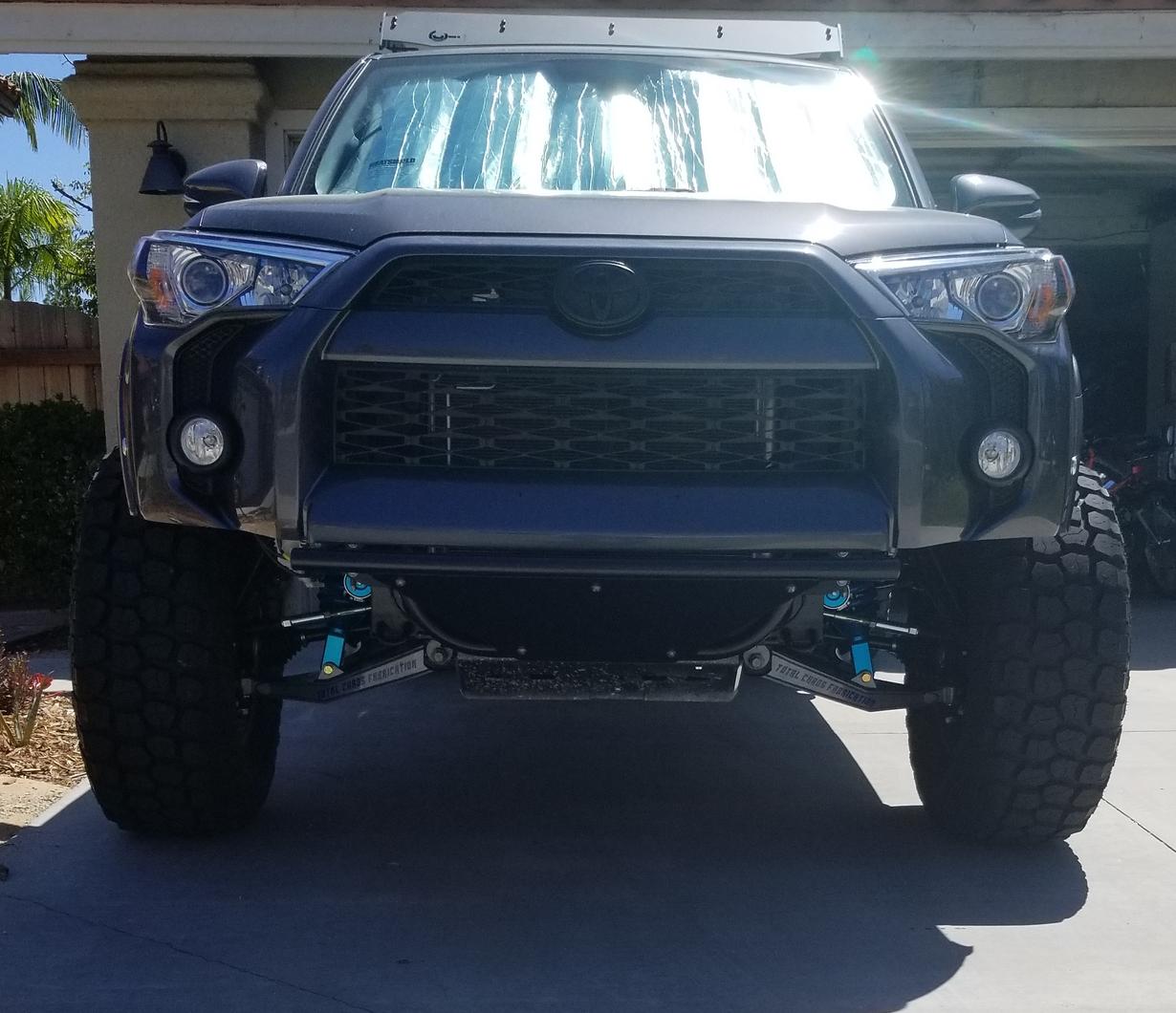

3.5" over TC kit...with a custom bumper, major fender trimming and a bunch of other stuff.
