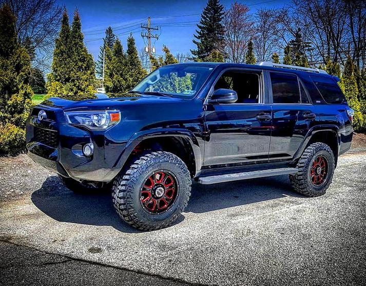

Lifted.....
These came in yesterday. Spent a few hours yesterday doing the rears, than after kids soccer practice got the fronts on. Sure woulda loved a lift! And another set of hands!! Still has a bit of a rake.......something that maybe a nice new Pelfreybuilt bumper could help with! Also need to go from the 275s to the 285w....Heading for an alignment Monday.

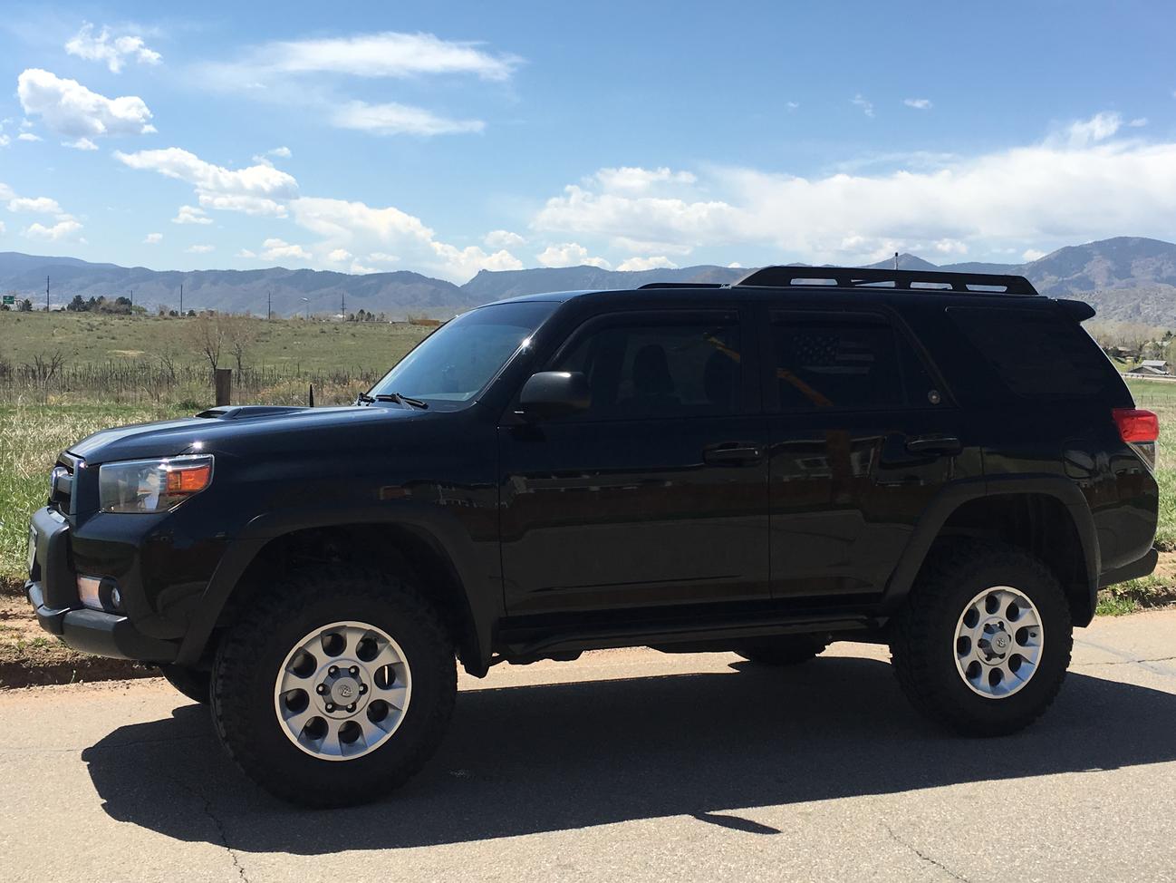

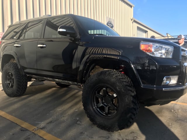

Here is my Toytec Ultimate lift. Really happy with it! Build thread coming soon.
2010 SR-5, Toytec Ultimate lift with BMC, SPC UCAs, FN Six Shooters, 285/75R17 Nitto Trail Grapplers, SSO Sliders, RCI skids, CBI ditch light brackets, Yakima Megawarrior rack

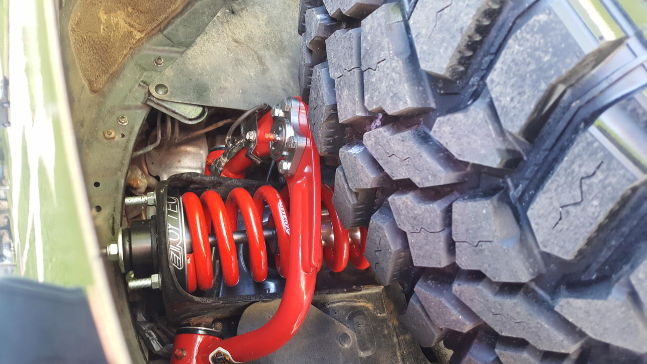

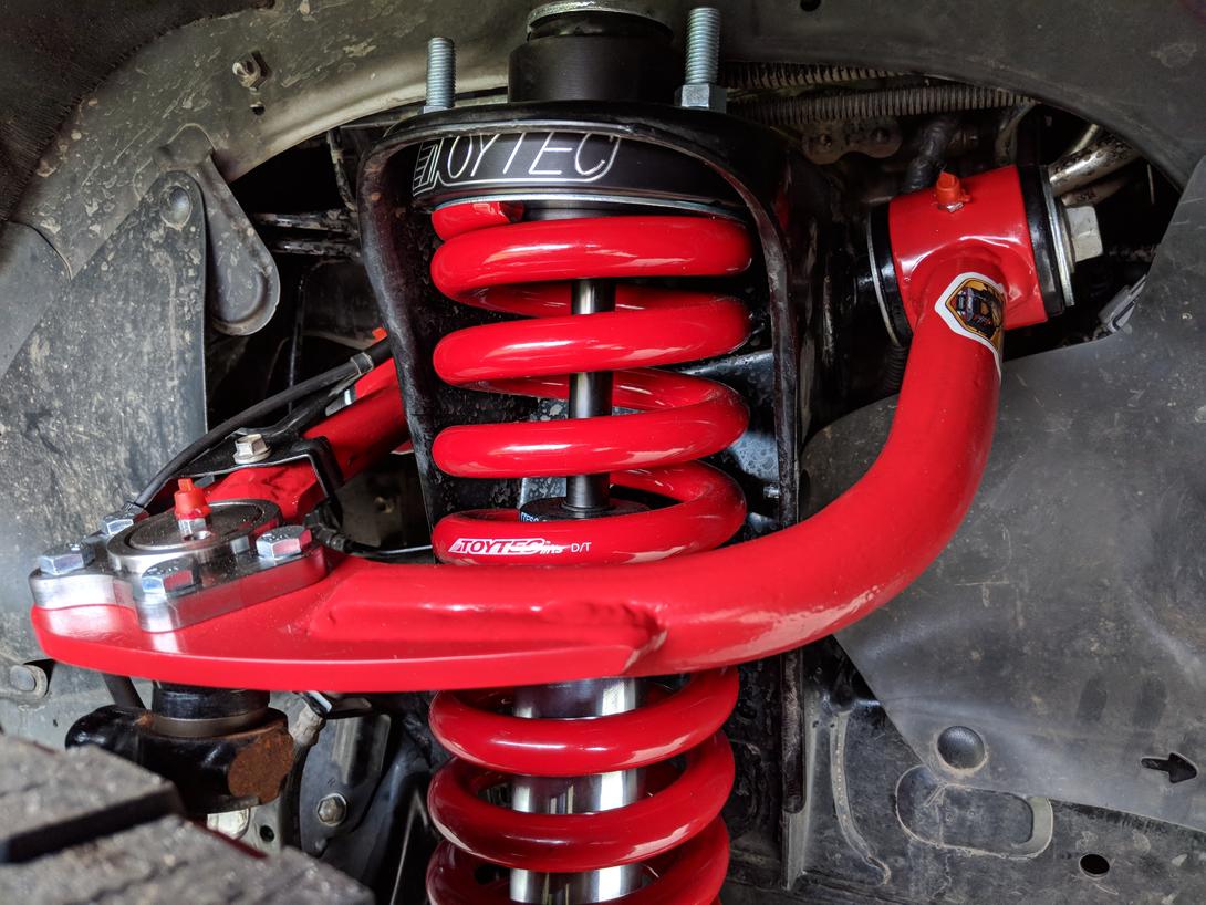

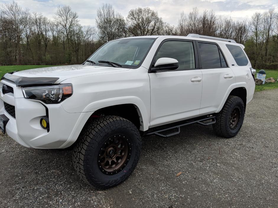

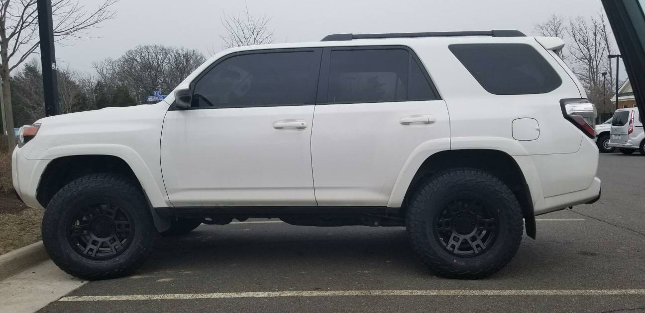

Finally Lifted!
Toytec BOSS 3" lift, JBA UCAs, 17 x 8.5 0 offset Vision Fury wheels, Cooper STT Pro 285/70/17

Just came back from the shop...had to push the fender liner in, trim the bumper, and remove the mud flaps in the front... tire is very close to the cab mount at full turn, maybe within a millimeter or two...The body roll and nosedive has been completely eliminated... It feels great on the road so far, definitely stiffer...was able to achieve 3.1 and 3.3 castor...
